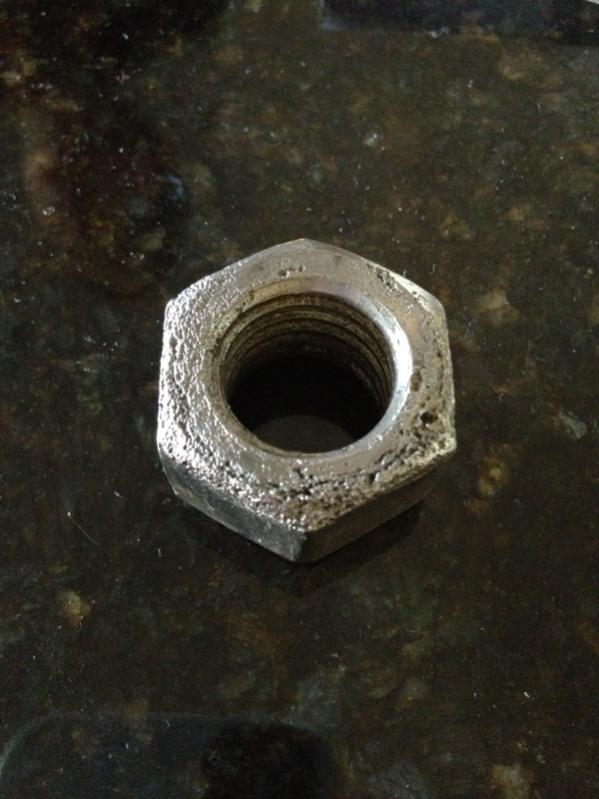

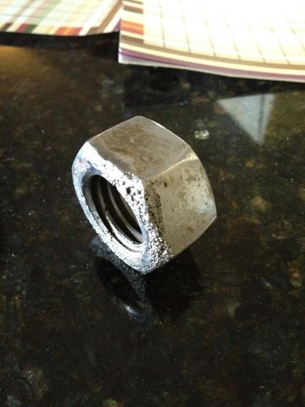

the pitted area was against the stainless washer... and there was a good bit of rust around it.

Rust is a form of electrolysis. In that area, the corrosion is likely a result of oxygen deprivation of the metal and if you have anything other than SS keel bolts, they would be similarly compromised.
the bolts are stainless.. i wonder how the oxygen left the water in the bilge.. my stuffing box had a consistent drip so it should have cycled water though the bilge every few days..

Can't tell you definitively if the corrosion is electrically induced, for example from bad bilge pump wiring, or passively because of oxygen deprivation. Keep in mind it's stain"less", not impervious.

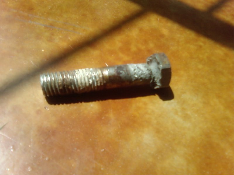

Crevice Corrosion
