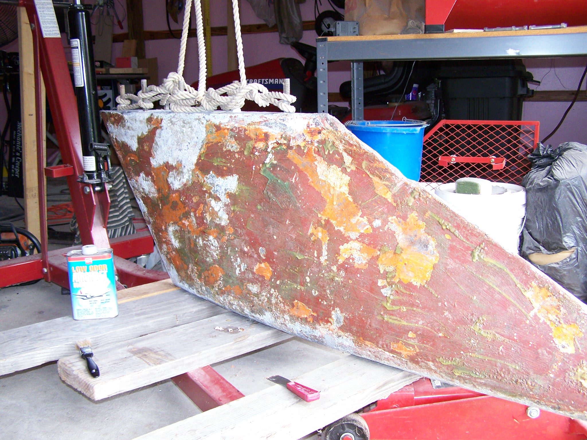

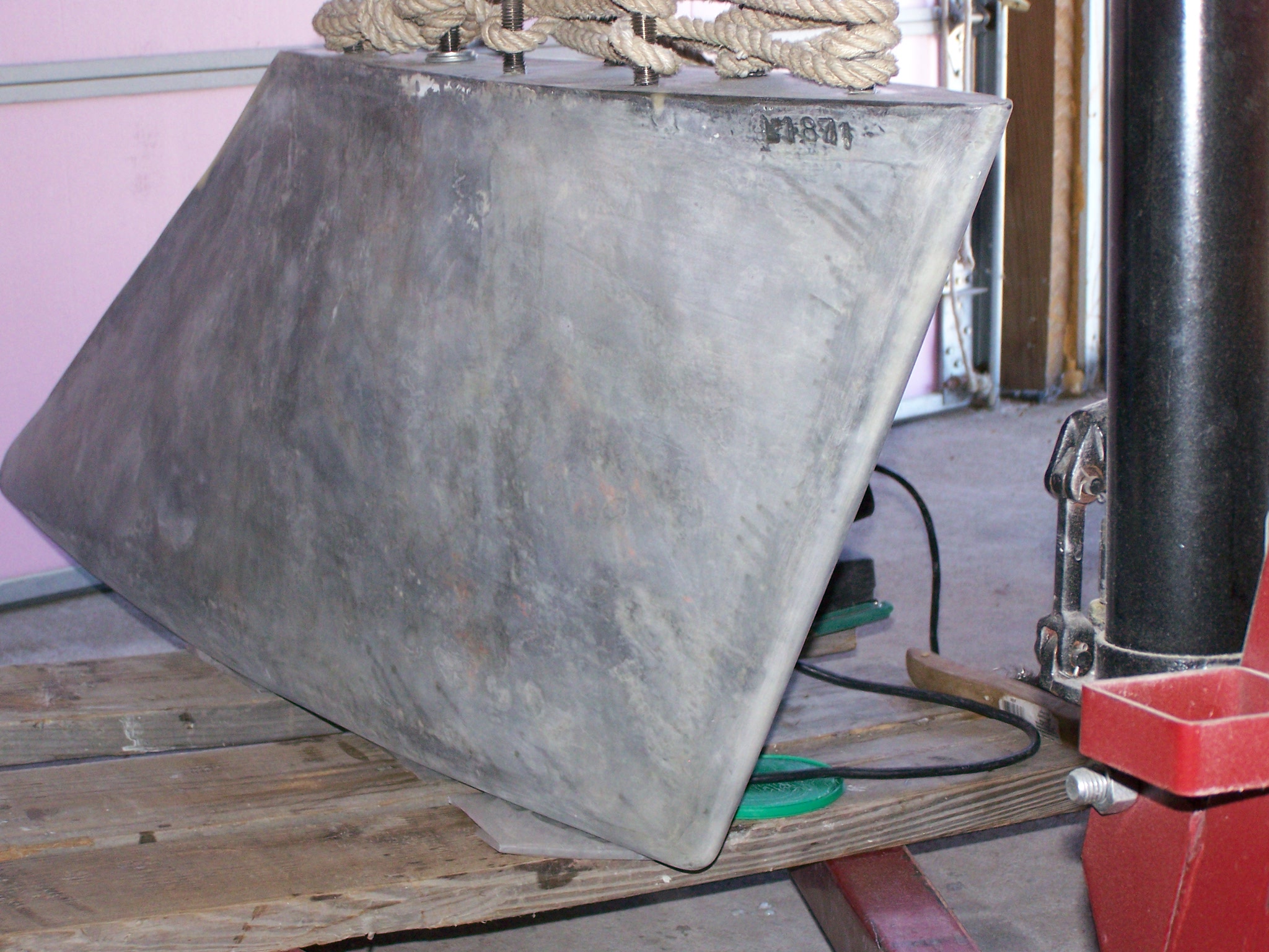

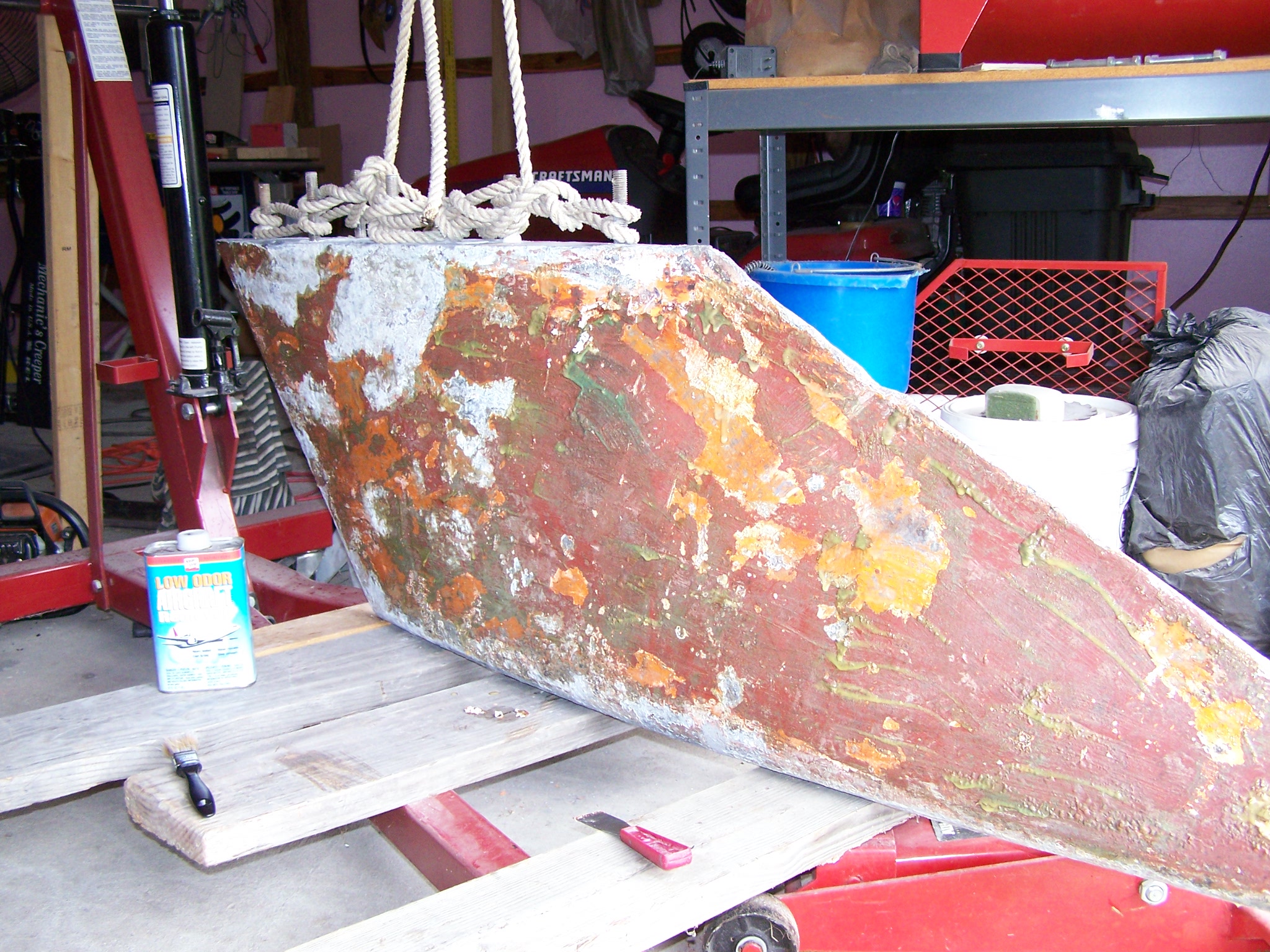

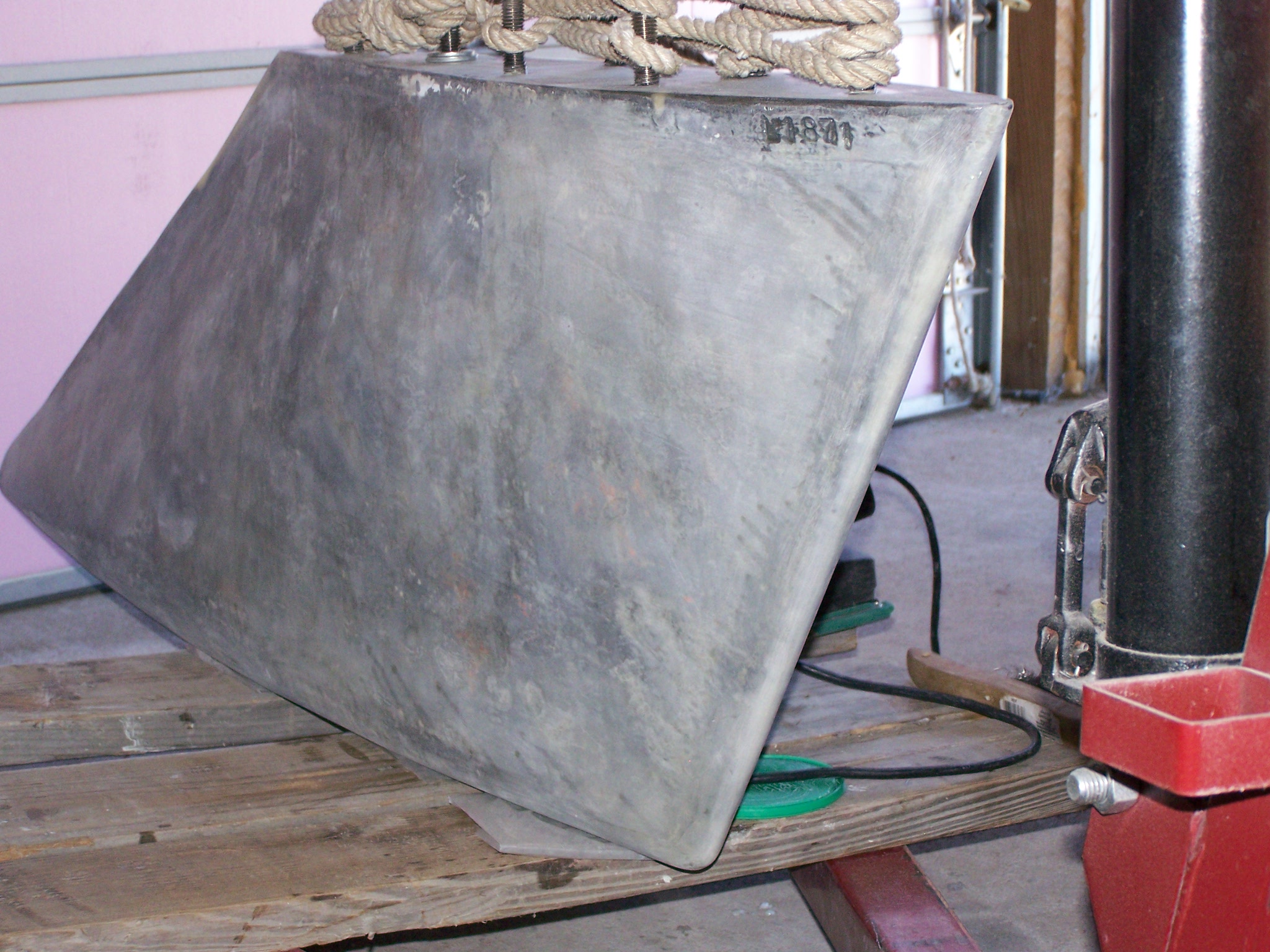

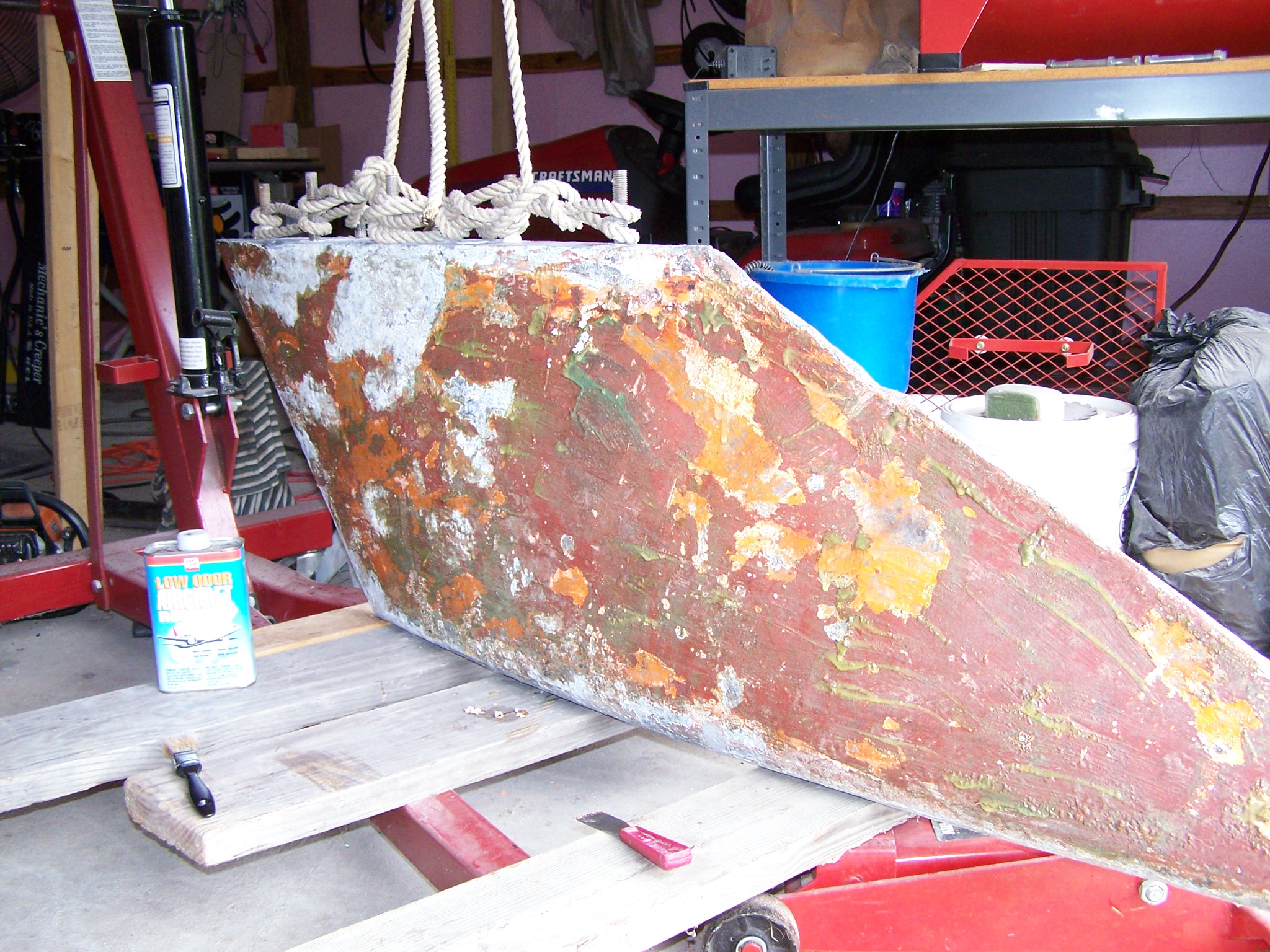

I have an '83 shoal draft Cherubini 25 I am rebuilding that has lead keel. When removing the keel, two of the all thread rods began to back out as there was 3M 5200 on the threads locking the nuts firmly. I removed the two all thread rods and checked for water intrusion and corrosion and then coated with epoxy and threaded back in. 100_0416.JPG 100_0145 keel.jpg

I don't know if most do or did or just "many" but yes the two that came out were just all thread stainless rod. But as a side note, the keel is only 1800+ lbs yet it has 7 bolts. Sturdy I would say.

The very problem with J bolts is that you can't remove them to inspect. If salt water leaks down into the threads you could have major corrosion going on below the surface and never know it. In theory you could have all the bolts rusted off below the surface while the tops looked fine. I prefer all thread rod. Since I had two that were compromised I elected to pull them and check. Since they were fine I trusted that the others were also. No way to know without pulling them all. However, the sealant had not been compromised so I deem them OK.

And finally, I doubt the rods are bored, tapped, and threaded in. They were probably molded into the molten lead to insure 100% thread engagement.

I agree. They probably had a jig on the mold to hold the rods vertical and keep in place with maybe a little grinding to the top surface afterwards. Did the top surface looked machined?

Hard to tell (or remember) as I had to scrape all the old 5200 off and level the edge damage from me prying the keel loose with wedges to break the 5200 bond.
