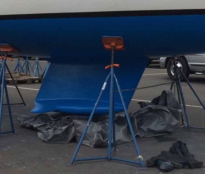

Those fins on my iron bulb keel look vulnerable. How often do you suppose they get broken off?
