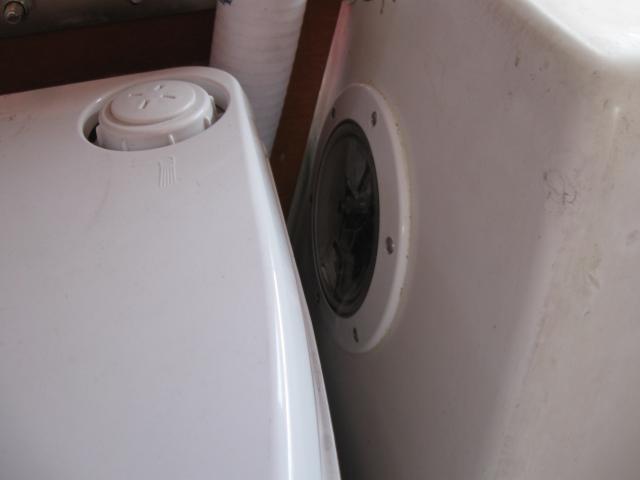

No hole in the hull or the liner? You are supposed to reach around from under the seat area. I put a 4" deckplate on either side of mine in the liner for access.

There is one hole on the starboard side of the interior tub, just below the mast strut. That's not for your keel locking bolt, but if you shine a flashlight down inside there, you'll see the hole the locking bolt comes through.
Like Timo said, you can reach in through the aperture in the forward starboard seat and put your hand on the locking bolt, or hole if that's all's there.
On my '78 M22, when I put a flashlight in there with the keel up, I can then look in through the factory-made hole on the port side of the tub and see light coming through. I'd think you should be able to do the same.

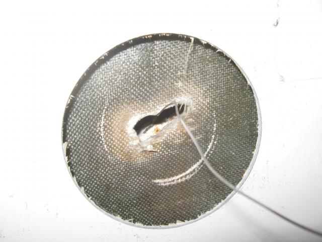

Mine had a slot worn both directions, mostly forward, when I get on the other computer, I will post some pics of the damage and repair.

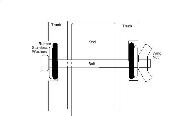

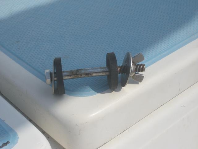

I've written about this before but I will repeat it because I think it is important. On my Mac 25 boat the keel trunk fiberglass is counter sunk to accommodate a large fender washer and rubber seals. When tightened the lateral load is distributed over the large leading edge of the washers. This will prevent the bolt from slicing through the fiberglass. If the bolt is put in place without locking it down it will easily cut through the fiberglass since there is very little to support it.
Here is a diagram of what I am talking about and a picture of the actual bolt.

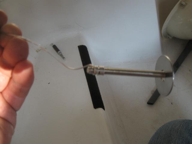

I embedded ss fender washers in the glass and epoxy patch, which is twice as thick as the original hull, I also put epoxy on the washer in the picture of the bolt with the wire that I fed from the outside to back up the hole for patching. Haven't crawled under yet to see if they are still there, they were mostly used to hold the filler in place, but I figured that if they stuck, they would tighten up the keel a bit. I can take a couple of shots of the finished job this weekend after it cools off a bit.

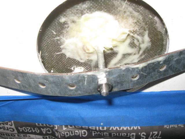

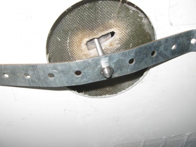

Here's som pix of the keel bolt hole repair.
Yup. Think I'll be doing my repair like that. IMOHO, the SS fender washers epoxy-glassed to the keel trunk can only make that area as strong as it probably should have been from the start. Cheap insurance against future failure is always within my budget.
