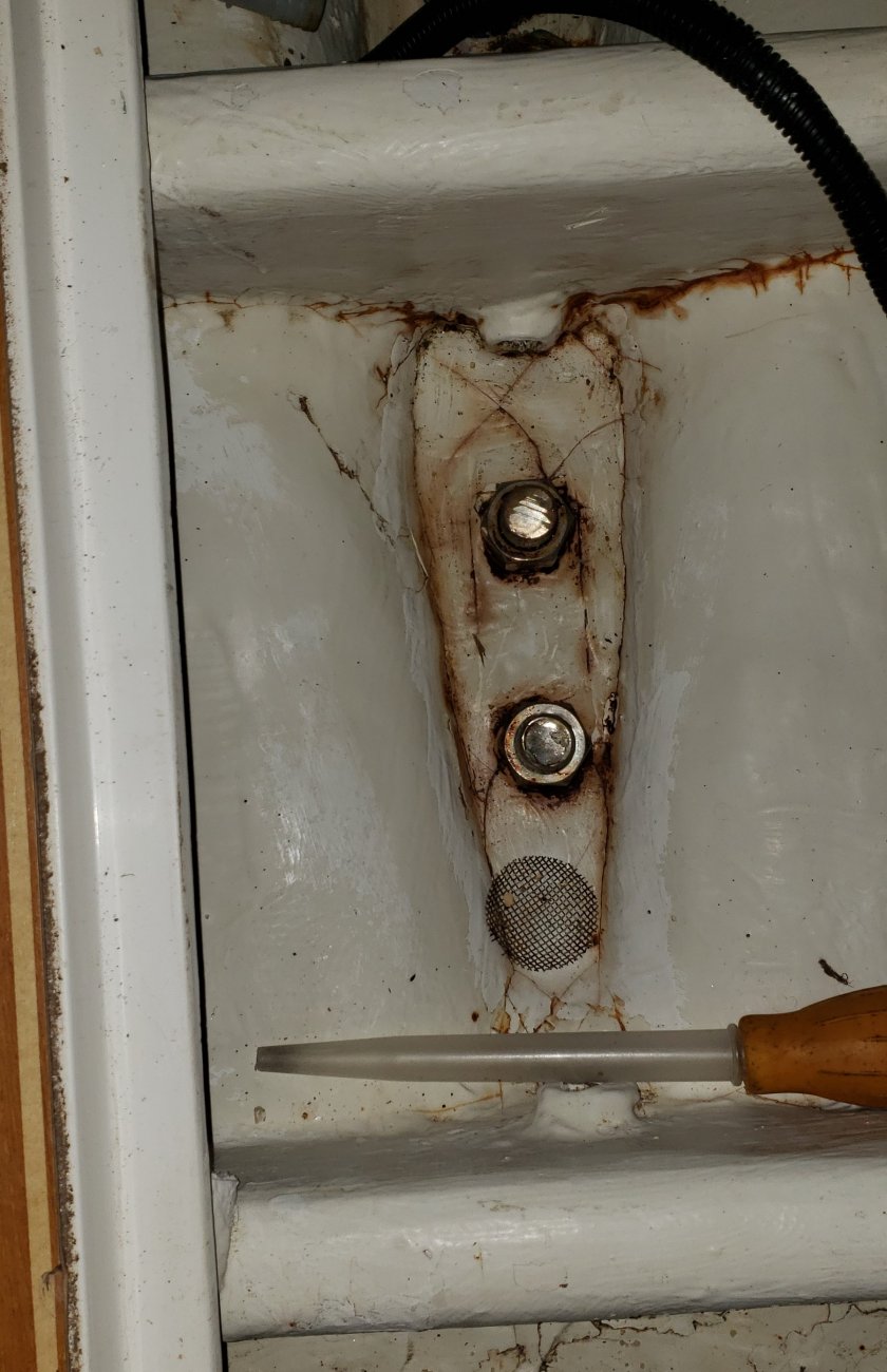

Show how do you check if you think your keel is leaking into the bilge?
What would you look for to suggest it was leaking ?
Has any Catalina 310 had this problem ?

If you have salt water in your bilge...I would be thinking leak. But it may not be the hull/keel joint. Did you run aground?
Other sources of water can be deck leaks (fresh water normally), or things like stuffing box, thru hulls, etc (salt water...assuming you are sitting in salt water).

if you have to resources to take boat out of water, let it sit for a couple hours while hull dry's, then pout water in bildge and see if it leaks from the inside out. Maybe not have same head pressure against outside of hull while i water, but we are only talking probaly at most, 2-3 psi, or 54" - 61 " H20... Very easy do do
May 24, 2004
7,226
CC 30 South Florida

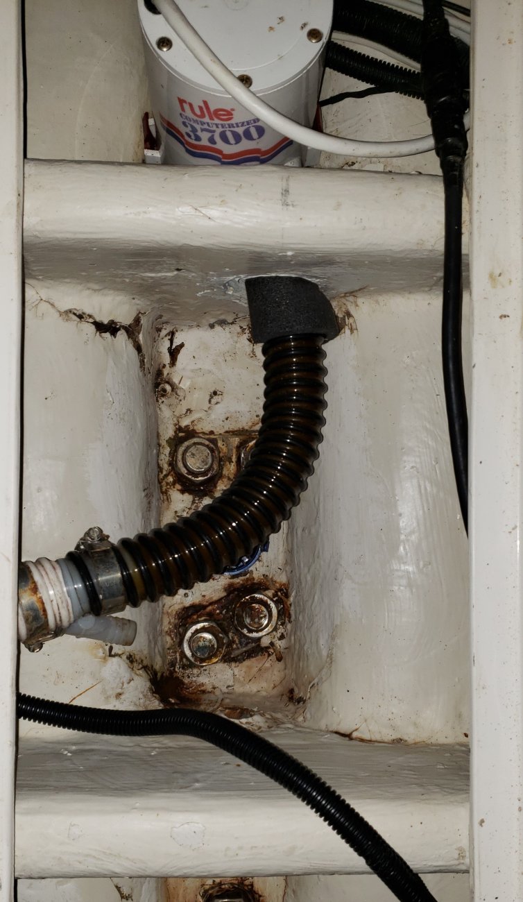

Check and see if any of the keel bolts is loose. Plug any drains into the compartment, dry it up and wait to see if you get any water. If all bolts are tight and no water is leaking then it should be a normal discharge from the water trapped in the stringers. Sorry to inform you but your boat will have many gallons of water trapped in the stringers below the sole and this water gets dislodged with boat heel and motion and will flow to lower compartments. Unless you had a hard grounding recently I would not worry about the keel to hull joint. If in doubt dive under the boat and visually look for rust spots and cracks. Your water might be a little cold but that is what we do in Florida. Check the rate of flow, if it is something you can live with have it checked when the opportunity arises.
