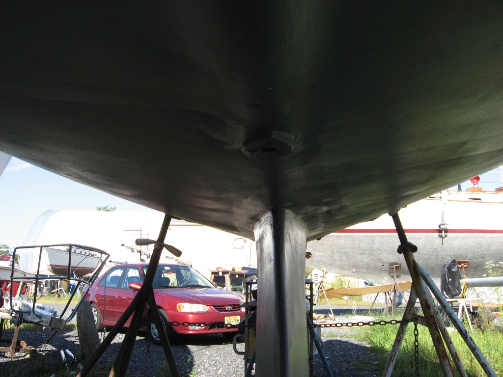

This 'smile' is very common with cheaper production boats having fin keels. I have it too on my H25.
I had to reset the whole hull/keel joint as the PO had attempted to do it and used wood-boat caulk (I expect he stepped into the boat-supplies place and said, 'I need *CAULK*', 'cause that's what he got) so the whole thing was leaking and, voila! - nearly-free boat. I used 2-1/2 tubes of 5200 (even cut open the tubes and scooped out the 1/3 that you don't get from using a caulking-cartridge gun). Afterwards I made the mistake of using rigid fairing compound (epoxy-based). This looked beautiful at first (see pic) but proceeded to crack again and again.
The best solution is a flexible seal of 5200. Grind out this crack to like a 1/4"-3/8" groove, clean with acetone, and trowel in 5200. Then paint over it. That's it. This is industry-wide practice and, I assure you, any further contemplation about it is pointless. You will never get a perfectly-smooth transition here unless you're willing to remove and redo it every season, such as on a racing boat. The physical parameters of the inherent stresses on the hull-keel structure are against you .
