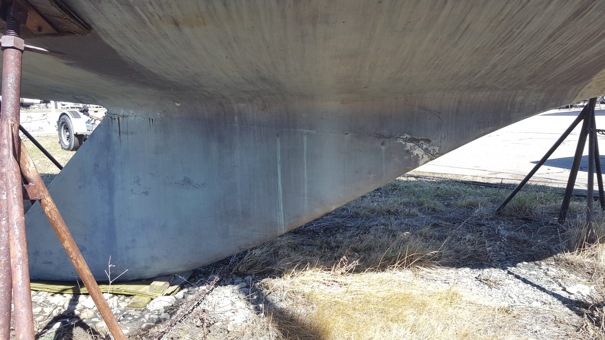

I am looking at a 1972 C&C 30 MK1 and it seems the casting line on the lead keel looks like it is separating has anybody else seen this? is it something to worry about? is it fixable?
7,571
Don't panic. But there's an issue. It's been gooped to death. My concern is that there may have been a hard grounding. So you need to look at other places in the boat. Particularly the tabbing through out the cabin. And look at the aft end of the keel on the hull and see if there is damage (Or repair) to the hull there. Many times with a hard grounding the aft part of the keel is driven up and damages the hull. It's fixable but at your expense and you may not pass the insurance survey. Another concern is that the gap between the stub and the keel is uneven. If it were an even gap it would maybe just need resealing. Uneven gap poses question.
23,127
Agree with @shemandr about grounding as possible cause. More inspection is needed.
Step back and look at overall shape and symmetry of the hull and keel. This should give you indication as to places to explore on the hull interior for damage.
Driving a boat hard against a rock or sand bar will pull the forward section of the keel down away from the hull and force the aft section of the keel up and into the hull. If bolt on keel damage could be evident in the bilge. Water intrusion would be bad.
Note this damage could also be from mishandling in the yard when the boat was being moved or blocked for winter storage.

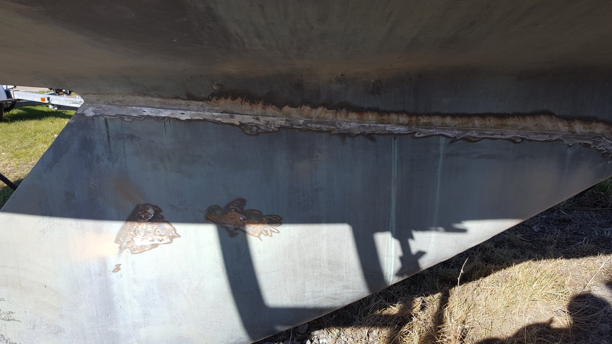

Well that was part of the problem, I took the one nut off one handed, that's how lose they where. Here is a pic before I ground out the joint.
Jan 10, 2018
264
Beneteau 331 Halifax
If you go to the C&Cphotoalbum.com that is the place for C&C owners. In the technical info section, there is a file with all the keel bolt torque specs. You will have to ask if you can just tighten them when on the hard....there may be a special technique. You should put in one reef when you get to a little over 15 knots, and she'll sail very well.

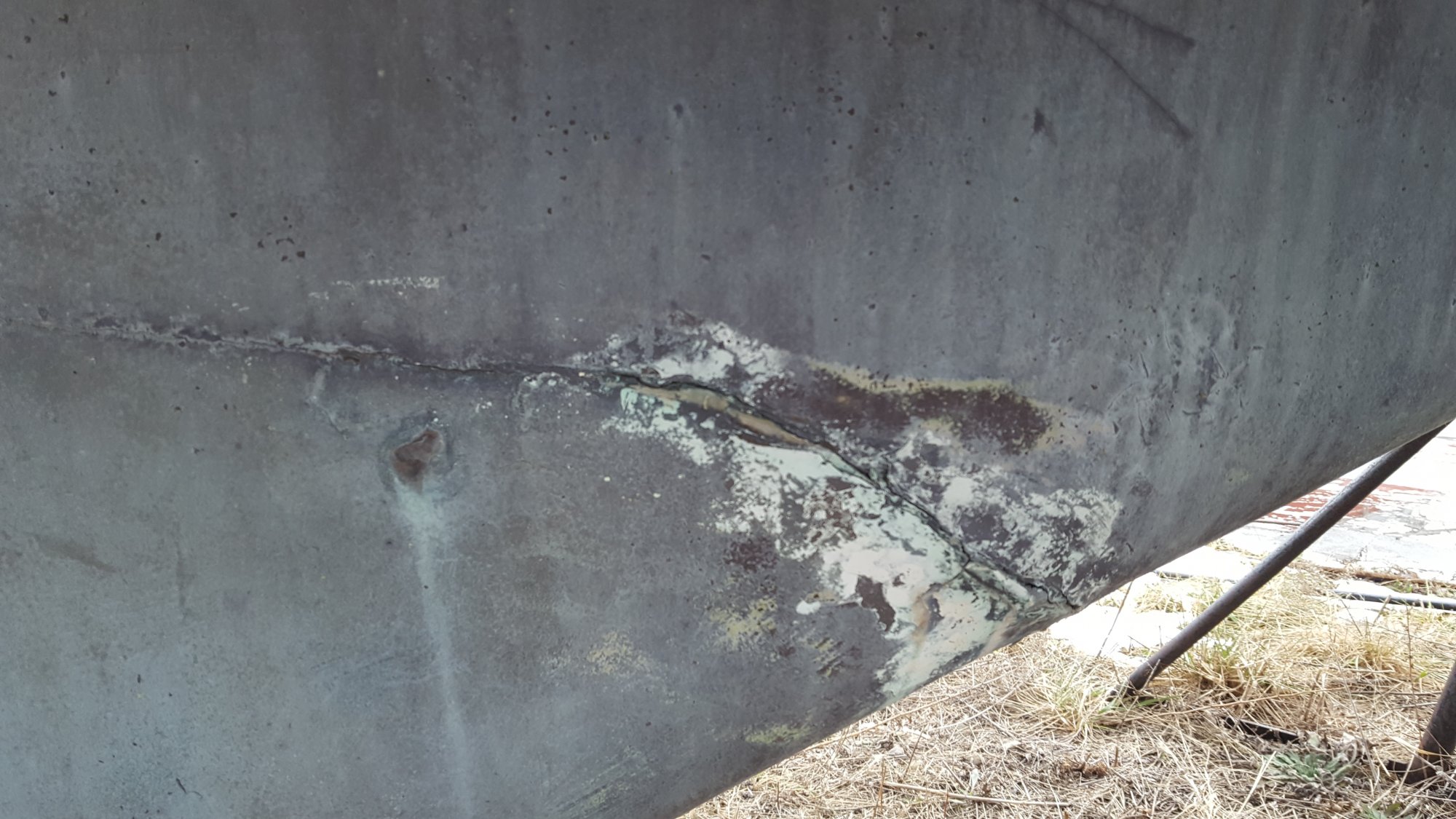

I have been on that website quite a bit lately, the first step is to replace the steel washers that are under the nuts, once those are replaced then you can retorque the bolts I believe they are 350 ft lbs, then fair out the area with G-flex epoxy. Here is a pic with it ground out I still have to remove the compound between the keel and hull.
DArcy
Feb 11, 2017
1,769
Islander Freeport 36 Ottawa
Yup, that's the C&C smile. I had a 1974 C&C 27 for 20 years and I am familiar with it. If you could remove the nut by hand it was REALLY under torqued and I'm sure that contributed to the crack you are seeing but even with proper torque it will still happen. I torqued my keel bolts every spring after launch and still the smile came back. G-flex seems to be the popular repair material. Peel out as much of the previous repair material as you can, fill with G-flex. Since you are removing and replacing the nuts you will need to torque them on land but check them again after launch. I'm not sure if you should apply full torque on land or not.
Another issue that can contribute to loosening the keel bolts is the swept back keel C&C went with in the early boats. It looks fast but isn't really that fast. Unfortunately it can cause uneven loading on the bolts if you put too much load on the keel. You really should use a cradle that properly supports the hull and doesn't put the hull weight on the keel. The idea is to only have the keel support itself, which can be hard to do using jack stands. If not evenly loaded, the swept back keel can try to pry the keel away forward and put a lot of compression load on the aft end of the keel. The good news is the hulls were really overbuilt at the keel stump and can take a lot of abuse.
