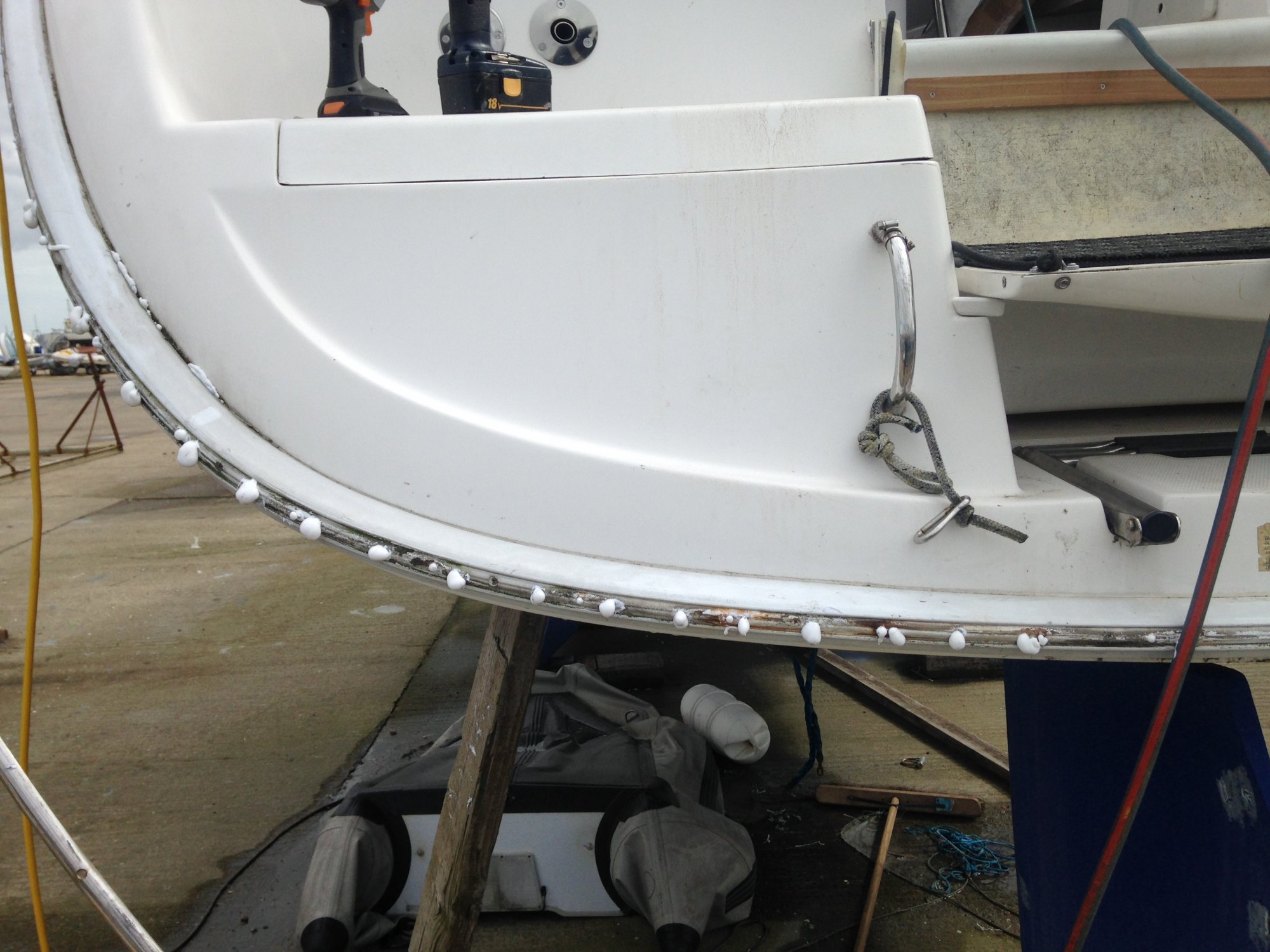

If it's to address leaks into the cabin via the hull joint.......I took off the SS capping strip, drilled 6mm holes at 40mm centers through the
capping and injected "gap filling silicone" to seal the joint.....completely successful. (It's worth using compressed air type caulking gun to get the required penetration)
