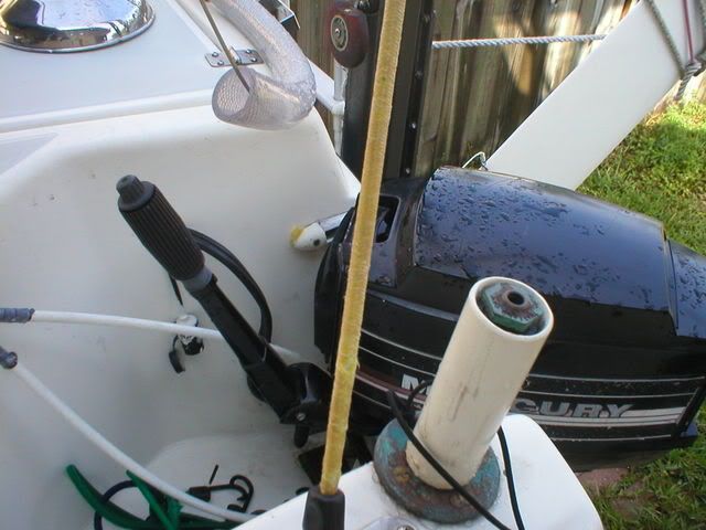

fwiw I added some cable and a lock to keep my OB from leaving the boat.. since its not thru bolted...
my motor safety:
http://i64.photobucket.com/albums/h169/ftldiver2/MACGREGOR/PB180012.jpg
http://i64.photobucket.com/albums/h169/ftldiver2/MACGREGOR/P1010014.jpg
