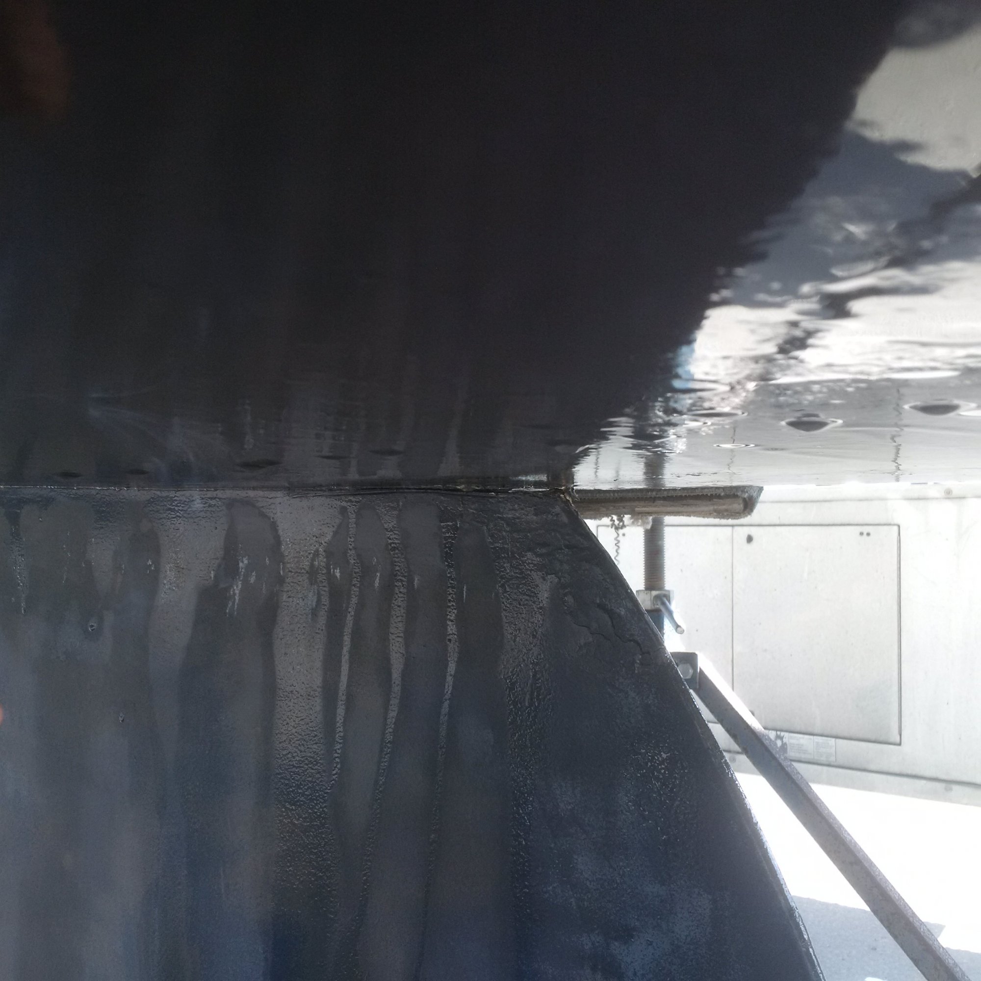

I've heard mention that this gap at the aft of the keel is "normal". I noticed it upon haul out this year on our 351. The boat is new to me as of 2017 and I did not notice, but also didn't look for, this gap last Fall. It compressed out of existence once the boat was placed in it's cradle, and I watched the hull flex to absorb the keel a bit and close the gap.
I have not - but will check my keel bolt torque values. Any suggestions on those would be appreciated.
My plan would be to have the yard lower the keel off it's blocks in the Spring to open the gap, and leave the boat in it's cradle. Then - I'll clean and prep the area and fill the gap with 3M 5200, allow at least a week to cure and launch the boat for the summer.
If there's a better approach, or if this gap suggests a more serious problem - any insight or advice would be most appreciated.
Thanks,
RK
