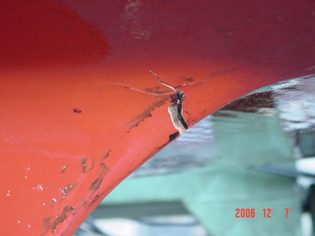

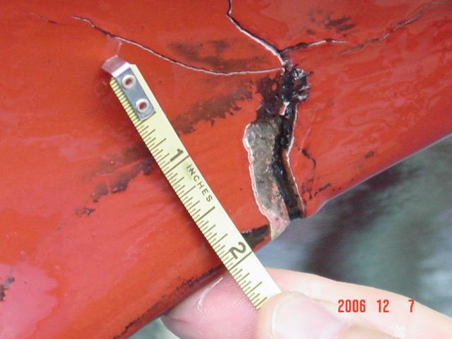

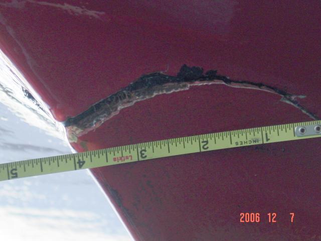

Our O'Day 37 Center Cockpit Sloop has always leaked water into the bilge from a 4" crack in the fillet at the aft of the keel (see pics). :cry:
We recently repaired the cause of the crack, a weak bulkhead above the fillet which let the keel move up/down 1-1/2"!!
I've ground out the poor repair jobs on the outside of the keel fillet and now need to repair it properly.
Any ideas what's the best way to repair/replace the fillet? Should I lay up multiple layers of glass/epoxy to build it up OR vacuum bag mold a new fillet that is then bonded to the hull/keel.
