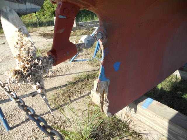

I am looking at buying a 1974 34' Tartan. Great boat, but the aft keel has been damaged. Apparently during a haul. The price is suspiciously low ($8k).
I am wondering how bad this damage is and what it would take to fix it. Could there be other, related structural damage on the boat I should look for? At this point, just a broad idea and a cost and time estimate would be much appreciated! Unfortunately, there is a little rush to making a decision.
This would be my first boat and I would want to sail it, not have it end up as a big project.
Thanks a lot in advance for candid advice!

If you can do the work youself it will take about 200 dollars for materials and sundries presuming you have a box full of power tools. If you hire it done probably somewhere around 3K.
My guess is that the boat pounded the keel against a hard bottom. If it happened in the water it probably flooded the boat. If it happened on land somebody probably dropped it. Take a hard look inside for broken tabbing and water stains .

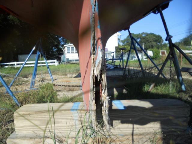

Anytime you breach the fiberglass surrounding an 'encapsulated' keel and especially if the ballast is iron, or a mix of iron 'punchings' and cement, etc. ... not lead .... there is always the possibility of the development of RUST of the ballast. When such rust begins to form inside an 'encapsulation' the resultant iron oxide (ferric rust) is much less dense than the base metal and thus can develop extreme internal pressure to the encapsulation ... therefore always the risk in future that the ballast may eventually 'force itself' out of the boat by the extreme developed pressure.
So, that the encapsulation is evidently/possibly 'breached', that is a strong possibility of the already development of rust of/in the internal ballast, without the SPECIFIC investigation by a "Tartan Knowledgeable" surveyor including possible 'test borings' into the ballast .... should encourage one to RUN away.
That stated, I'd contact a long term Tartan dealer or Tartan (new ownership) with the specific HIN number first to ascertain if the ballast is actually lead .... or actually iron ... or composite of iron plus 'unknown something else'. If lead, then no problem with most repairs; if NOT lead then 'caveat emptor'. Most encapsulated iron ballasted boats (with unknown time for water penetration and 'rusting') with such damage ... usually 'go to the grinder, thence to a landfill'.

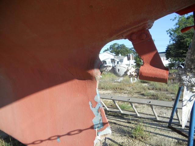

The repair is relatively minor. Tartan 34's have sailed all over the world. get a fiberglass repair man to look at it and give you an estimate. That boat has a keel/centerboard configuration. All the lead is up front and is an outside solid piece. The damage is to the rear of the centerboard trunk and is not structural. It can be fixed and you'll have a boat that looks beautiful in the water and has a rating under PHRF of 174. Not fast but not slow either. Good seakeeping. Check the motor. Some came with an Atomic 4 gas engine and might need overhaul or replacement. That is if you are still interested.

Looks like a diesel, which is good if it work. The keel is easy to repair. Non-structural, just fairing. Inside looks ok. Doesn't look like it has been under water. Pretty good price for a 34 footer.

Remember that it is not encapsulated. It is a one piece bolted up front. You should be able to see the connection between the lead ballast and the keel. Again, Google the Tartan 34 and see for yourself the configuration. Or go to the owners group and discuss this with them.

Like most Tartan K/CB designs, I believe, the 'ballast' (4800 lb.m)is carried low in the centerboard TRUNK (sides of the 'keel'). The centerboard is weighted FRG with just enough weight/mass for it to 'drop'. Most assuredly the centerboard does not weigh 4800 lb.m. in a Tartan 34.
