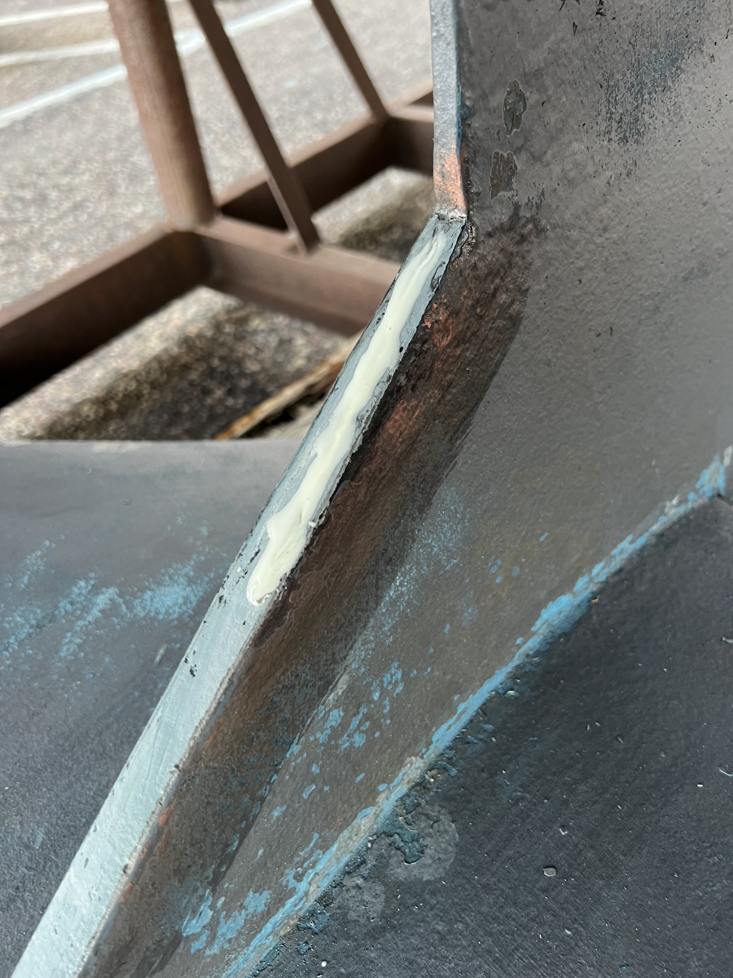

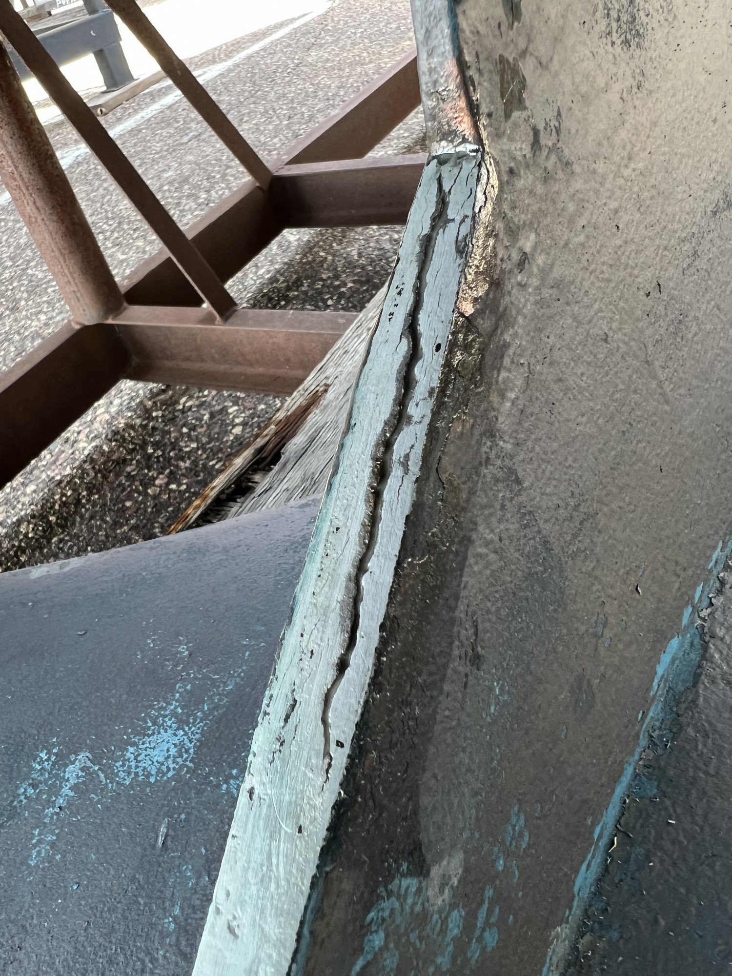

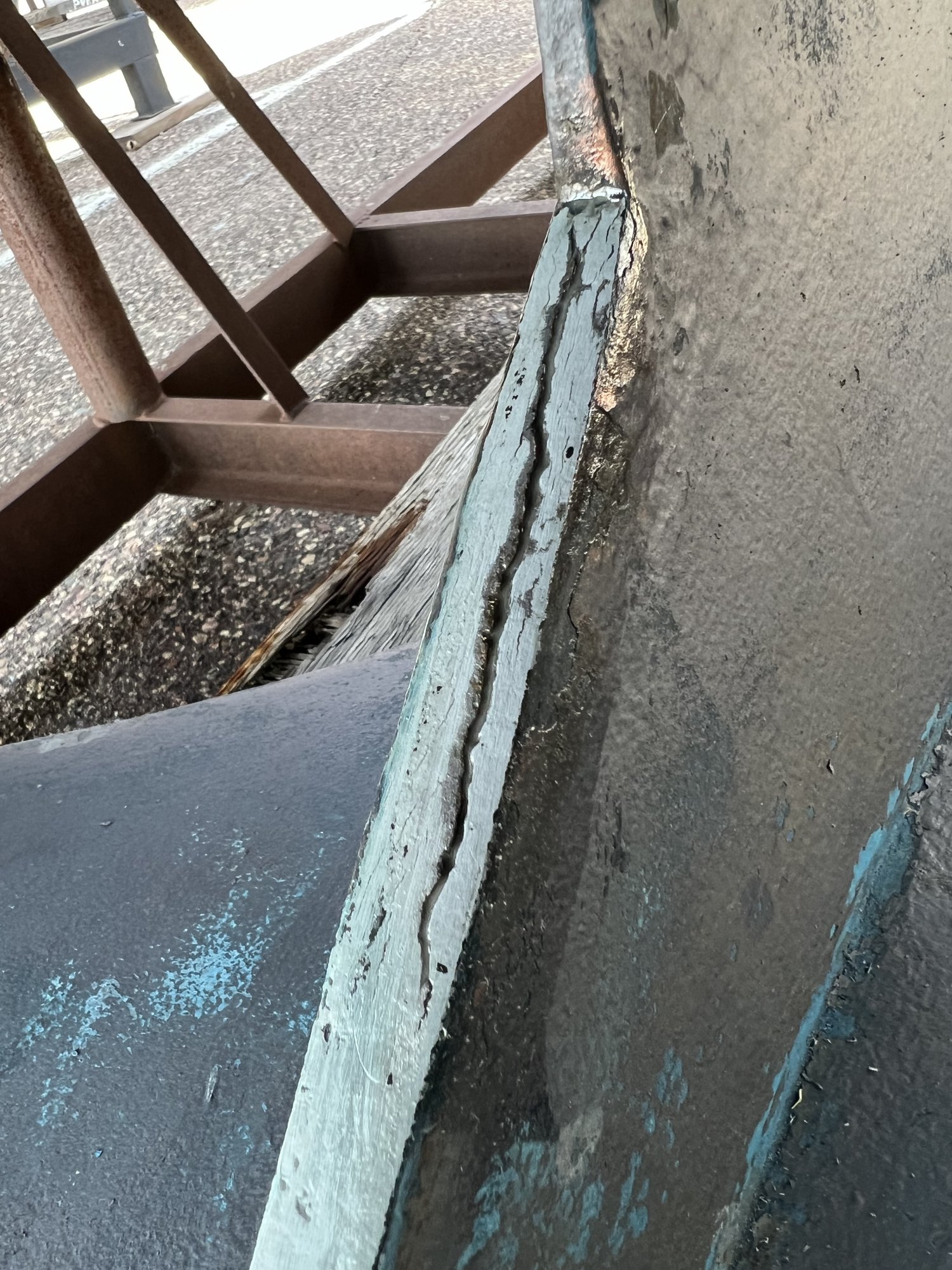

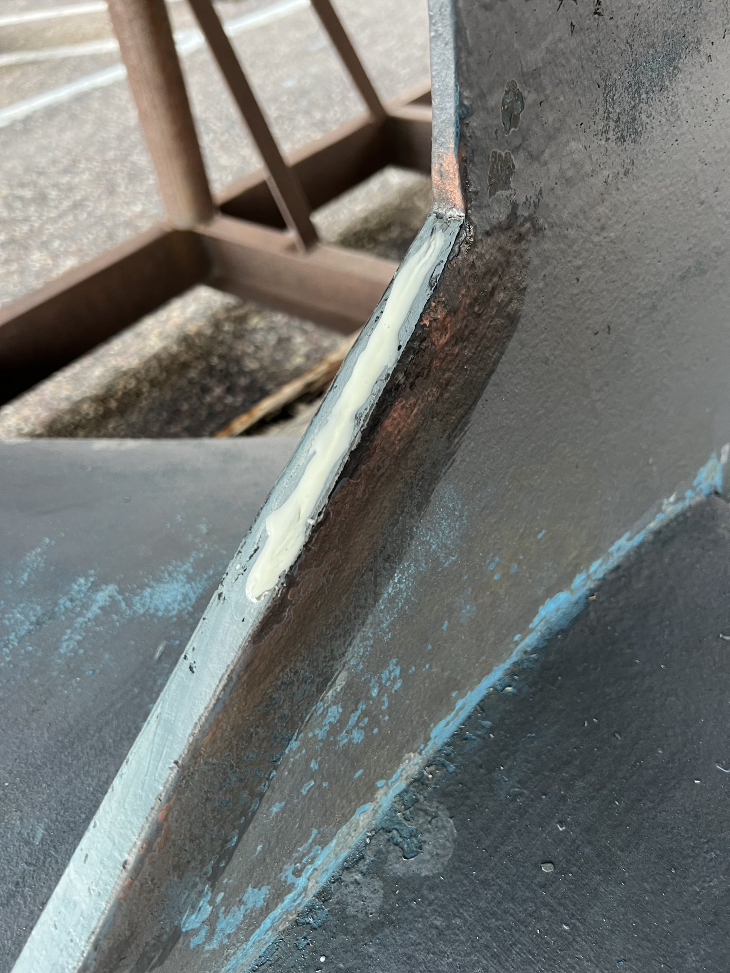

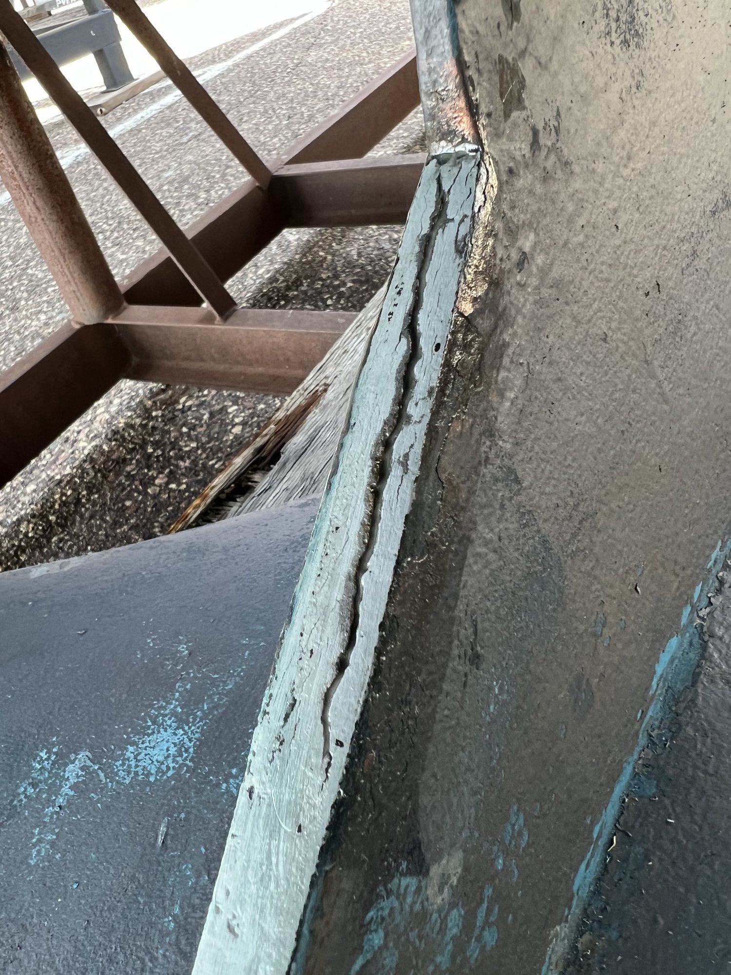

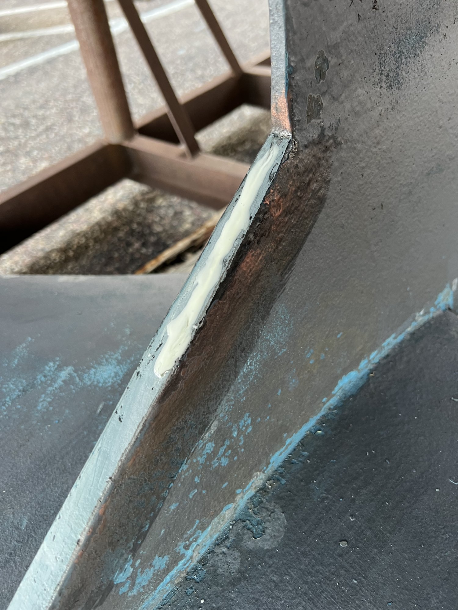

Just a follow up on this. It was easy enough just to scrape away the paint in the spine of the fin and then wire brushed to reveal a long crack. I was surprised by how soft it felt. Seemed like I could wire brush away the whole keel with a little more time. Anyway, then I wire brushed some neat epoxy into the crack, followed by thickened epoxy. Now I just need to clean it up and paint.

As your H306 brother-in-arms, I think you did exactly the right thing. Don't over-think it, paint it, launch, and enjoy your boat.
