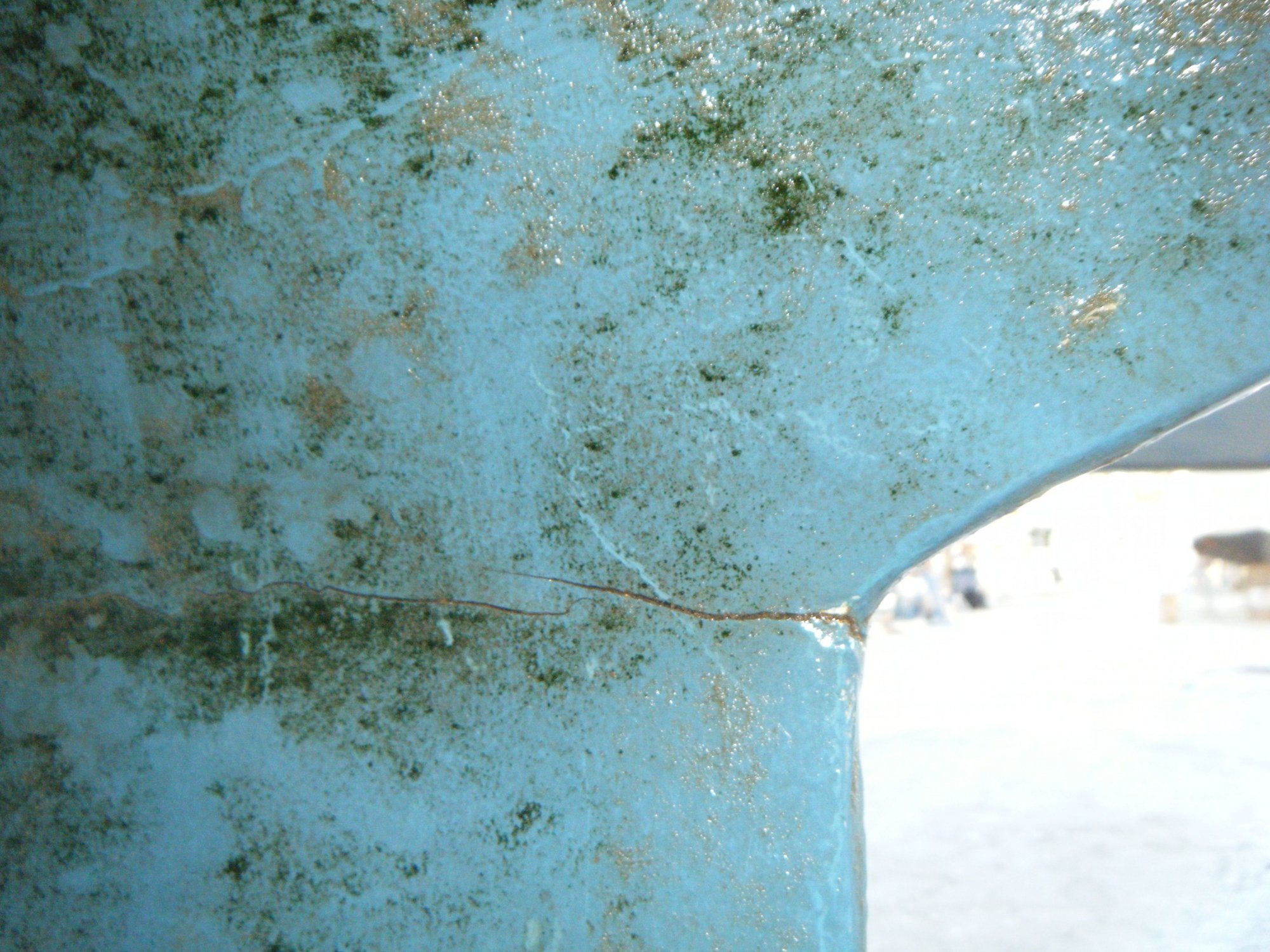

I just got the survey on a Hunter Legend 40.5 and it states "Some bonding terminals/connections have corrosion, inspect and service the entire bonding system. The keel to hull joint has a small crack aft, clean and keep dry, adjust keel bolts. Service the entire bonding system, some corrosion on the wiring terminals." This is the only issue with Geico Marine insurance and it states it needs to be repaired to be insured. So, asking for guidance. Is this something to walk away from and say no deal? How much would a repair like this cost? Do they have to drop the keel to fix this?
Sep 25, 2008
7,752
Alden 50 Sarasota, Florida

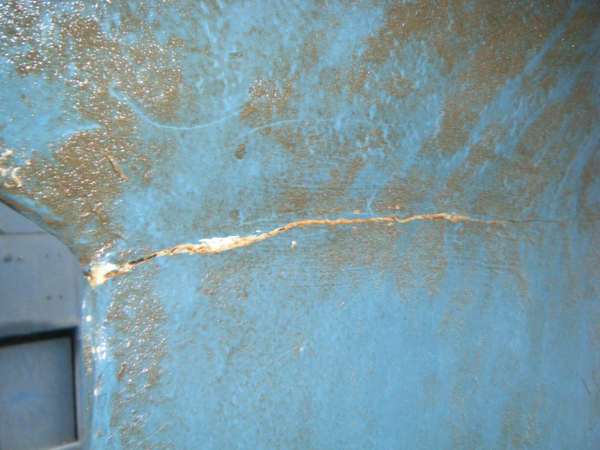

Simple matter to torque keel bolts to ensure integrity and clean bonding connection. The 40.5 has a stub keel so a picture of where the crack is would help.

Upon seeing the images, my first impression is the keel struck something. If it is on the stern en of the keel, I would inspect the stern bottom of the keel for damage. I would look inside in the keel well at the bow end for compression damage. Keel bolts that are loose might also provide information. Think about the physical action that occurs when the keel hits a rock and how it moves trying to stop the movement of the boat. It is like a teeter-totter with one end moving one way and the other moving in the opposite direction. The end attached to the boat compresses the fiberglass. The boat absorbs the force and stops. Stress cracks remain.

Nine times out of ten it’s a stress crack. Correctly done, the keel is attached by the factory using 5200. One prime attribute of 5200 is that it is phenomenally strong as an adhesive (the 5200 holds the keel on. The bolts just hold it till the 5200 cures. I know this from first-hand experience).
Another attribute is that 5200 stays flexible. Since this therefore will always a flexible joint, any attempts (like I made on mine) to trowel hard fairing compound over it will result in hairline cracks that grow bigger. This is fondly referred to as ‘the Hunter smile’. It’s a fact of life.
The best treatment is to take your Dremel with the little stone half-football and to grind that crack into a very fair groove maybe 3/16” wide and 1/8” deep around the whole keel/hull joint. This is not like chasing cracks in the deck or topsides. It’s a real seam and you will not see the end of it. Just make room for 5200.
Chemically and physically clean this with a small wire brush and then acetone like the lives of everyone you know depend on it. Go inside and do a ‘final’ keelbolt adjustment (NO MACHINES. As with anything involving 5200, go to your first grunt when using your 8” ratchet wrench. Then YOU ARE DONE).
Go back outside and apply a nice neat bead of 5200 into the clean groove. It’s okay to push it in with your finger. It’s okay to have it stand a little proud after - actually best if you do.
Wait a full week or more (note I did NOT say ‘use Fast Cure’). Then when you apply bottom paint DO NOT use a wire brush on the bead. DO NOT sand it. And DO NOT wipe with alcohol (Achilles heel of 5200). Just blot with acetone and paint it.
In future, examine it every season. If it’s falling out you didn’t clean it well enough. You’ll have to re--do THE WHOLE THING.

I wish I had read your post before today. I do believe you are correct, it was a stress crack since it is 2.5 feet above where the bolts are located, but since the survey said adjust the bolts, that is what insurance wanted and when the yard went to do so, they sheared the bolt off
