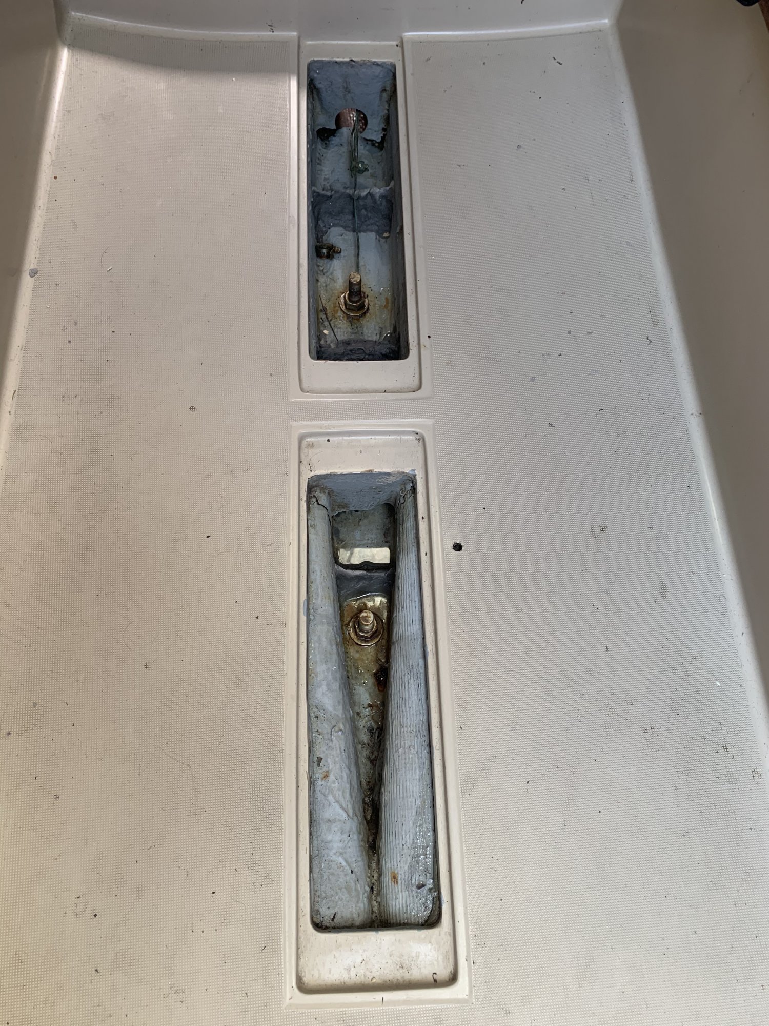

I am getting about a cup of water a day into my bilge. Eliminating all leak scenarios the conclusion is that the keel bolts have loosened. I am getting many explanations on what to do next. I had keel bolts tightened and painted 6 years ago and have sailed fairly regularly over those years.
1. tighten keel bolts while it sits in water
2. haul out and tighten keel bolts with possible patching/fabric glass/new paint
3. haul out, de-keel, re-do,go bankrupt
Any experience with this anyone?

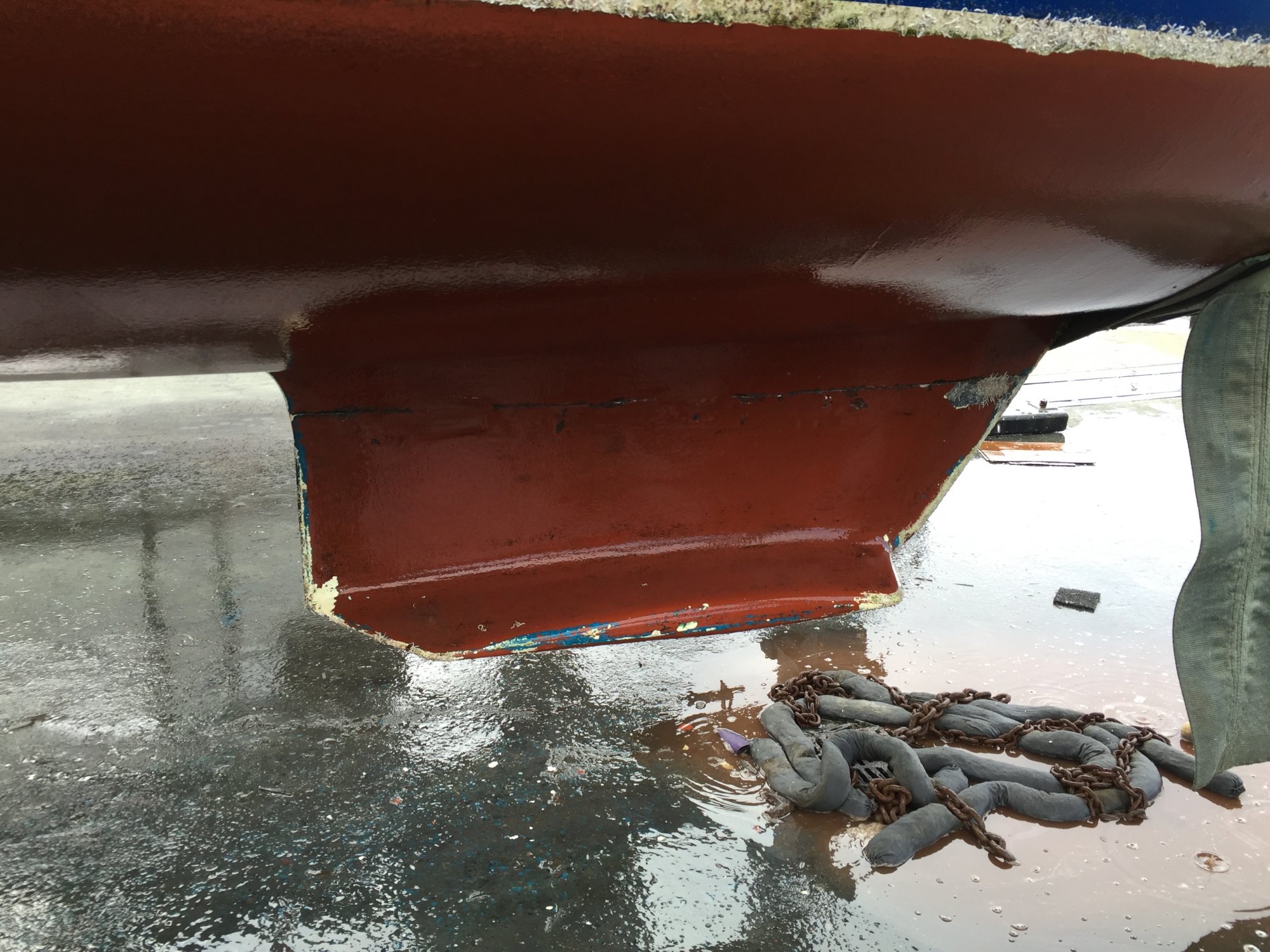

picture one is current bilge/keel bolts

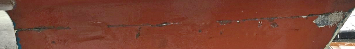

picture two is haul out 6 years ago with a known crack around keel/hull connection
The most important item here is : exactly what was done for repairs 6 years ago, right down to the sealant used in the crack.
good point.....I believe six years ago I only tightened keel bolts on the haul out and had a few coats of paint put on..

the shipyard told me that trying to tighten keel bolts while boat is still in water is worthless, but maybeI I will invest in torque wrench and proper socket and give it a spin
14,292
Keel bolts can be properly torqued only when the boat is hauled and the weight of the boat is on the keel.
If you try to tighten the keel bolts in the water the weight of the keel will give a false reading, as you will be trying to lift the weight of the keel as the bolt is tightened.
Once the boat is hauled and blocked, clean the bilge, loosen one bolt at a time and retorque to the manufacturer's specs using a good quality torque wrench. Don't waste money on some cheap piece of crap with dubious calibration.

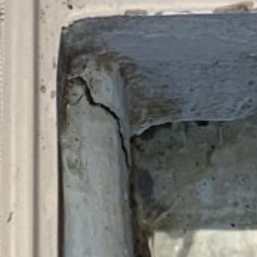

IMO you have a serious crack which will require serious remediation.
At a minimum, I can see retorquing on the hard, grinding out the surface of the crack in a V, sealing, and then several coats of fiberglass. The one thing I can't see is how to get rid of the moisture around the bolts before you seal it up.
Any idea how much further this extends :

Eagle Eye @Ralph Johnstone has identified a potential problem. Notice the glass on the right side of the bilge is different from the left side. Also notice the the glass in the area Ralph identified is cracked on both sides and it looks like the glass was laid on top of the painted surface.
This makes me wonder if the boat was run hard aground as this is the kind of damage one would expect from the keel being jammed up in the back of the keel sump.
It is past time to haul the boat and more fully evaluate the hull, the keel joint and the keel for evidence of grounding an a poor repair.
