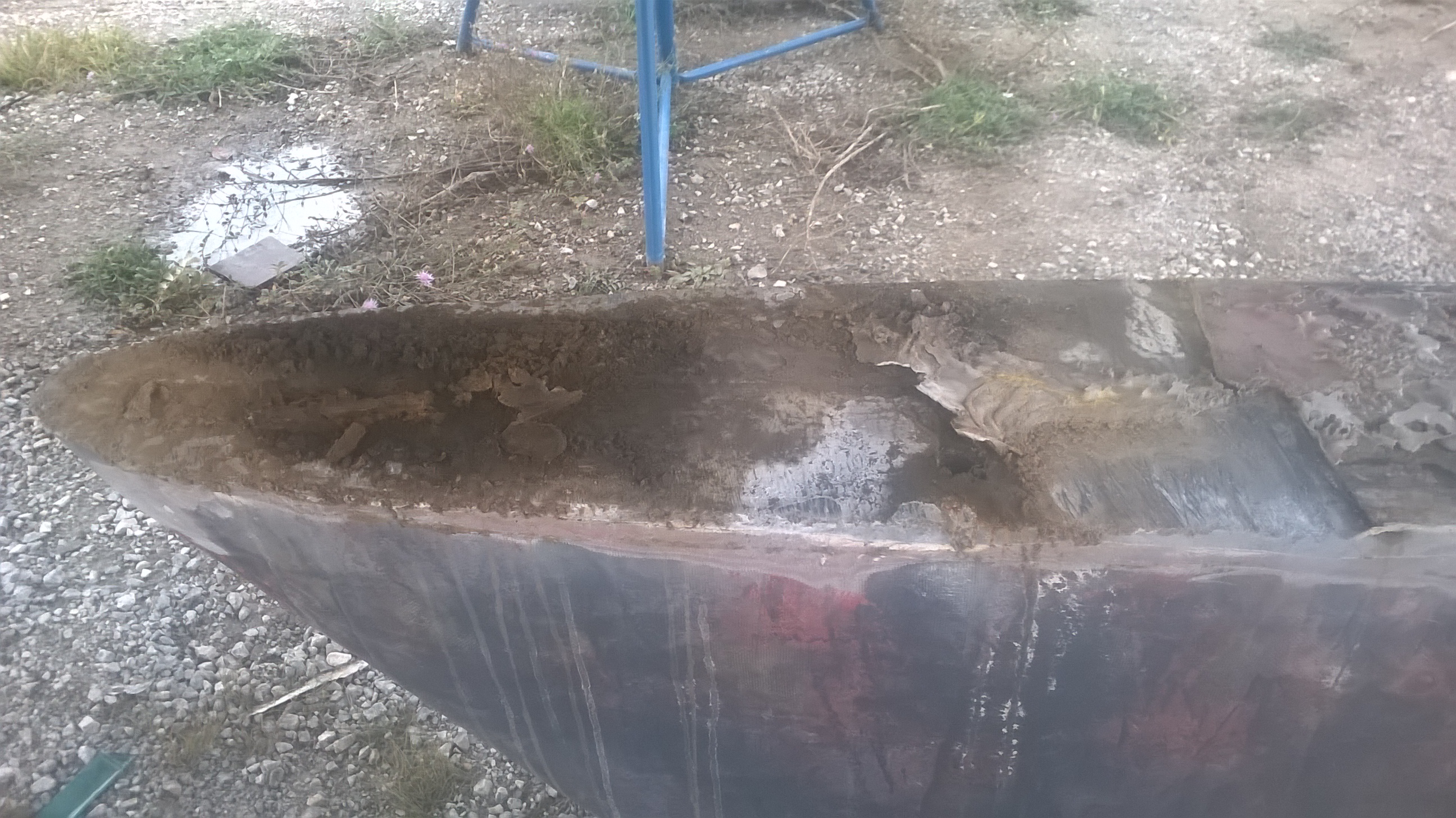

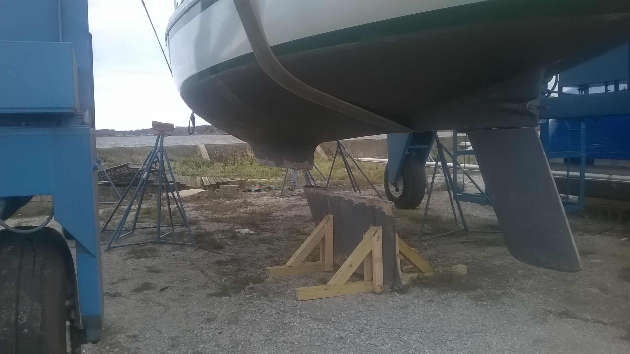

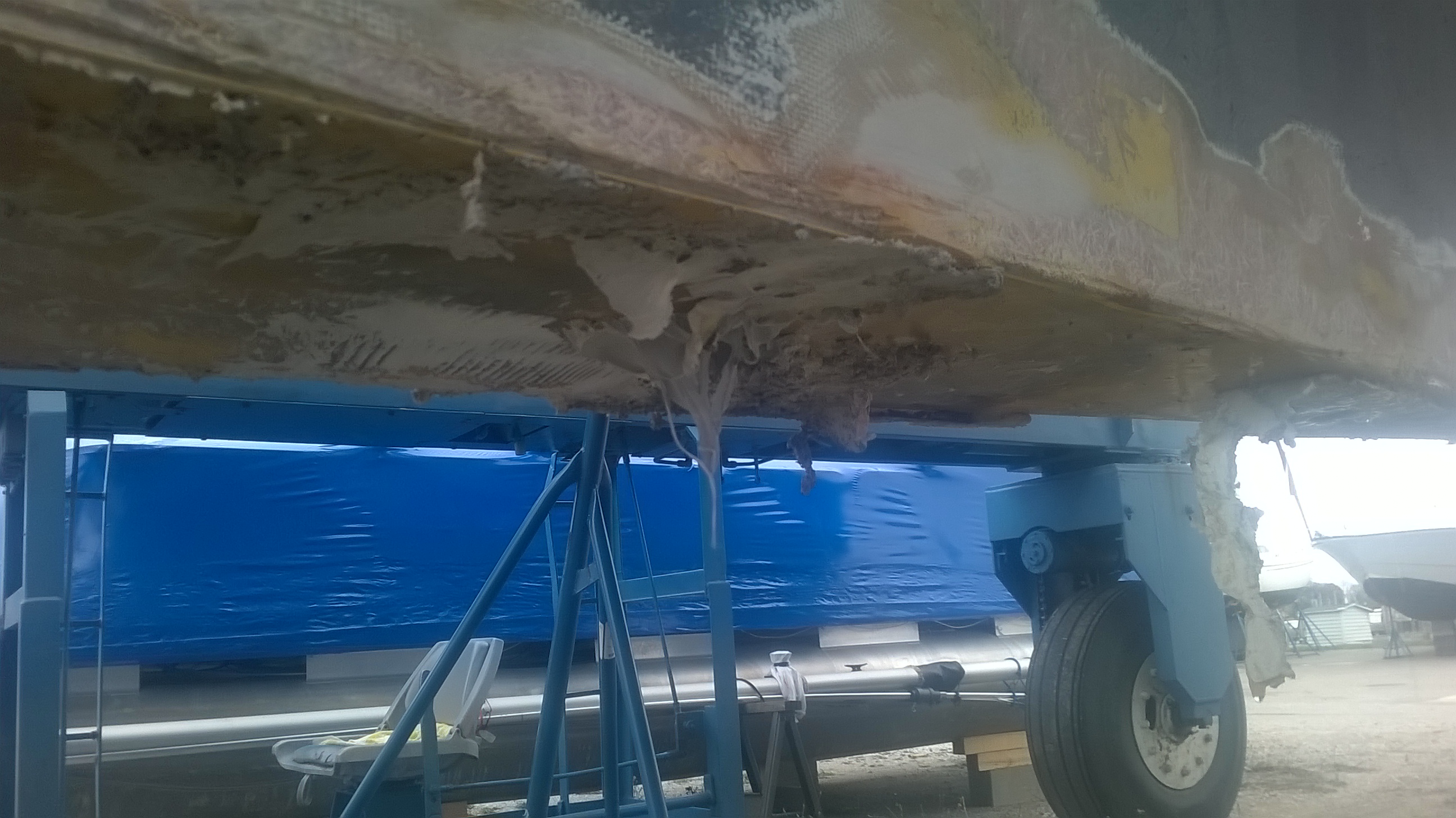

Doing this repair now on my 1969 Columbia 36, DIY. Yard lifted the hull with the travel lift and didn't charge me for it. Don't expect that to happen. My hull weighs 7000# without the keel, I don't think you could lift that by turning the jack stands. Expect the hourly rate for two or three guys up and down for the lift.
On mine, one of the hot dipped hanger bolts had rusted away in the joint and all were badly rusted at the tops. The nuts were barely hanging on. If salt water has been leaking for a while expect some corrosion at the joint, even with stainless. Actually stainless is the wrong material for this application as stagnant sea water will corrode the hell out of it. Bronze is preferred but way more expensive so is rarely used. Your bolts are probably "J" bolts cast in and are not easily replaceable, so may have to be sistered. A new hole is drilled next to the old one, and another hole cut in from the side to put a nut on the new bolt or threaded rod. Then fill the side holes with epoxy putty.
