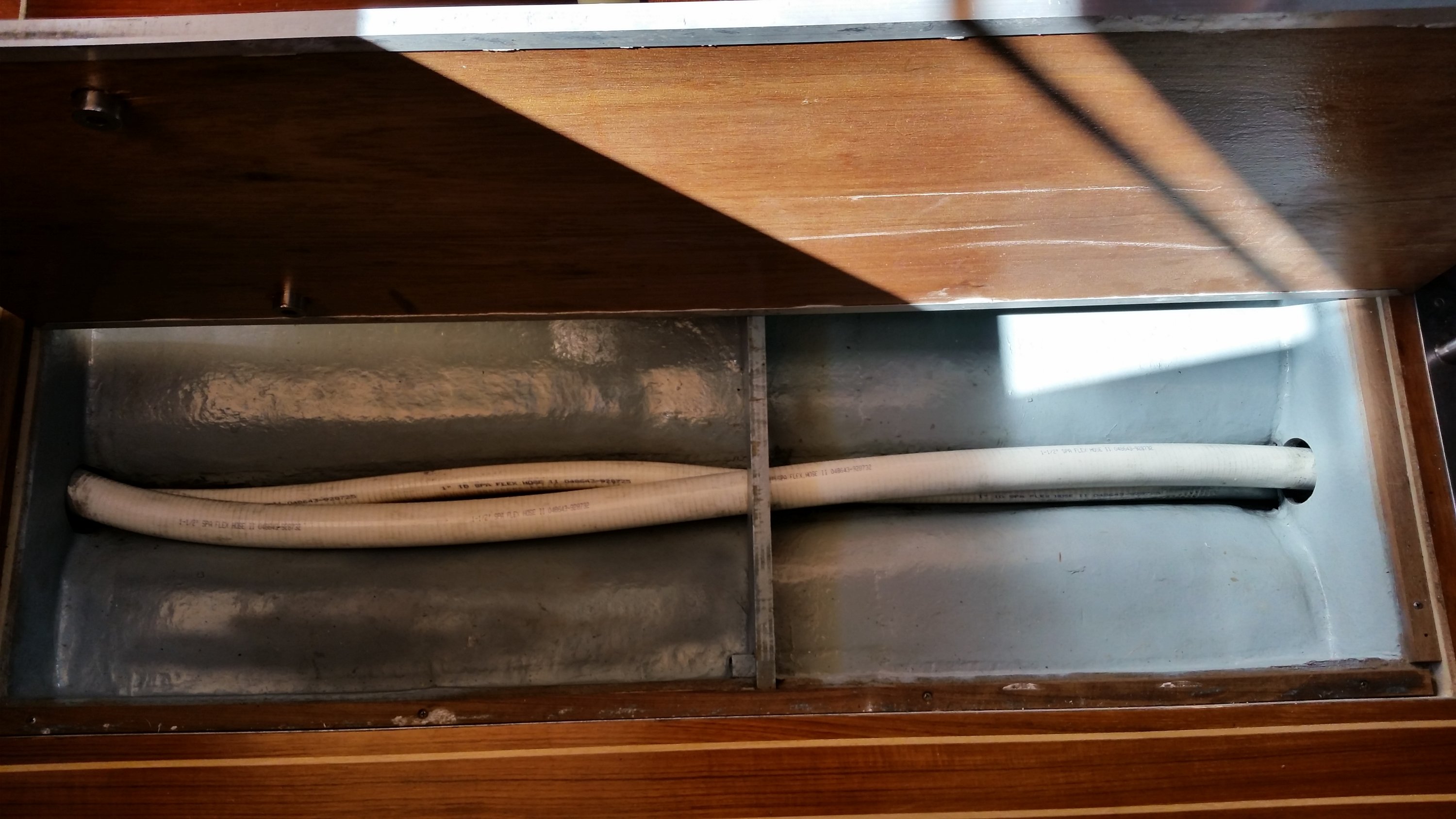

Thanks, here's a pics of the main keel bolts.
It looks like the forward nut will be accessible with one of those universal joint type extensions. Not sure what's going on the the bedding around it. Wondering if it was a leaker and the PO fixed it?

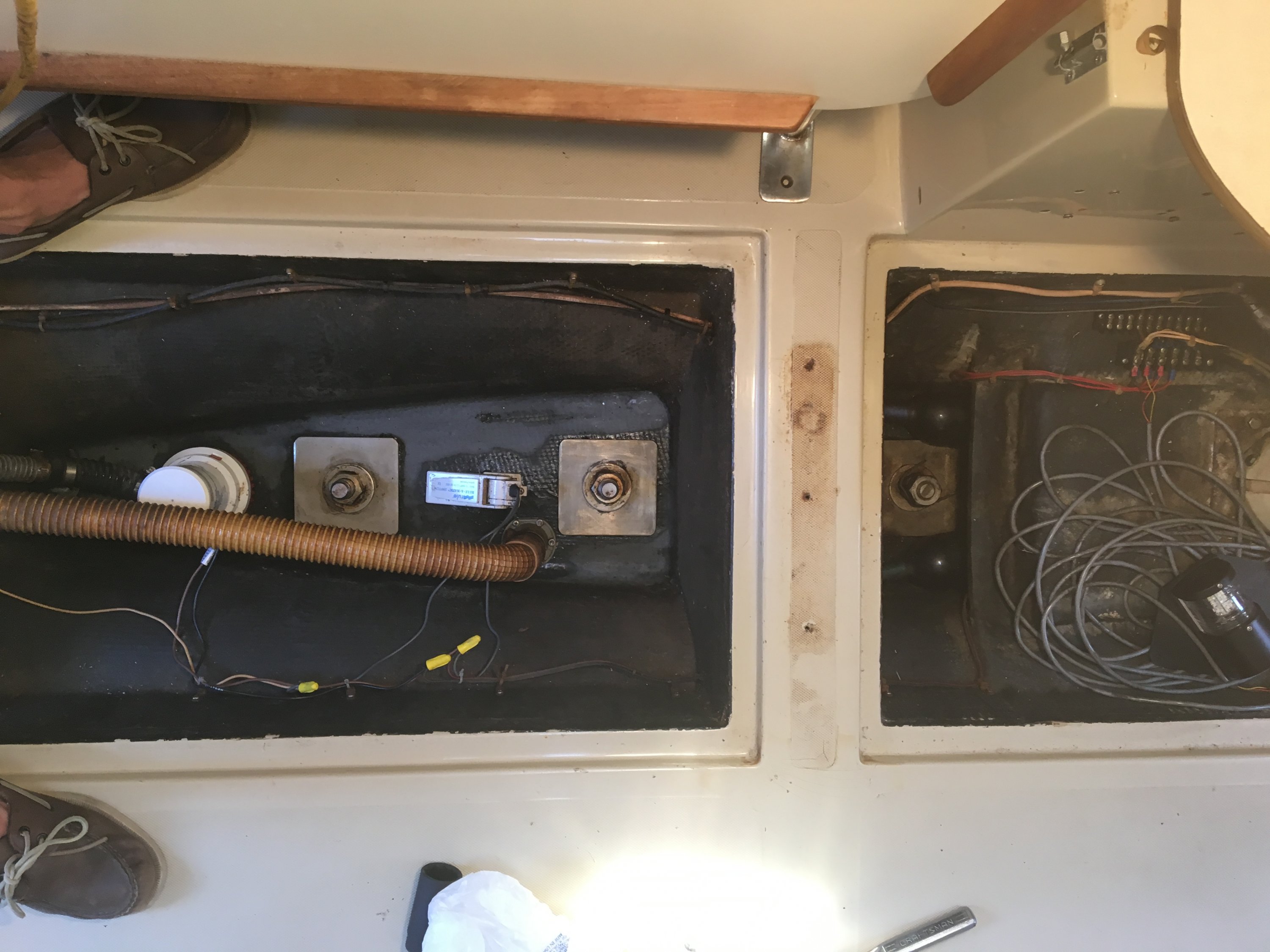

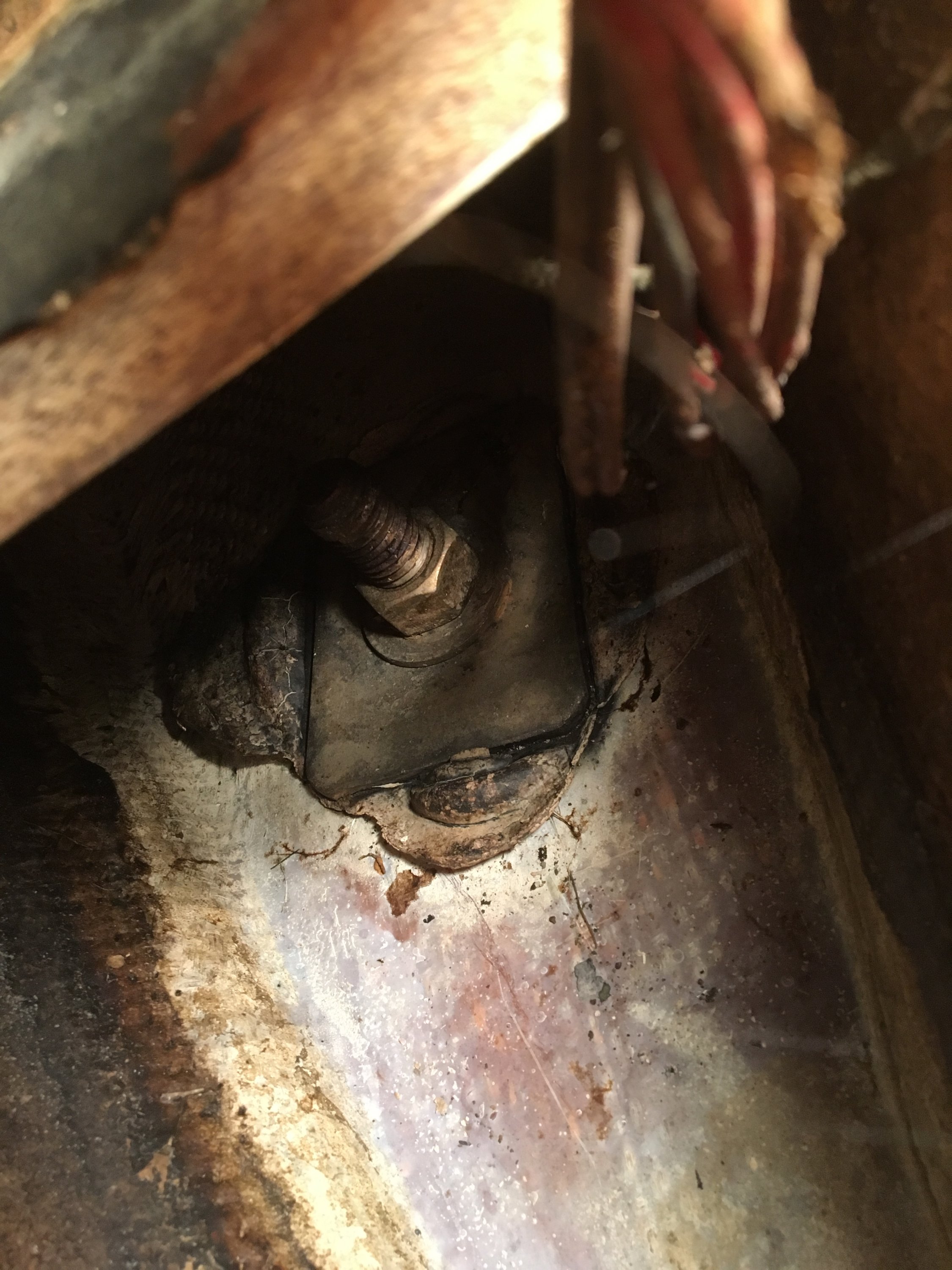

My 35 has 7 bolts: one on the centerline forward ahead of the mast step, two (side by side) under the mast step, two (side by side) aft of the mast step (pictured), one on the centerline behind these two (pictured), and one on the centerline at the far aft of the bilge (pictured).
I pull the nuts one at a time, clean the threads, add some Tef-Gel, and tighten the nuts, every other year. Best guess is that I have them torqued to 120'/lbs. They are tight, and all torqued similarly.
I was going to share three pictures, but the picture of the bolts below my mast step is >2.4 MB, so it won't load.

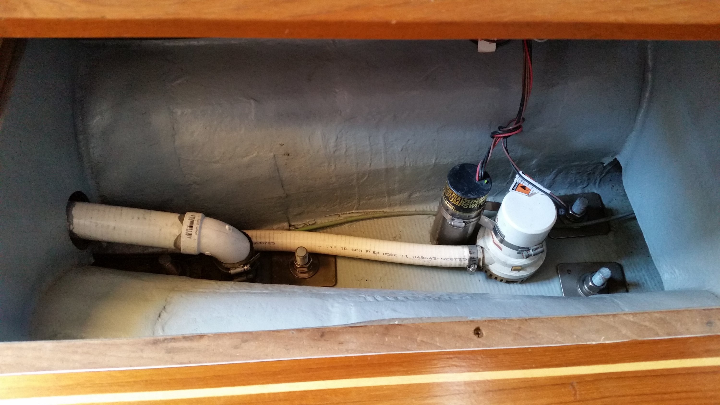

This is the area bilge behind the keel stub

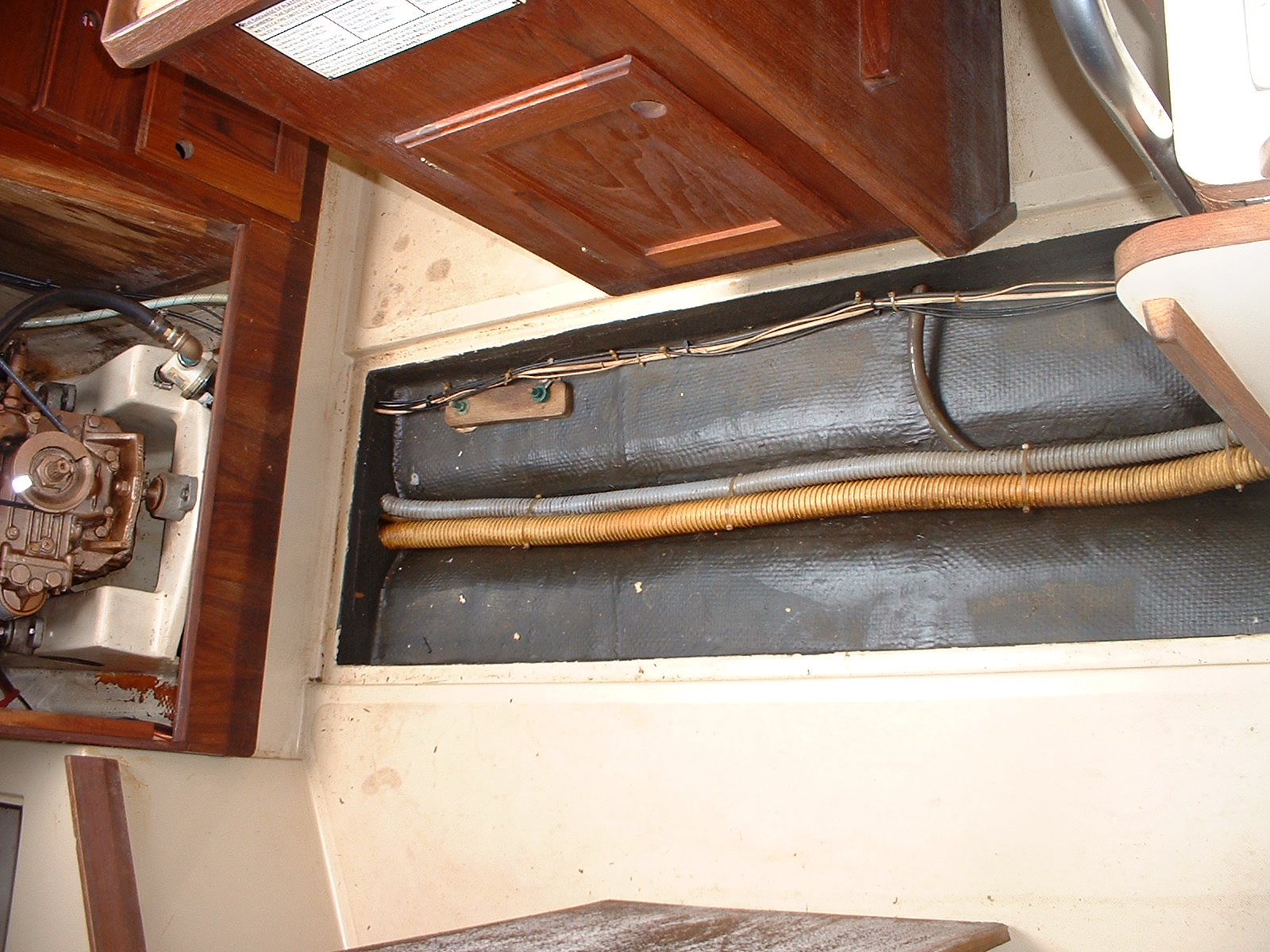

The plate is on the starboard side toward the stern. eherlihy's pictures above don't show such a device mounted as does Karma. Here are pictures that I took in 2006 when I initially surveyed her.
