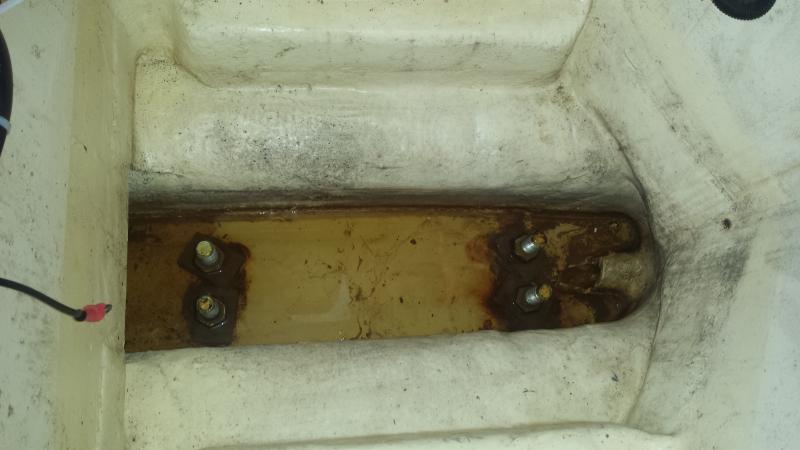

I have been advised to check my keel bolts by undoing each nut, removing the plate from under, cleaning up, caulking and re torquing the nuts. The boat is out of the water resting on its keel.
The yard have loaned me a large 1" 1/2 (38mm) socket and some large bars to shift them. The problem is that 6 of the studs are so long that the socket does not reach the nuts!!. (See photo - water is from a deck leak - another issue!!)
I need a 4" deep socket that can take a lot of torque (Hunter specify 325 foot pounds).
All suggestions where I can get one or a cunning method of doing the job gratefully received - Mr Google is not being too helpful - but maybe that's me.

"If it ain't broken, don't fix it." A visual inspection of the keel bolts can tell you if the bolts and nuts are subject of excessive corrosion and yours look fine. Unless the boat has experienced a hard grounding, or there is a leak or separation at the hull/ keel joint I would not mess with that. Boats regularly go 30+ years without having keel bolts re-torqued.

You have fairly small backing plates and too much force could have several disastrous results. You could strip or gall the threads, you could break the stud or you could cause the fiberglass of the keel stub to fail in compression seriously weakening its' ability to retain the keel. From the scale of your picture using the wire connector in the foreground for scale those don't look like 1' bolts. Torque for a 3/4 bolt is recommended more like 130 foot pounds. Measure the bolts and go from there.
