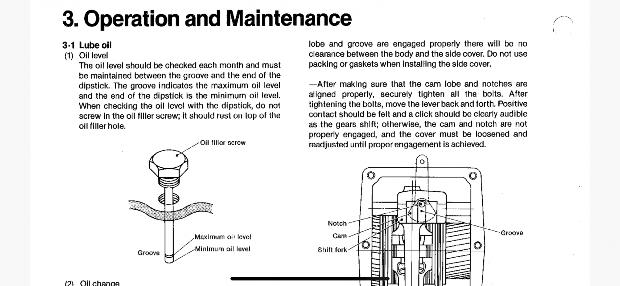

I am still more curious on the scuttlebutt about whether you are supposed to check the oil level (with the original plastic cap) with the cap screwed in or just left sitting on top.
Dec 28, 2015
1,945
Just read my shop technician manual ( large three ring binder with a lot of detail). It specifically stated to check it without screwing the cap down.
