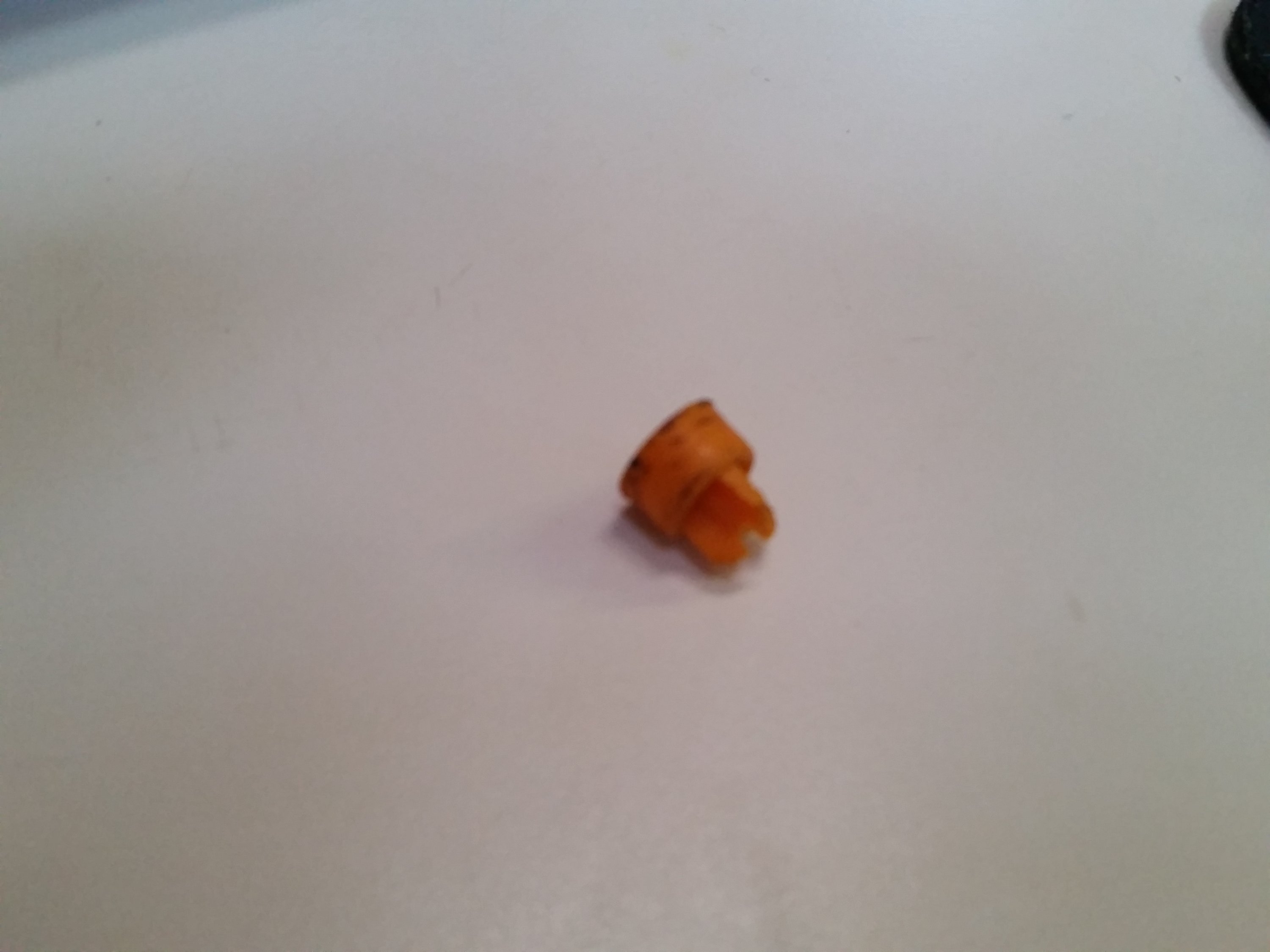

Aug 30, 2015
10
Catalina 42 Mark II In the SEA...!!
be careful with the little cap assembly on the transmission fill tube. if yours is plastic don't screw it in too tightly or it will fracture( which is bad because it can take a long time to get such a complex part from japan..)
Oddly enough I'm very familiar with this cap. My cap is loose from the stick and the stick slides up and down on it. The center of the cap is a hole. Found the plug for that hole in the nav desk. Some say it should have a hole in it for a breather but this cap is a non vented plug. Don't know what to do with it.
