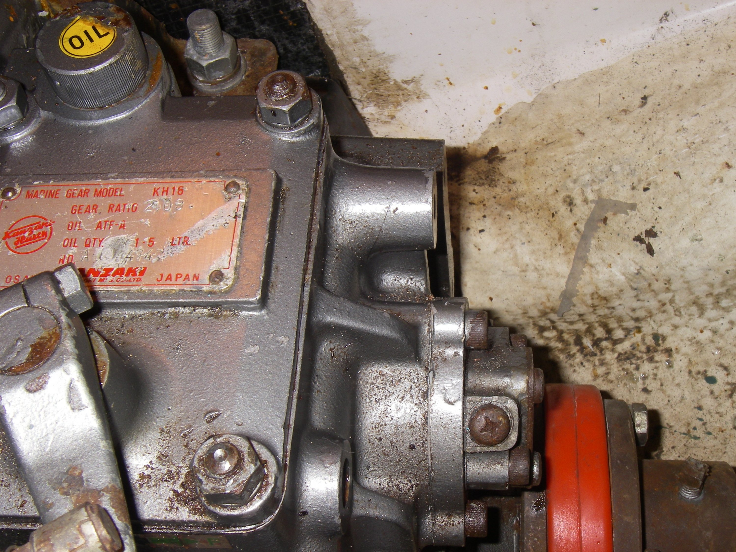

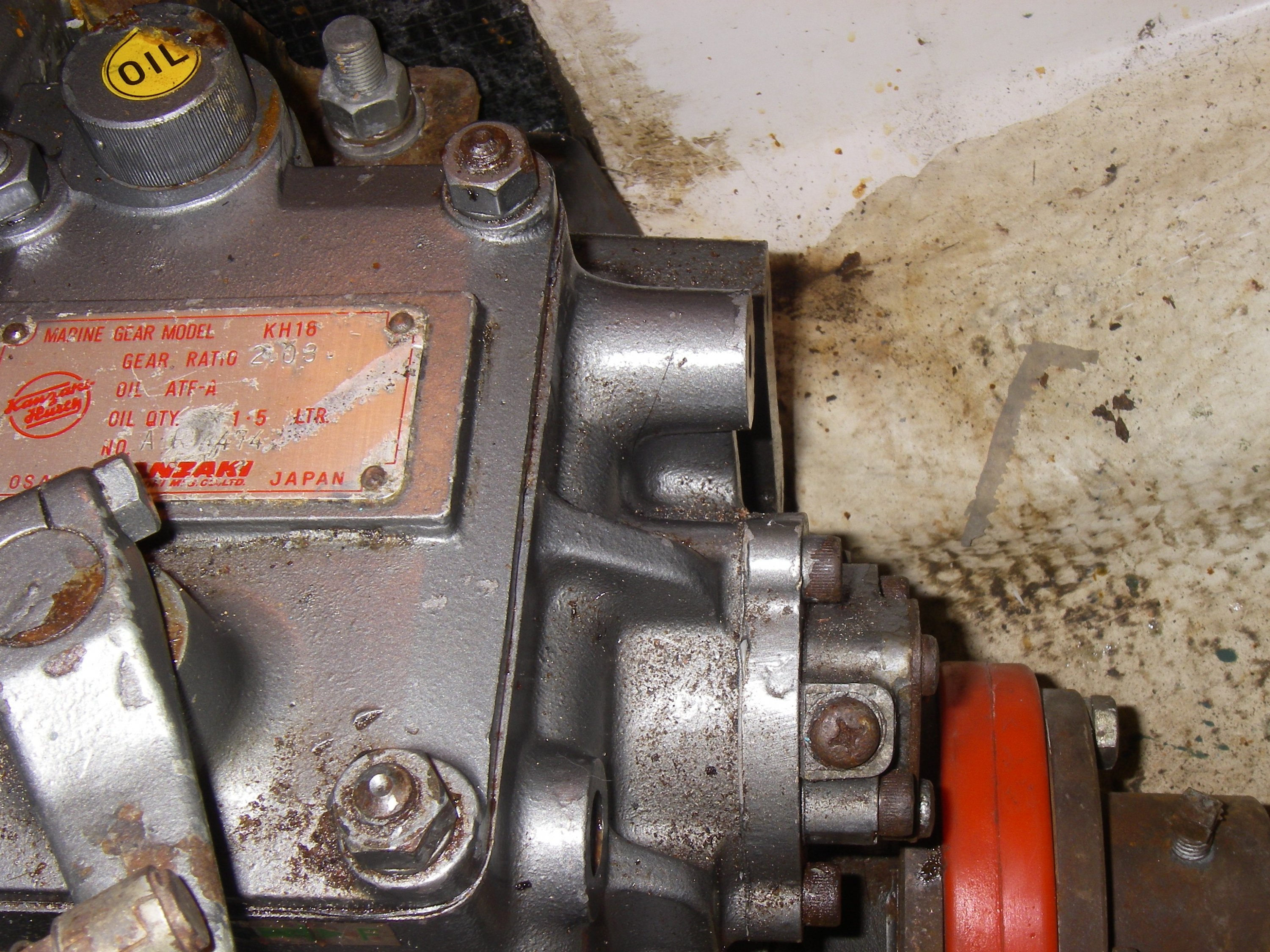

For the engine I use Shell Rotella T 15W-40 in the San Francisco Bay area. The first time I double changed it. What I like is how clean the oil looks after 100 hours, still gold colored and clear on the dipstick.
My transmission takes 1.5 liters see picture. I use Penzoil Dexron 3 ATF.
Thanks!
