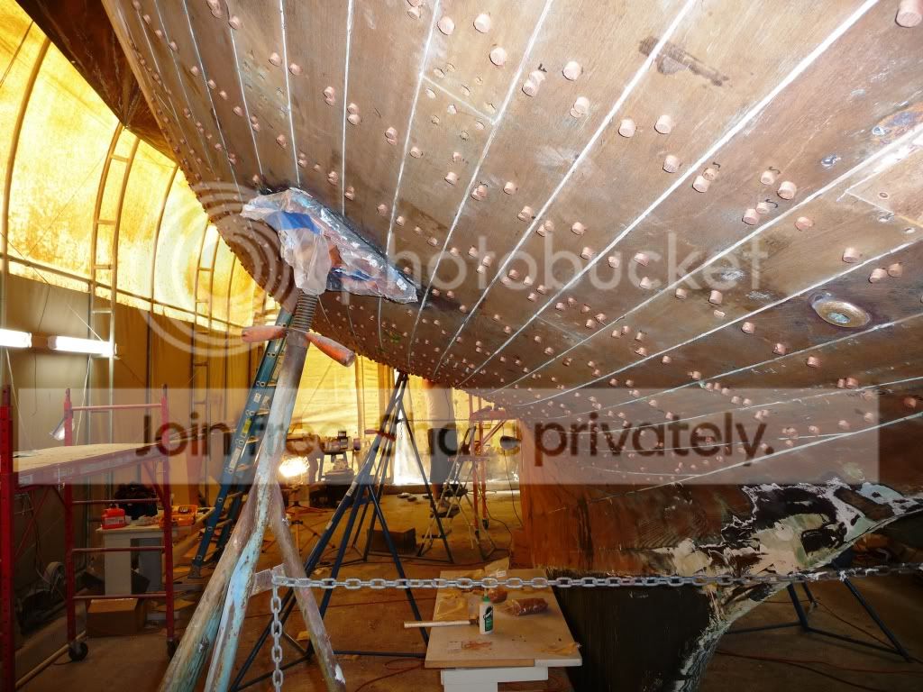

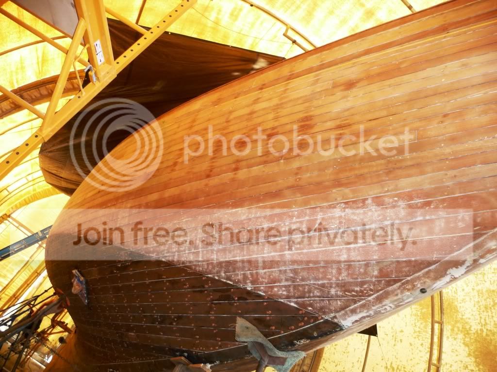

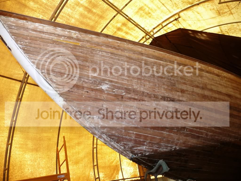

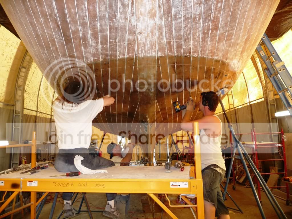

Here are some shots of Happy Talk, our Kettenburg 50 project on day 15 of the blitzrestore.
We've done 2,100 of the 4,300 fasteners to be done and have started bunging her back up.
All of the seams, both above and the necessary ones below the waterline, have been reefed out and are ready for compound.
and
The old paint has been faired and the Starboard AWL planks longboarded, since a PO had sanded from a dinghy and put divits in the planking.
We are on track and under budget thus far:
More to come....
