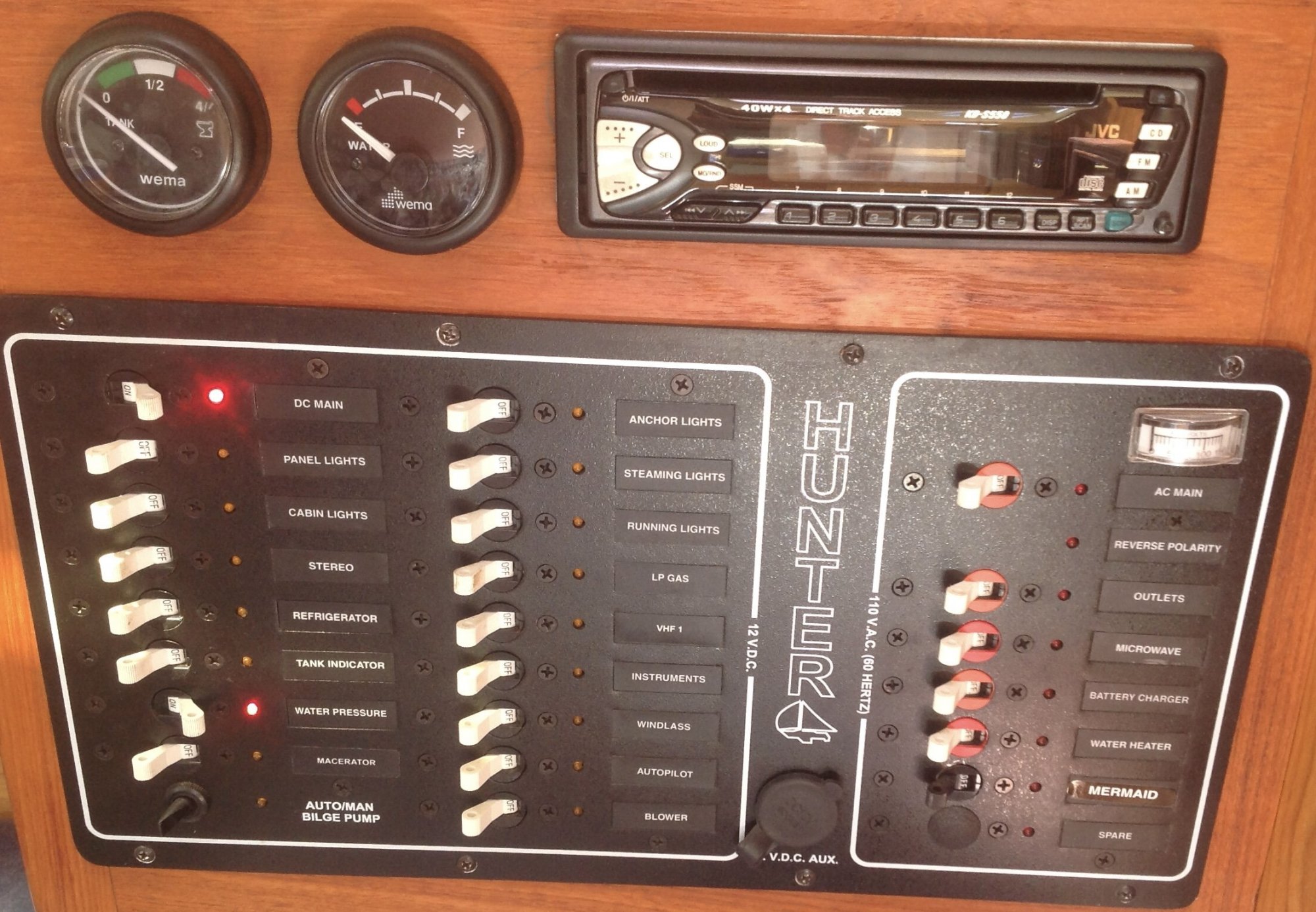

On my 2000 Hunter 340, since I recently upgraded my VHF Radio, I now want to move on to upgrading my Stereo. I have its original JVC KD-S550 Detachable face AM/FM stereo/cd player. Its works perfectly but there‘s no radio stations to listen to anymore. And I have a pile of CD’s (and Yes, cassettes as well). And all those songs are imbedded in my brain……So it‘s time to move on.

It has an AUX input.
I would love to be able to use that option, but my radio doesn’t have the AUX port. So much easier.
I’m not opposed to modifying the space for a new unit, but I don’t have a heck of a lot of space there or behind there.

Does it have a cassette player? They also make a cassette you insert and has a cable you can then plug things into. Almost an AUX input.
