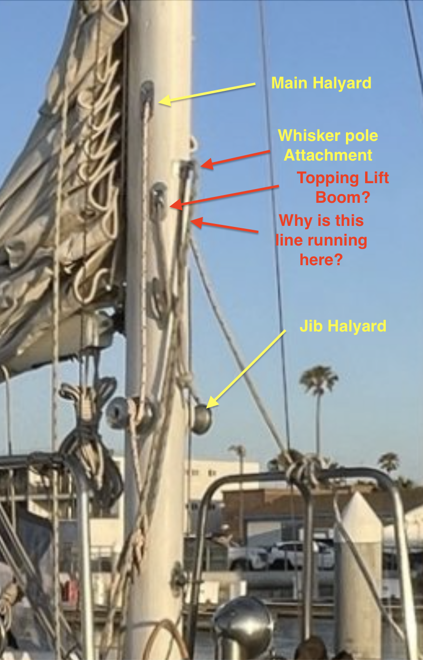

On our 75 mile maiden voyage, the jib tore across at seams (so new sails are up next). Upon trying to get it down, we've noted the sheaves are all seized. So haven't been able to get up the mast yet. We also noticed that the halyard setup is possibly incomplete. Here's where the questions come in.

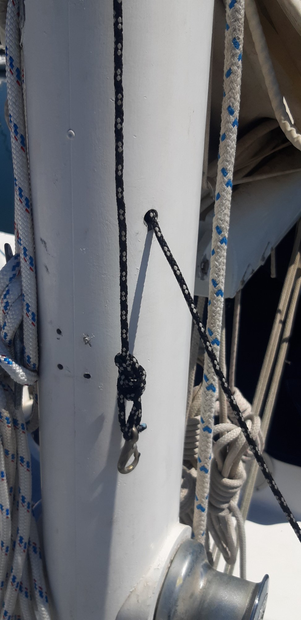

She has a mainsail halyard, a boom topping lift, and a jib halyard. All run in mast. Looks like there is one more mousing line (~3/16" line, ran in a loop) on the forward sheave, outside the mast, and probably was used an ensign (slip hooks on both ends). So four lines up the mast.
I would expect a spinnaker halyard is supposed to be where the mousing line is?
If so, where is the pole topping lift? Is the boom supposed to have a topping lift, or is this one of my missing lines?
Also, there is a mousing line for the staysail halyard as well. Anyone know what diameter this halyard should be? Can't find a spec on that.
And there seems to be an inadequate number of cleats on the mast for all these lines (3 total, I believe). Am I missing something?
Lastly, anyone have any information on the sheaves? Removal/installation tips? Measurements? Any suitable replacements available or do they need to be fabricated?
