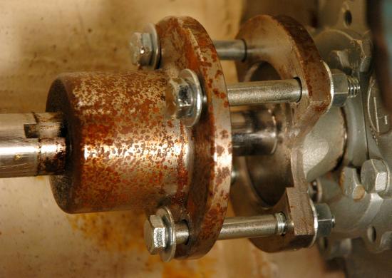

This is the second boat I've installed a PSS on and this time I took a few pics. This one is called removing the coupling. To do this I purchased four three inch 3/8 bolts. Once I had separated the coupling from the tranny I put a 13mm deep drive socket between the 1 inch shaft and the tranny flange and tightend the bolts. Of course I also used a liberal amount of PB Blaster as my penetrating oil. Never use WD40 it is NOT a good penetrating oil! To make it easier I also used my electric impact wrench to draw the bolts together.
