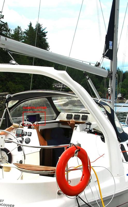

We mounted our plotter beside the companionway. Hopefully you can see in the photo. Sorry, but it's the best shot I can produce on short notice.

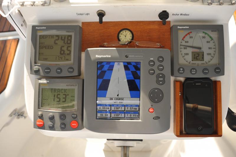

When I added a Raymarine RC435 chartplotter to my B361, I moved the instruments around on my binnacle to make room for it. I didn't want to block my view forward and I wanted to have the information right in front of me for quick reference.
Here's a shot of my view during a recent offshore passage between Fort Myers and Naples, Florida. I also made a teak holder for my iPhone (lower right), which is my back-up chartplotter. Of course, it doesn't link to the autopilot like the Raymarine does.
