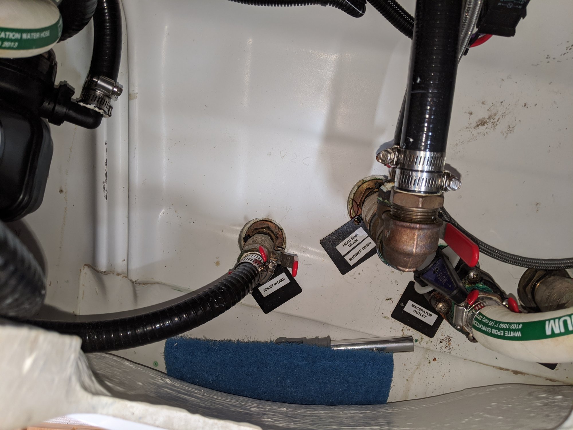

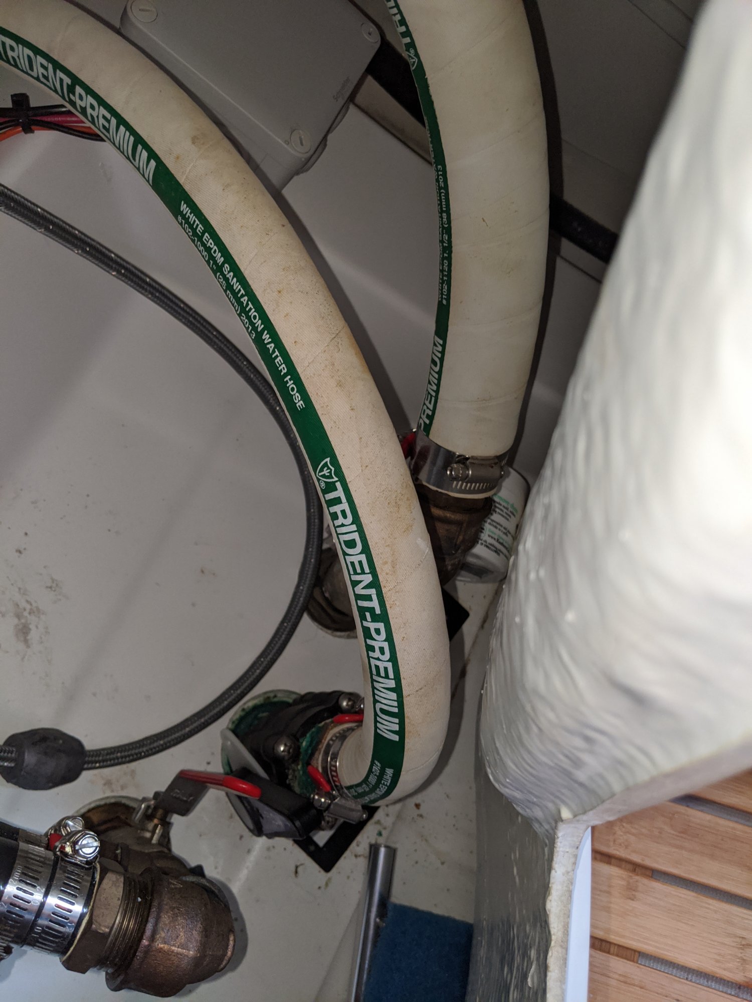

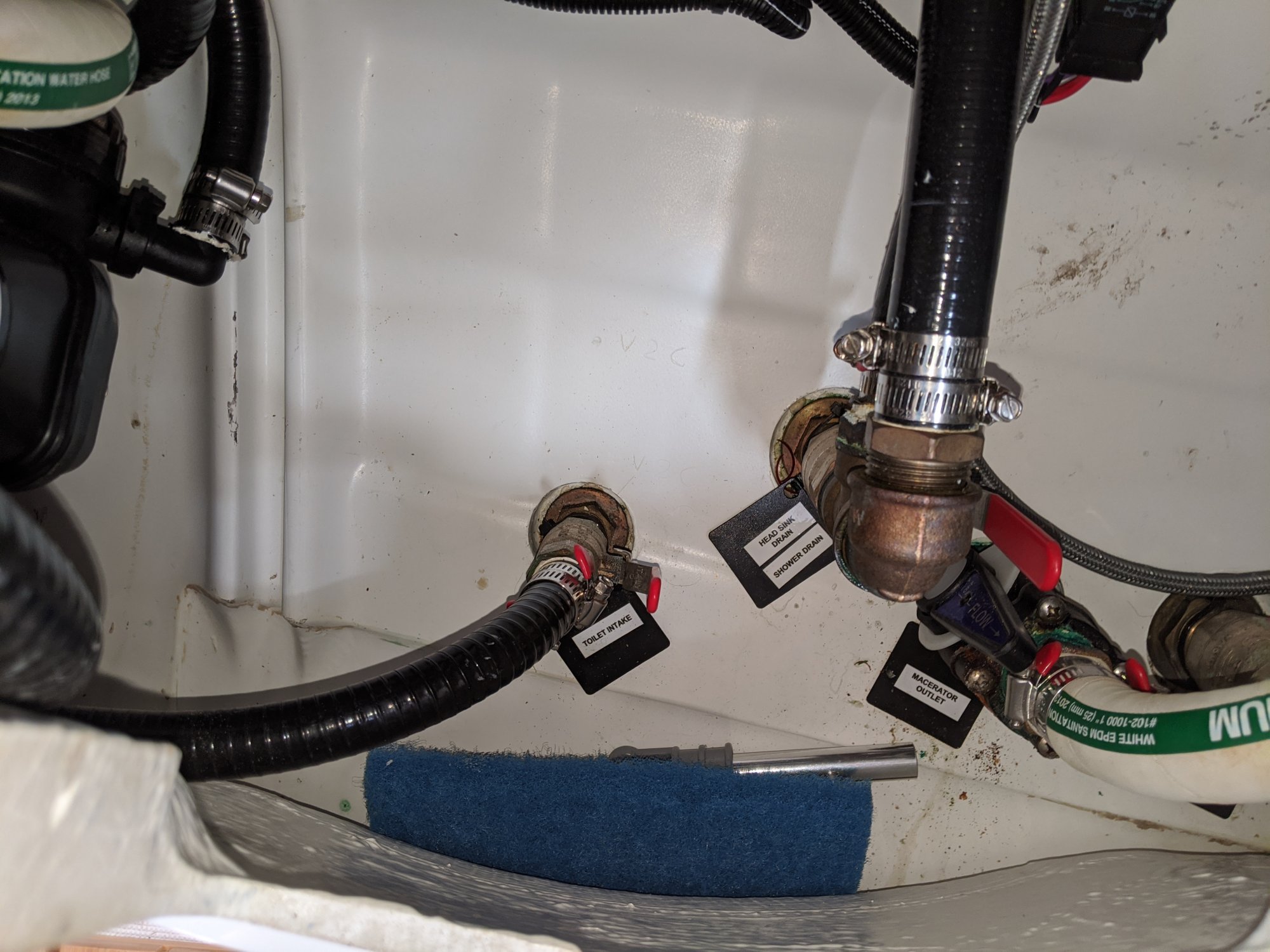

Jason can confirm for his boat, but I double checked ours today (same make, model, and year) and they are Trident 102 for all the black water. Gray water (sink drain and shower sump) uses black unmarked hose with a shiny black outer liner. We're the original owners so that's how it came from the factory.
Exactly the same with mine. See attached photos.
