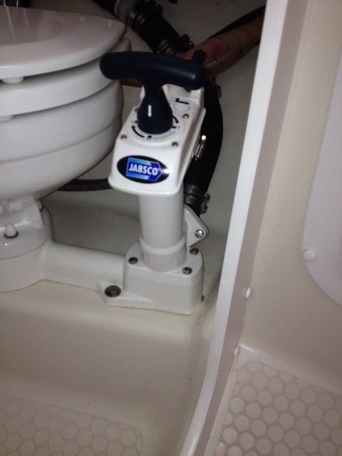

Anyone know what valve I need to order to stop the waste tank from back washing in to the toilet? Seems after we pump it and flush it with clean water it still back-washes in the bowl.
I read somewhere about the joker valve?

Sounds like it is the joker valve. Go to Defender and order a service kit for your Jabsco.

Very easy to remove the old one. Salt build-up on the valve can keep it from closing properly which can allow backwash.
Remove the old one and take it to West Marine if you have one near you. They probably carry the one you need. I seem to recall I bought just the joker valve...not a kit with other parts in it.
Very easy to install the new one. Wasn't even a messy job. Just flush a lot of fresh water before you start the removal.

Just the Joker valve.
The greatest cause of waste return and salt build up is not flushing enough. If the waste is flushed through quickly there isn't enough time to build scale; the reaction takes some time. Also a leading cause of pump-out problems. Pump 6-10 full strokes every time, AFTER the bowl is clean. And then if it does come back, it's only water.
Rather than a rebuild kit, when the time comes, I would suggest a new pump assembly. Not much more $$ and you have, in effect, a new head. Very easy. I am a cheapskate, but this is the best fix for the $$.

Yes, that is the joker valve that will cause that problem.
My recommendation is to not by the Jabsco joker valve. These valves are generally one-size-fits all. The Jabsco joker valve is not very good and will breakdown from winter storage. The Ratarian joker valve is much better.
If you have access to the Practical Sailor achieves, they did a review of all the common joker valves and how they deal with chemical exposure. The Jabsco tested out to be one of the worst.
Another aspect is winterization. I remove my joker valve after winterizing the head. I then wash it with dish soap and warm water. It's another step but once you have the joker valve fail and you have waste on the floor of the head after a good sail, you will do anything to not repeat that fun cleanup.
On the not flushing enough, because the loop is placed close to the head on our C310s you only need to flush about 5-10 times after you see to bowl go dry to get the waste over the loop.
