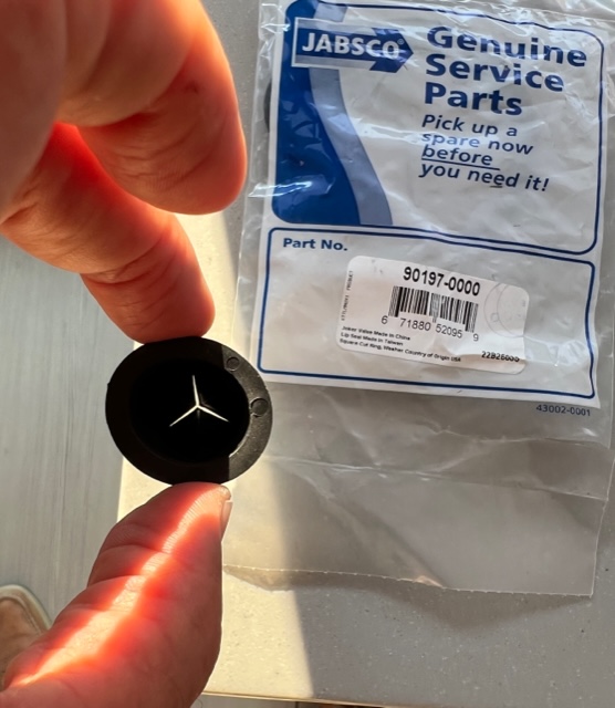

I have a slow back-flow problem in my Jabsco Quiet Flush electric toilet model 37245-1092. I replaced the joker valve and still have the problem. The joker valve I took out was slightly “open” similar to the new one that replaced it (see photo of new replacement). I had lubed the replacement inside and out with Teflon grease before installing, thinking that helps it seal and last longer. (I was a little concerned that the replacement showed gaps but since it was new I figured that’s the way it is, and that the back pressure of the water would keep it closed).
So my question is whether the replacement part was defective, or whether I should replace all the other parts in the service kit before assuming the problem was the joker valve? Some knowledgeable input would be appreciated. Thanks in advance.

I think it's defective. I just replaced my joker valve and there were no gaps.

I can remember the joker valves on my old Jabsco were slightly open and I never had a backflow problem. Installed a Raritan last year and also had a slight opening on the joker and thought nothing of it. Again no backflow. The flaps are so soft and flexible, all you need is an inch of water on the discharge to ensure they stay closed.
I would look elsewhere to find the cause.

I recently stopped by at WM to pick up a joker valve. The attendant brought me a valve that had 1/8" openings in it that I thought it was odd. What stopped me from buying it was that it was an opened package and obviously returned. I picked up an other one and it was tightly closed in an unopened package. I believe it was manufacture defect.

If memory serves, I went through your thought about the opening in a new valve and settled on the thing sealing properly once installed and the housing put the proper pressure on the valve to stay closed.

Also, remember the joker valve is inserted into a small hole that will compress it slightly which may close the valve completely.
