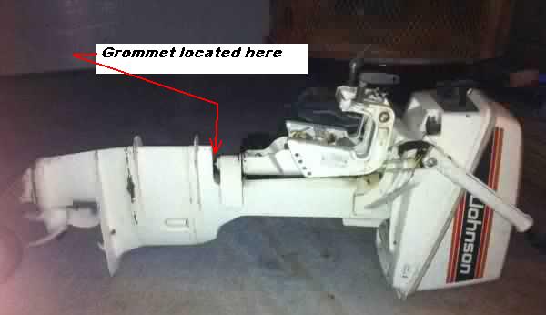

Below I have posted a picture of the mounts on the 9.9/15 they are "sealed" but still subject to the effects of a steamy, damp enviroment.
