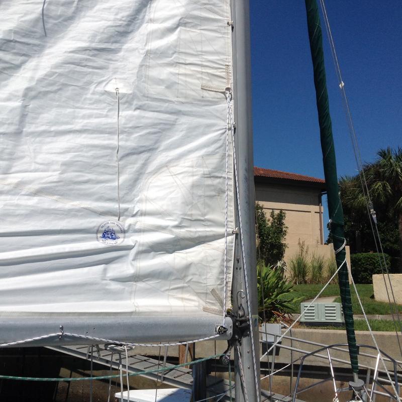

Hello,
I am installing jiffy reefing on Newport 28 sloop.
What is the smallest line you would recommend?
Trying not to compromise the shape of the leech of the main in light winds with too heavy of a line when reef is not in.
Only sailing in coastal waters.
Thanks much, ST

Thanks All,
I ended up using 5/16 with a single reef system. Feels good in the hands and moves through quickly.
Best, ST
