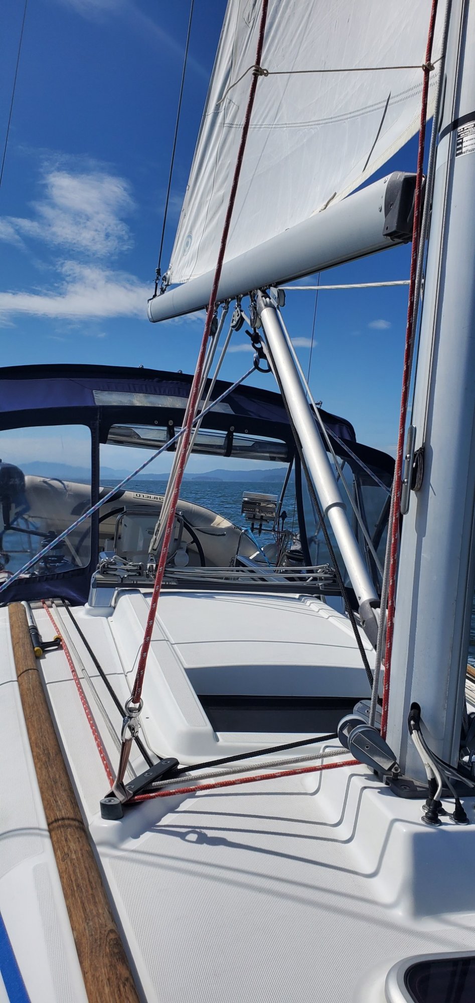

More than quarter century ago decided to buy a boat and go solo offshore (competent mountaineer, backcountry skier and ocean kayaker but green in sailing). I equipped my double ender JASON 35 with Walder boom brake and this device saved my skin few times when making mistakes or in dark with squalls coming down. Now, at 82, i cruse Salish Sea on Beneteau 31 with my old Fig 8 Descender attached to the boom with control line via block, led to the cockpit winch. Not perfect but cheep, simple and allows to control jibes. I keep Fig 8 dangling loose when sailing to wind, to much friction. On pic: motor sailing in light breeze.

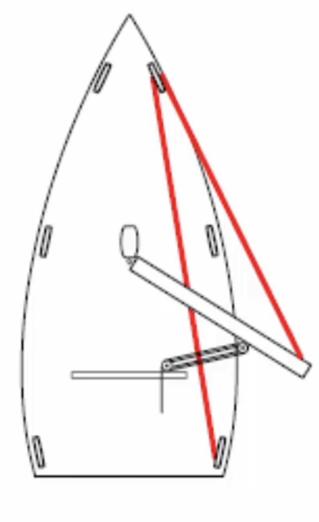

Mifeo
Mar 27, 2022
12
Dufour 365 Grand Large 0 Barcelona
PST.
Preventer
Sheet
Traveler
And the reverse after the gybe.

As you can see, when the boom gybes you must reset the preventer to the other side of the boat; i.e. to the port bow strong point. You must detach the boom from the starboard preventer line then attach to a port preventer line. To stablize the boom for this action, you'd likely need to trim the mainsheet to remove slack. Most users would have a "lazy preventer" set up and ready to go following completion of the gybe. As the boom nears amidships the "holding power" of the preventer diminishes.
Likes: Mifeo
24,836
Ok, this is new to me, how do you rig a preventer?
what is needed?
@Mifeo 's diagram shows the the attachment points
  1. Boom end
  2. Bow strong point
  3. Long line run to the cockpit
  4. Secured in cockpit by winch and or cleat.
You ease the main sheet and snug up the preventer, you ease the preventer and snug up the mainsheet. I want a little stretch in the preventer so I use a line like yacht braid. It is polyester double braid with a polyester core.
5-8% stretch serves as a buffer to the strains the boom and main will give the preventer.
I have a strong block that I secure to the forward dock line cleat with a soft shackle (about $5.00). If a wave hits the boom in a foul sea you can get tremendous forces on this rig. The 1/4" diameter dyneema soft shackle has a breaking strength of plus 10,000 lbs. The block matches that strength.
