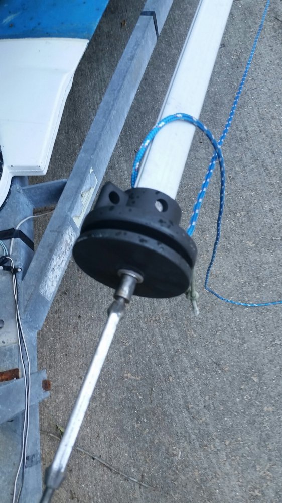

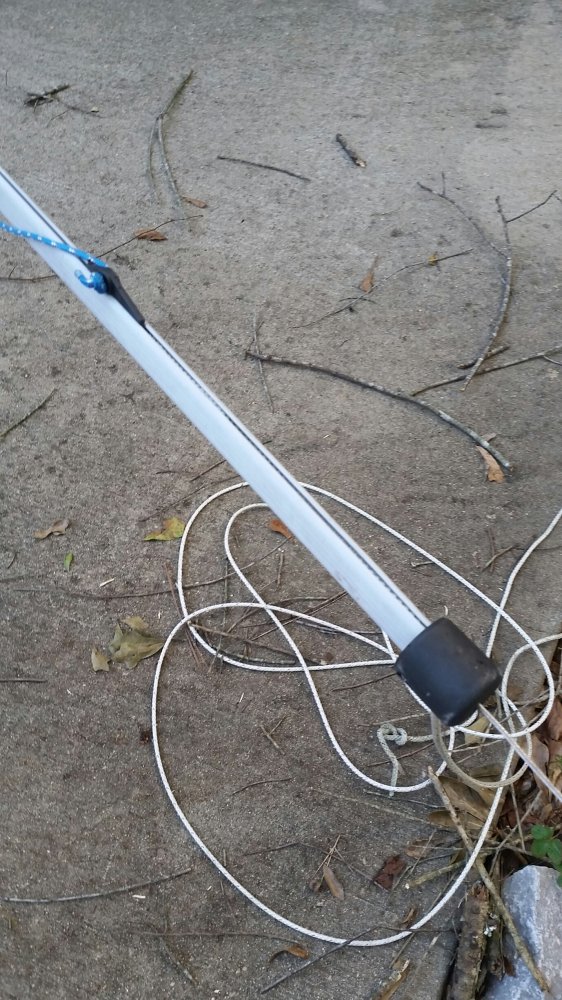

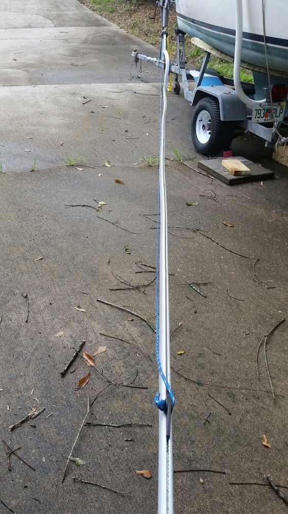

Hi everyone, I don't mean to bother you all, but I need some information. I just bought a Hunter 18.5 that had been sitting for over a year. I know very little about sailing, but I will learn. I might not know all of the parts yet, but the furling jib ? Main halyard ? Mast securing line is a plastic track, and it was tied down on the mast and is now deformed. I have tried putting tension on it in the hot Alabama sun for a week to no avail. I don't even know what to call it for a search to buy another one. Help...please and thank you.

That’s a CDI furler. That’s their one piece plastic extrusion. I’ve been a CDI distributor for a long time and have sold a lot of them.
There is no way I know of to straighten it out. It will not straighten out by itself while installed. A heat gun won’t do it either. The only way to get rid of that curve is to buy a replacement foil.

Also, looking at that picture, it's unusual to find the black plastic slider on an FF1 or FF2. The black sliders came on the FF6 and larger models. So that's making me question what size the luff dimension is. I hope it's not a big sized FF6 which somebody cut down to use on your little Hunter.
The FF1 and FF2 extrusions are different sizes, so you'll need to confirm the size of the plastic luff which fits into the drum at the bottom. A picture of the drum with dimensions would be good too. It's a little difficult to tell how old the drum is from that picture.
