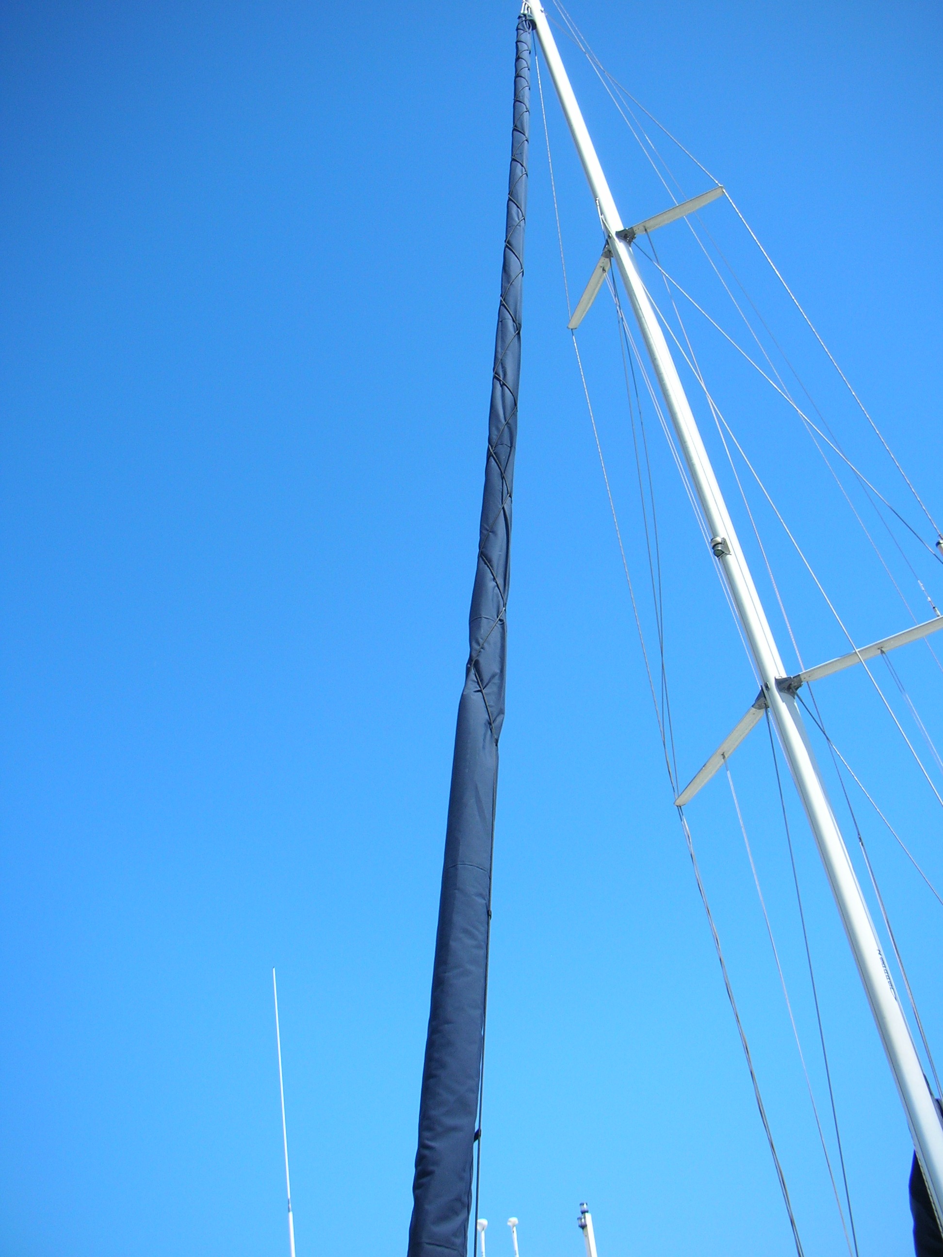

My friend uses a jib sock on his CAL31. The jib/genoa is on a furler. He rolls it up then draws the sock up using his spinnaker halyard. As it goes up he zips the sock around the furled sail. When he gets it to the top he ties it off and it shields his sail.
Down is just the reverse operation, grab the sock pull it down, unzip as you go. Once you reach the top of the sock you disconnect the halyard and fold the sock up and store it with the rest of the sail covers.
The alternate is to have a sail cover sown onto the leech. Then when you furler the sail the sail cover is exposed the sail stays protected.

Cons as I see it: More time required to put things away, One more item/cover to have to stow, Installing an extra halyard if one is not free (not a problem for you). Possibly a little more flapping of the cover. I would probably make the Sailrite kit a snugger fit.
Pros for me: It could be cut long enough to cover all components of the furling system. No unfurling while you are away if a strap gave up. Would eliminate the sacrificial cloth on the leech and foot (I dislike the sail shape after a year with the sacrificial cloth.) You could make the bottom of the cover large enough to enclose the sheets/furling line and keep them out of the sun. Any sail that fits in the furler track could be used and protected. It would be a nice bag over the sail when trailering and storing. ( I leave my sail on the furler when trailering. )

I have had one for years. Purchased through this site. And, it's on a 40' boat. Really not much hassle. You will need a second jib halyard or spinnaker halyard. I don't like sewn on covers in light air.

On a small boat like the Javelin, you may be able to have a sailmaker apply an adhesive-backed UV cloth to the leech and foot to protect the sail from the sun. That would be easier than adding a halyard for a jib sock (Although, if your sail is set up to use the luff-wire in the jib in place of a forestay, is the upper swivel attached where the forestay would be, or where the halyard would be? If attached to the original forestay tang, you should be able to re-install the original jib halyard to useto raise the sock.) I like the UV material on the sail better. This UV material would be thinner than the Sunbrella cloth used on larger boats, and is just like the self-stick material used for Class Insignias. I think it is used on many racing boats that have furling jibs.
