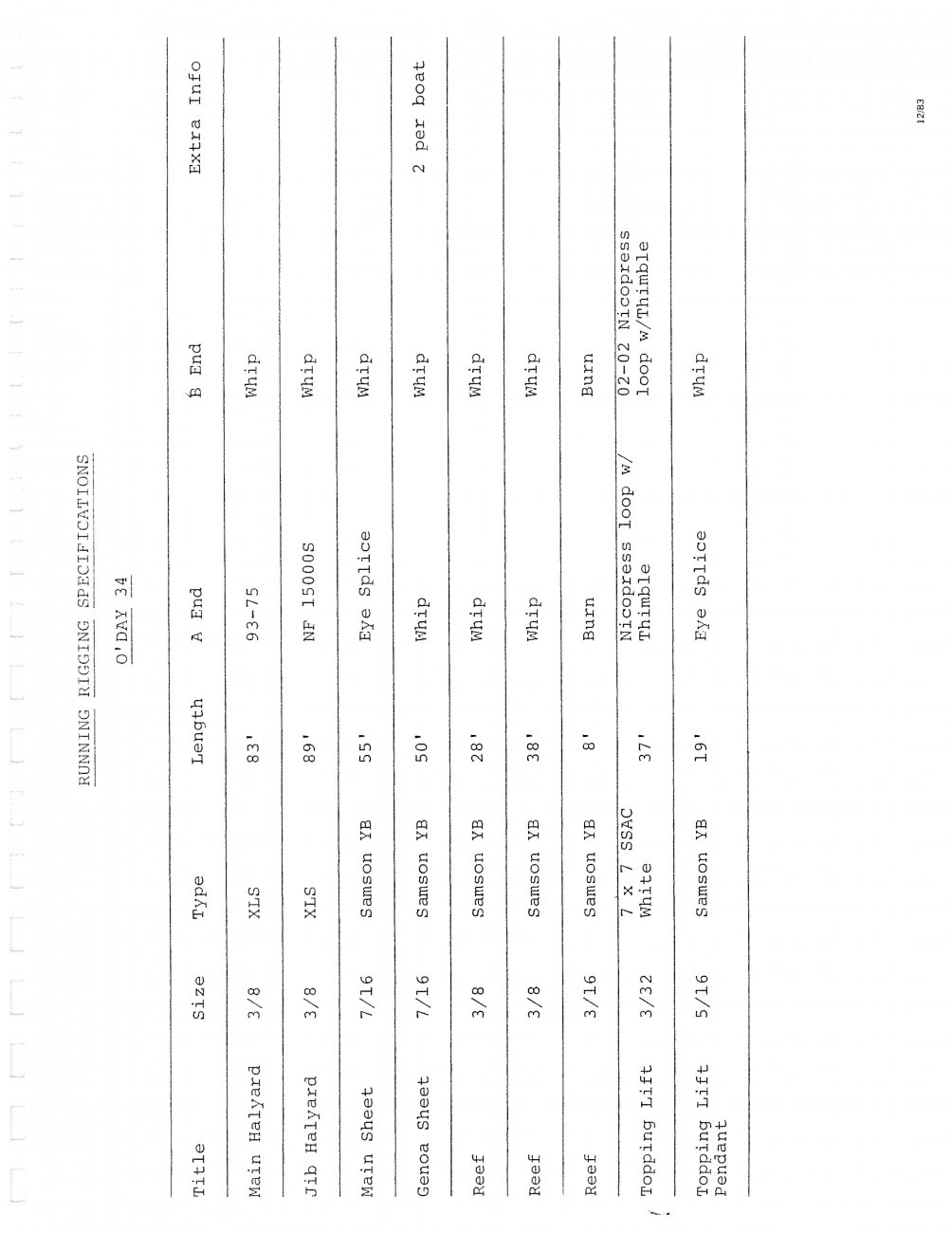

The Genoa sheets for my 135% Genoa on my O'day 35 are 38 feet long. The main sheet for the same boat is 41 feet.
Aug 17, 2010
376
Oday 35 Barrington / Warwick RI
I should have thought of checking the Owner's Manual...
Here is the relevant page for the O'day 34/35:
