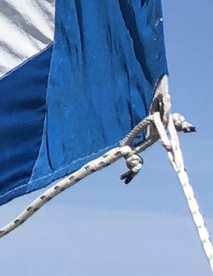

Good evening! I hope y'all had a wonderful Thanksgiving, and are enjoying yourselves! Tomorrow, my brother and I are going to sail Valiant and surprise our Skipper out on the water; as far as he knows, we're not able to make the sail with the other Scouts tomorrow, so it'll be interesting to see the look on his face when we start running circles around him on the bay, haha. Anyway, last weekend, I found it quite annoying every time the sheet knot on the clew of the genoa was getting caught on the shrouds. I did all I could to try and prevent the issue from happening, but nothing really helped all too much. Does anyone have any recommendations as to how to keep this from happening?

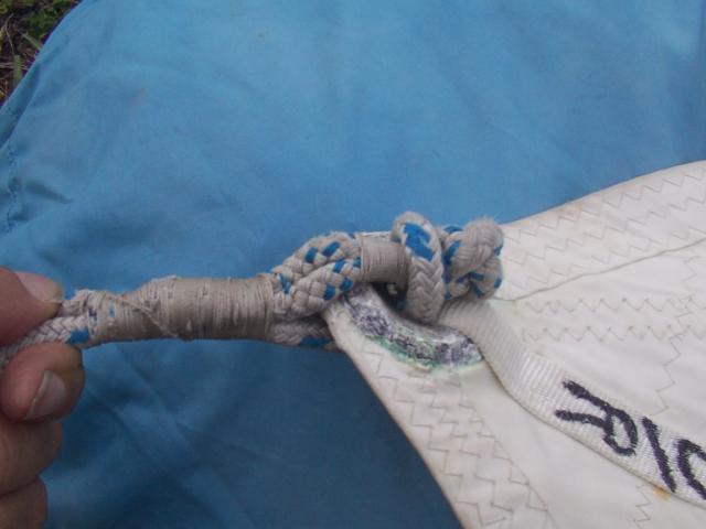

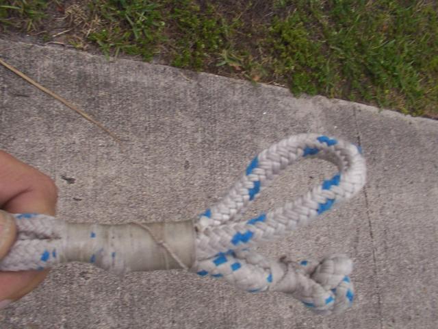

What are you using Simon?
The simplest I've seen is a cow hitch on a single continuous sheet, but I'm not a fan of that knot for that application. Maybe double the bite or whip it.
If you are using two sheets, you can whip them together.
My last thought is rigging tape. But keep it simple, whatever you do.

I made up shackles of dyneema for my genoa sheets because no matter what I used they were hanging up on the shrouds. Also I spliced loops in the ends of the sheets The dyneema shackles are kind of pricy to buy but it’s pretty simple to make your own and a nice winter project. I’ve been using mine for three seasons and keep an eye on them but I see no signs of wear so far.

Mine are a single line with a simple luggage tag on the clew. If you have separate sheets and are using a bowling, see if you can make the loops as small as possible. It may be the case of something you havev to deal with for now until you can do a different knot/line combination .

Since I have two sheet lines, I use a bowline on each. Easy to take on and off for storage a season end. It only hangs in very light wind.

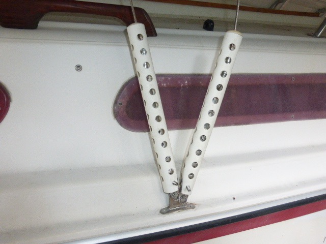

When using shroud covers some ventilation to limit corosion is a good thing also. especially near the adjusters/turnbuckles.

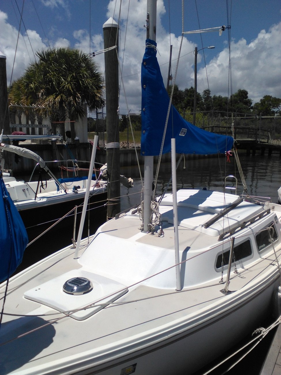

Jon. You have a beautiful old school boat, so natural to go old school bamboo sail guards.
Gunni
Mar 16, 2010
5,937
Notice the difference, Jon has shroud rollers that do not cover the shroud fittings. When I brought my rigger aboard the boat for the first time he took a look at the previous owners fancy aluminum shroud tubes and said “we need to make them go away, they keep salt on the swages and conceal corrosion”. OK chief!
