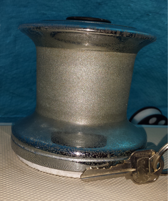

Sorry it took so long to get a picture -- we have had over 100" of snow this season. Here is a picture of the winch, showing the gap (approximately 0.25").

Hello Earendil, By removing the winches you could do several things in the cold weather: (1) discover what that white ring is doing under the winch drum. (It might be a spacer installed by another owner and it might be wearing away??) (2) Replace or remove the ring. (depending on its usefulness) Starboard is a good product for spacers like that or perhaps for some backer plates. Small pieces are not too expensive and the starboard will last. (3) Inspect and Lubricate the winches in the warmth of your home. Phil
