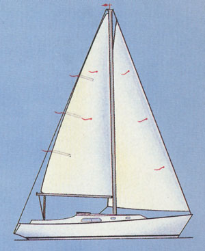

The FIRST thing to do is make sure your headsail has (at a minimum) 3 telltails on each side, placed at 1/3s up the luff. Like this simple setup. This is key to be able to set the car position. If you do not have telltails at least like this, do it now!
The basic idea is to set the car so all the telltails break (or luff) at the same time. What does this mean? It means that when in upwind sailtrim and in point mode, a slight heading up (pinch) will cause all the inside telltails to lift at once. That's ideal. Under lots of conditions this will be when the car is set so the sheet bisects the sail at the luff, but not always. The difference is usually caused by wind gradient; the fact that the wind is faster the higher up you go. But you have to play with it. Other factors (like windshear) can effect the base.
In moderate breeze this is the standard way to set them. As the breeze comes up however and the sail starts to get slightly overpowered, you can move the car back a bit to allow the top of the sail to slightly 'twist off' at the top and release some pressure. This will flatten the boat and allow you to sail just as fast with less sideslip. When this twisting is done the driver should now ignore the top telltails as they will stream almost all the time. Normally the driver will steer mainly to the bottom set; its easier to watch just one. If you are soling them you have to watch them all, and adjust accordingly.
