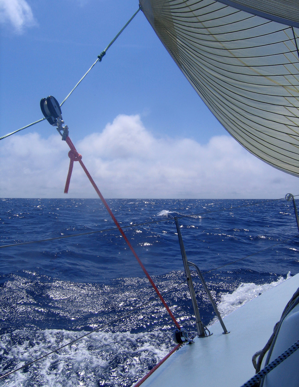

The adjustable car tracks are a great tool for the sailor who is constantly trimming his sails to optimze boat performance.
If you are on the fence, thinking will this really improve my performance? Or will I just spend money and still be the same place? (a trick many of us boaters accomplish with a pain in our wallets)
Might I suggest you try a "tweaker".
It is a line of rope, placed on the boat and it pulls the sail sheets to a desired position too "tweak" the sail shape.
Here is a tweaker on a Genoa. This one is like moving a jib car forward. As you pull it it pulls down on the leach to reduce the twist of the upper portion of the sail. It is infinitely adjustable and costs is limited (this one has 2 snap blocks and line to the cockpit. When on the other tack jsut switch the tweaker), no new holes in the boat.
