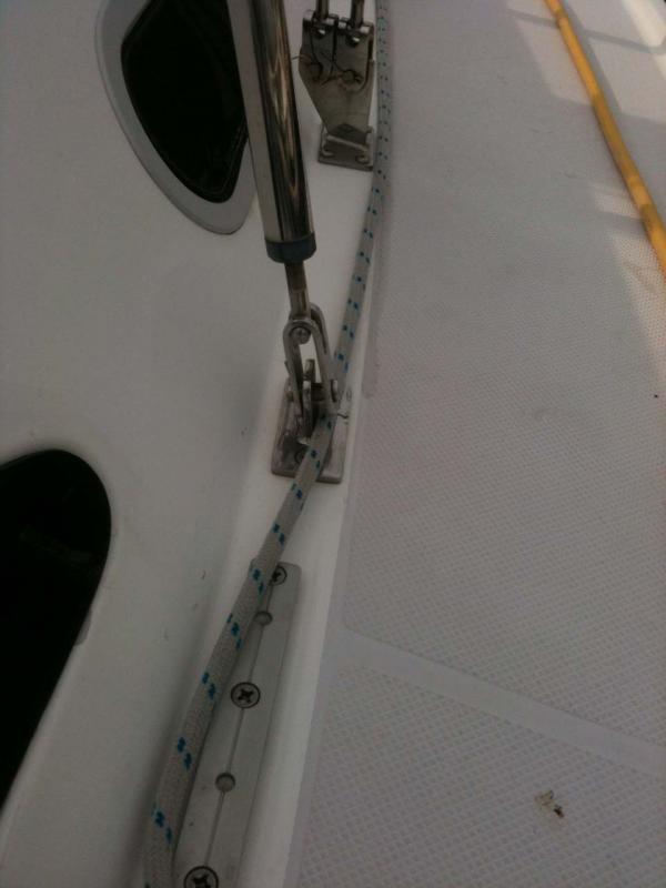

Jib sheet catching on base of shroud
Jul 25, 2007
38
Catalina 310 Middle River, MD
I'm sure many of you have found solutions to the problem of the jib sheet catching at the base of the lower shroud (see picture). I would love to see pictures of your solutions to this problem.
HWeller
C-310, Coral Islander
23,544
Hi. It appearsa you simply need to put a spacer on the inside side of the tang to eliminate the "lip" created where the line is shown stuck under it. Nothing very elegant is needed. Good luck.
