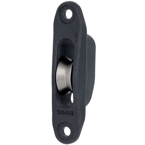

Thanks John and Joe, "sheaves" I couldn't think of what it was called but the music will really help in the future. I really need to get to the "top" of things (get it, top) anyway, thanks for your help, the picture and advice. It's appreciated more than you can imagine. Ty
