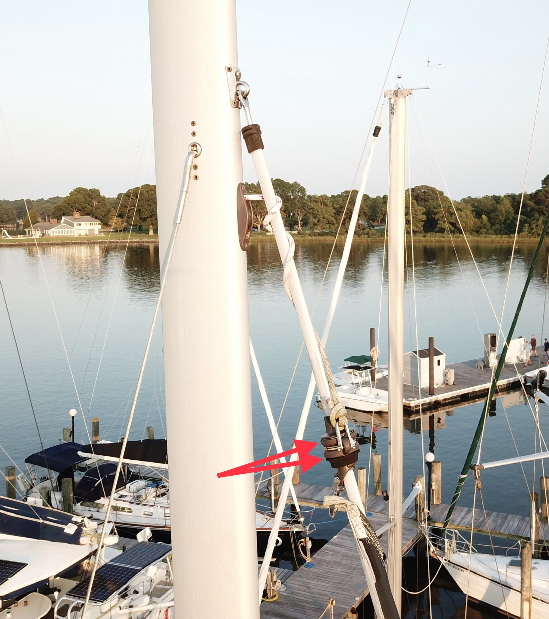

Recently my jib fuller has been acting up, making it extremely difficult to furl the jib - like it is binding. I’ve found the only way it will furl effectively is to release the clutch on the jib halyard, allowing the jib to lower a couple inches - I can then typically furl it in. After a sail today, with the jib furled, I flew my drone up to the jib halyard swivel for a closer inspection. This seems to be a genoa reefing furler, which slides on the aluminum foil encasing the forestay. From the picture, it looks as though it is not swiveling properly allowing the halyard to become wrapped around the forestry. I’m thinking the best course of action is to take down the jib, clean and inspect the swivel. Anyone have other recommendations? I suppose it is a good opportunity to replace the halyard too - it is 10+ years old.

The head swivel must not be more than 6" below the top of the headstay attachment. In your photo it appears that that distance is about 24". You can fix this problem by adding a pendant to the tack of the jib and rais the jib about 18". You can create your own pendant extension from a line.

If you put a pennant on the foot of the sail so you can move the sail further up it will increase the angle and possibly eliminate the halyard wrap. Sometimes a halyard restrainer of some type will be necessary, yours may be one.

Interesting - this Hunter is completely stock with original sails and rigging. I assumed the upper limit of the swivel is as shown in the picture, but I can certainly see how raising it should resolve the problem. I really like the idea of the pennant and it would be nice to raise the jib a foot or so. Thank you both for the input.
24,938
Two Sails look at the mast to the right of yours in your image. They have the sail in the correct position. The upper swivel is at the top of the furler.
Looks like the sail was made a little short. You can add line to the bottom but not the top. In your case the halyard wrapped is adding friction to the furler. That makes it difficult to furl your sail.
Bring the sail down. Wash out the upper bearings with a dab of dish soap and water. Flush well. Attach the sail to the upper swivel. Raise the swivel and sail to the top. Add line to the bottom of the sail to attach the tack to the bottom swivel. While your there and have the soap and water available on the bow, flush the dirt and grime from drum bearings.

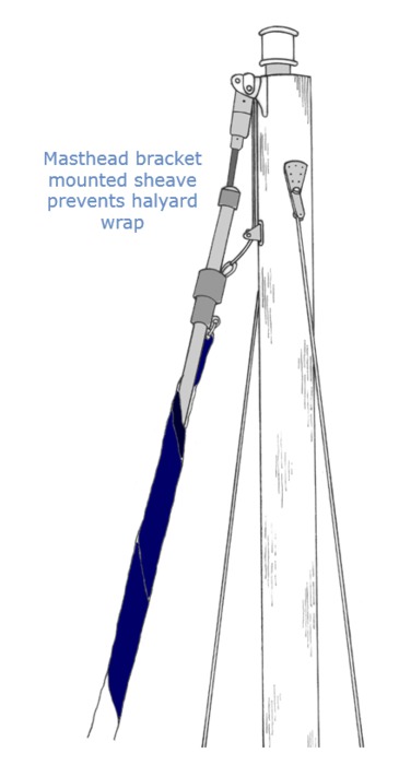

As everyone has said, the swivel needs to be higher. Another thing you can do to prevent halyard wrap is to include a sheave or padeye to increase the angle to the swivel like in this picture - I have a padeye and have had no wrap problems:
24,938
Dmax. the Mast Head sheave is a good idea of for a Mast head rig.
In "Two Sails" situation he has a fractional rig with the sheave exit block for the furler swivel nicely placed like the mast head sheave block.
He just needs to raise the sail to move the furler swivel up to the height of the mast sheave. As a guide while on deck he can mark the halyard to remind him when the swivel has reached the proper height.
@Two Sails, your halyard does not look that bad. You can replace it if you like, but the upper section looks to be in serviceable shape. The lower part of the halyard maybe in need of replacement. Winter is a great time for this task. Buy your line, and then attach the old to the end of the new with a sewn butt join. Then haul up the new and down the old. Some folk use tape. I find that tape can cause issues. A sewn butt join is just better, in my experience.
Replace the halyard with like diameter or slightly smaller so that is smoothly goes through the mast sheaves, when it is time. Also study the knot being used. You will want to use the same "halyard hitch" to secure the shackle. halyard-hitch-knot

As I keep looking back at the original photo, you may still have a problem. The black top plastic bearing affixed to the top of the furling extrusion is too near the mast and goes over the forestay stud.
First the black bearing is too close to the mast and will rub against the mast when turned by the jib sheets and/or furling line causing some difficulty when pulled
The second could be the top of the furling extrusion could be up or against the bottom of the forestay top stud. If so damage can occur and I have seen the damage a time or two of a mast failure due to a forestay break.
Suggest that be looked at with about 4-6 inches of the top extrusion being removed
