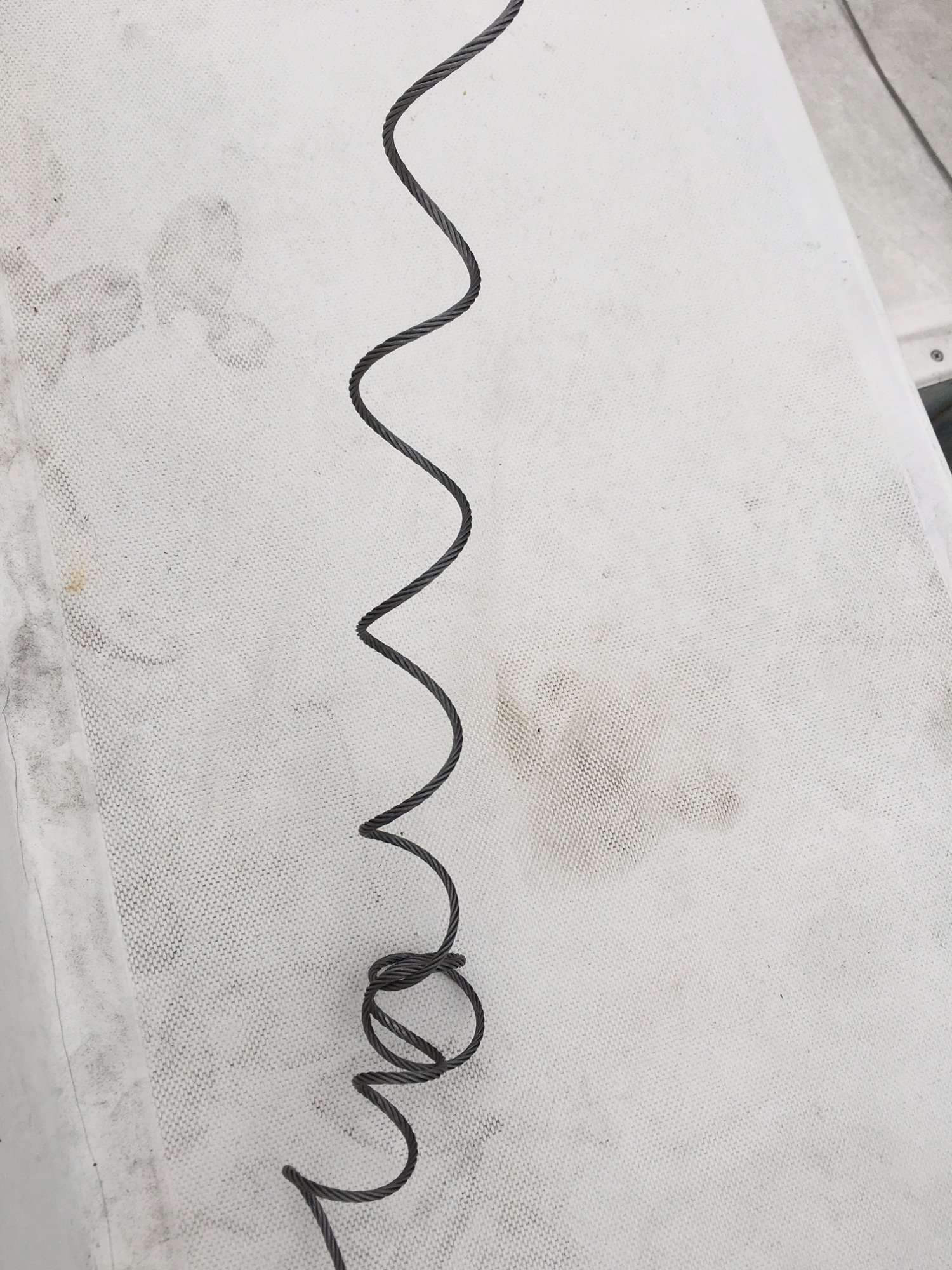

FWIW, the twist in your wire is likely due to furling the jib when the halyard was eased - always furl the sail before easing the halyard. Re-tension the halyard before unfurling...

Mine twisted due to age, I have no furler on the Rhodes 19, and both the main and jib twisted up like a spring.
