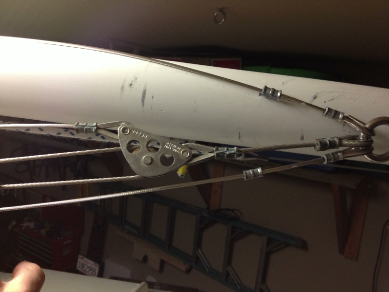

Hey all,
I am working on converting my rig from hobie to standard cruiser and I was hoping some people could chime in as to what style of block they have attached to their mast below the forestay attachment. I currently have some sort of an in-line sheave about a foot down on my forestay but my plan is to put a new tang on the mast for the forestay and then I've seen people attach a stand-up block below the tang for the jib halyard but I'm not sure how low it should be. Trinkka I'm hoping to see some photos of yours I love when you chime in.
Here is what I have. Disregard the two other shrouds those are the two shrouds that go aft and act as a backstay. I'm abandoning them this week and adding a backstay.
Thank you guys in advance,
Scott

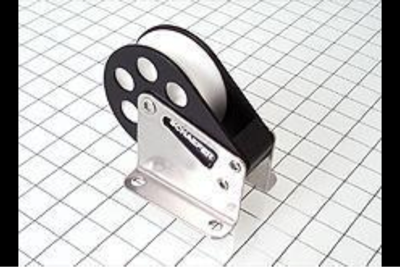

Trinkka thanks for the response. Would this be the type of block I would use under my forestay tang?

I'm really not sure. I couldn't find the Jib block in that Dwyer link I gave you, but Rudy at D&R Marine had ordered me one from Dwyer several years ago and I installed it myself. It was difficult to install mine because I had to cut a square hole in my mast. You won't need to do this.
I think that the one you have pictured will work but you'll need to buy the external Jib block for 5/16" halyard. Check the size of your halyard first. It could be smaller diameter. You definitely don't want a block with a sheave that will take anything larger than 5/16".
Check out this block;
http://www.defender.com/product.jsp?path=-1|118|103371|311514|311519&id=170473
I'm really not sure, but I think that the one you have pictured and this one, is the type that you'd need to install.
If you have a West Marine in your area or a sailboat hardware rigging store, you may want to go down there and talk to a knowledgeable salesman about the size and type for your mast.
I hope that I was able to be of some help to you on this. I just don't want you to buy the wrong thing.

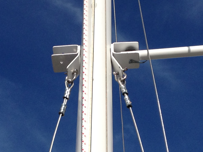

Trinkka,
The rig that I had when I got the boat did not have spreaders however I retrofitted it with them. I consulted a rigger in Southern California and he walked me through the whole process. I fabricated my own brackets and used stainless through bolts. What one sailing shop told me was that the mast isn't the exact shape I need however as long as I'm not in super extreme conditions I should be fine. Like you I tend to try and do thing myself. I re-rigged all the standing rigging myself using double swedge fittings as well.
What do ya think? Suggestions.
Scott

Trinkka,
Scott
It looks like you have all the bases covered Scott. I have to take my hat off to you. Looking at what you have, I have to say that even though the lower stays attachment to the tangs aren't set up in the conventional way of today's standard of rigging, it will work. However, you need to mouse those two shackles so that the pins don't back off. You could use monel wire or a couple of tiny zip ties depending on the pin hole diameter, to secure the pins to each shackle.
Hey, at least you'll get to sail this boat when you're through and that's what counts right now. I don't see why it wouldn't work.
Good luck!
Joe
