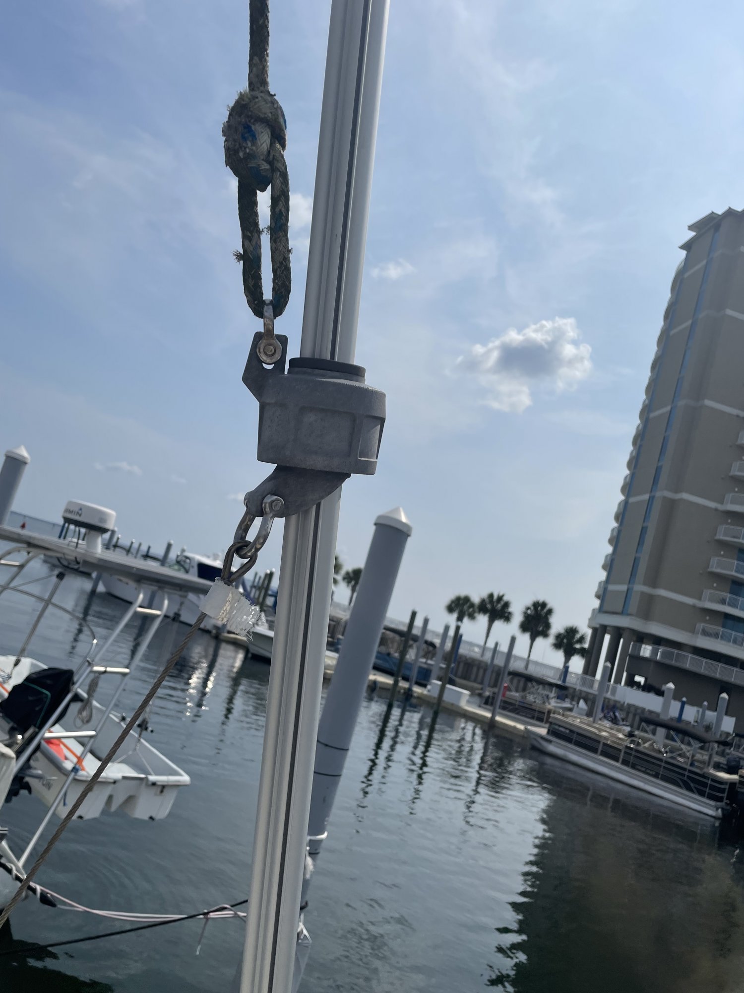

It happens during regular sailing operations and also in port with no wind. I bent the furler line keepers out cause that seemed to be the problem when I first investigated... I thought they were binding on the top disc.
That cable hooks to the tack. I’ve not noticed that being an issue.
I’ll have to look up there to see what the jib halyard looks like. I have no idea about anything related to the jib halyard. I guess my thinking was that it’s a furling job so there’s no jib halyard. I thought I’ve identified every line on the boat (looks fully rigged for a spinnaker), but I may have missed the jib halyard somewhere.
The headstay has never been inspected to my knowledge. This was a foreclosure purchase so I’d assume it hasn’t had the greatest care at least in its recent history. This will probably be on the short list for the boat.

My spinnaker halyard and jib halyard are the same color. I thought the jib halyard was just the wound up excess of the spinnaker halyard.
I think the jib halyard is supposed to run thru a cabin top brake, but mine is just cleated to the mast. The bearing unit where the halyard connects to the furler/sail is the culprit here. Thanks for the help!

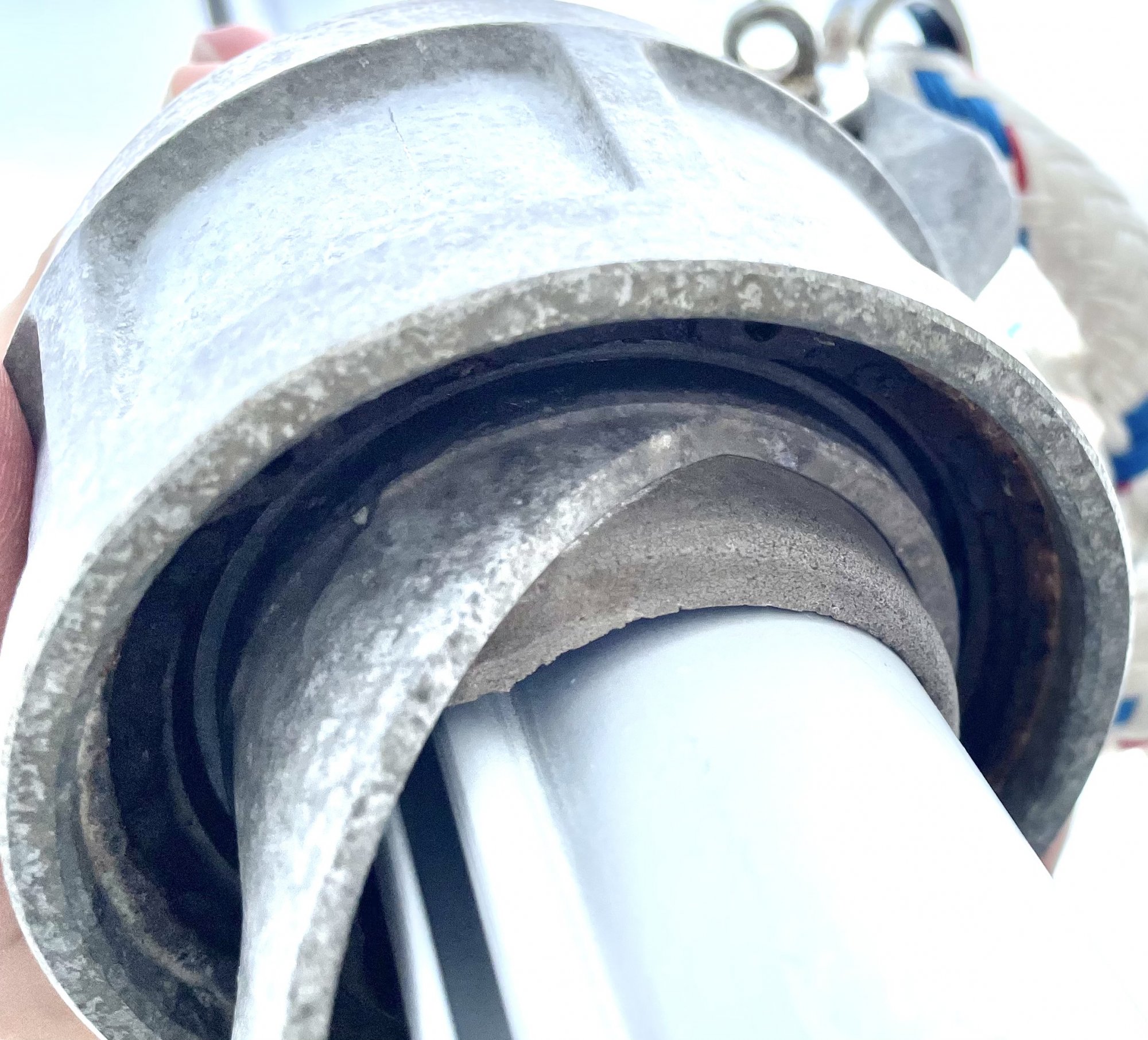

Any idea what will happen if I remove this retaining rig? Will the bearing balls fall out everywhere? I gave it a good soak with sailkote, but I imagine it could use a good cleaning inside.

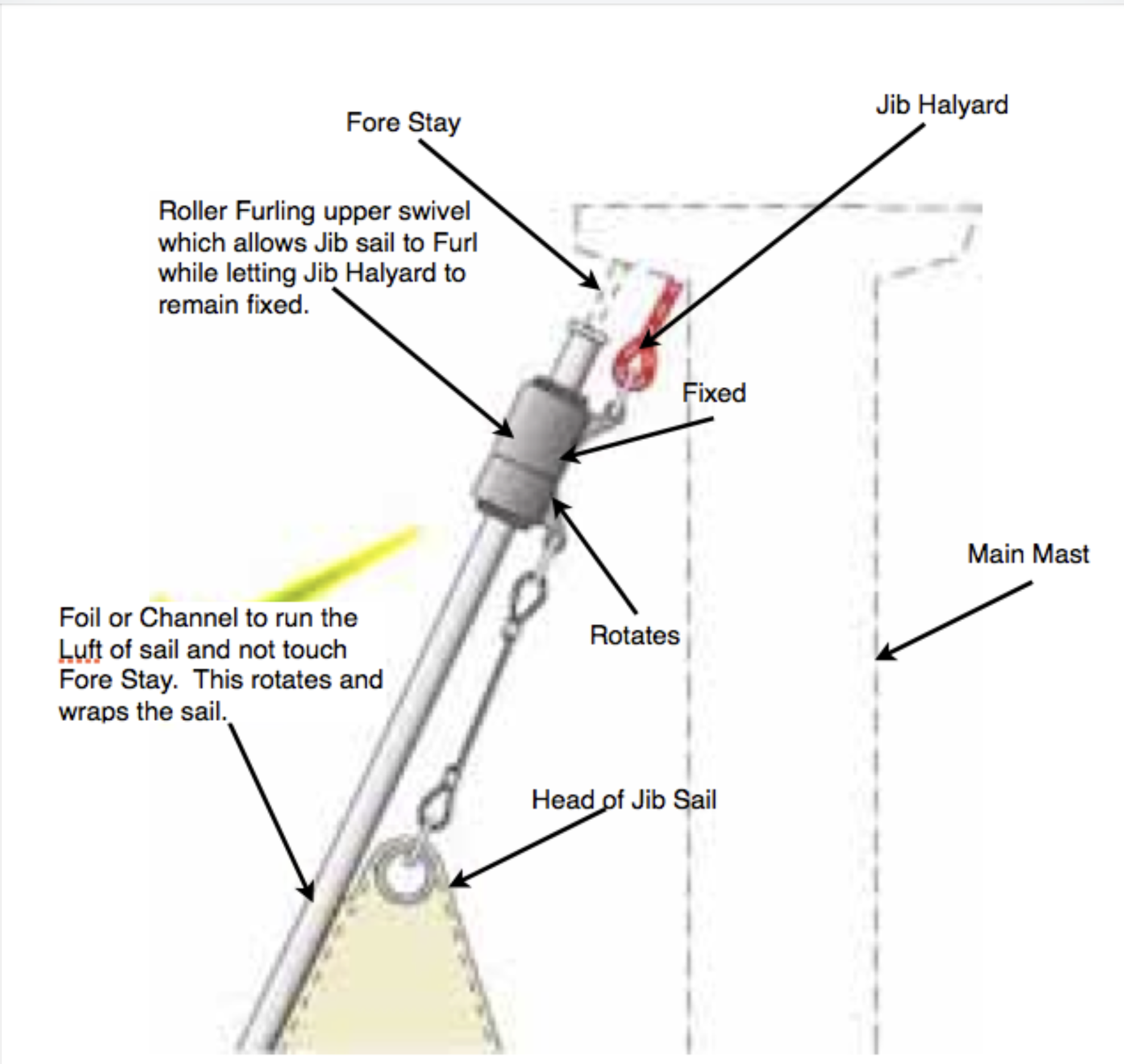

I had my Spinnaker Halyard loop over the Jib Halyard and foul it.
This picture may help clarify.
No.
All of the swivel bearings are sealed.
Normally, each season, when the Jib was down, water washing them works.

Don't have a jib furler myself but based on the image posted by James it looks to me like the swivel bearing is installed upside down. The angle of the line going to the head of the jib doesn't look right either but I get confused when I see an elephant up too close anyway.

I think that diagram has misleading labels. I don’t see how the “fixed” part is supposed to be fixed. Here’s what mine does.
