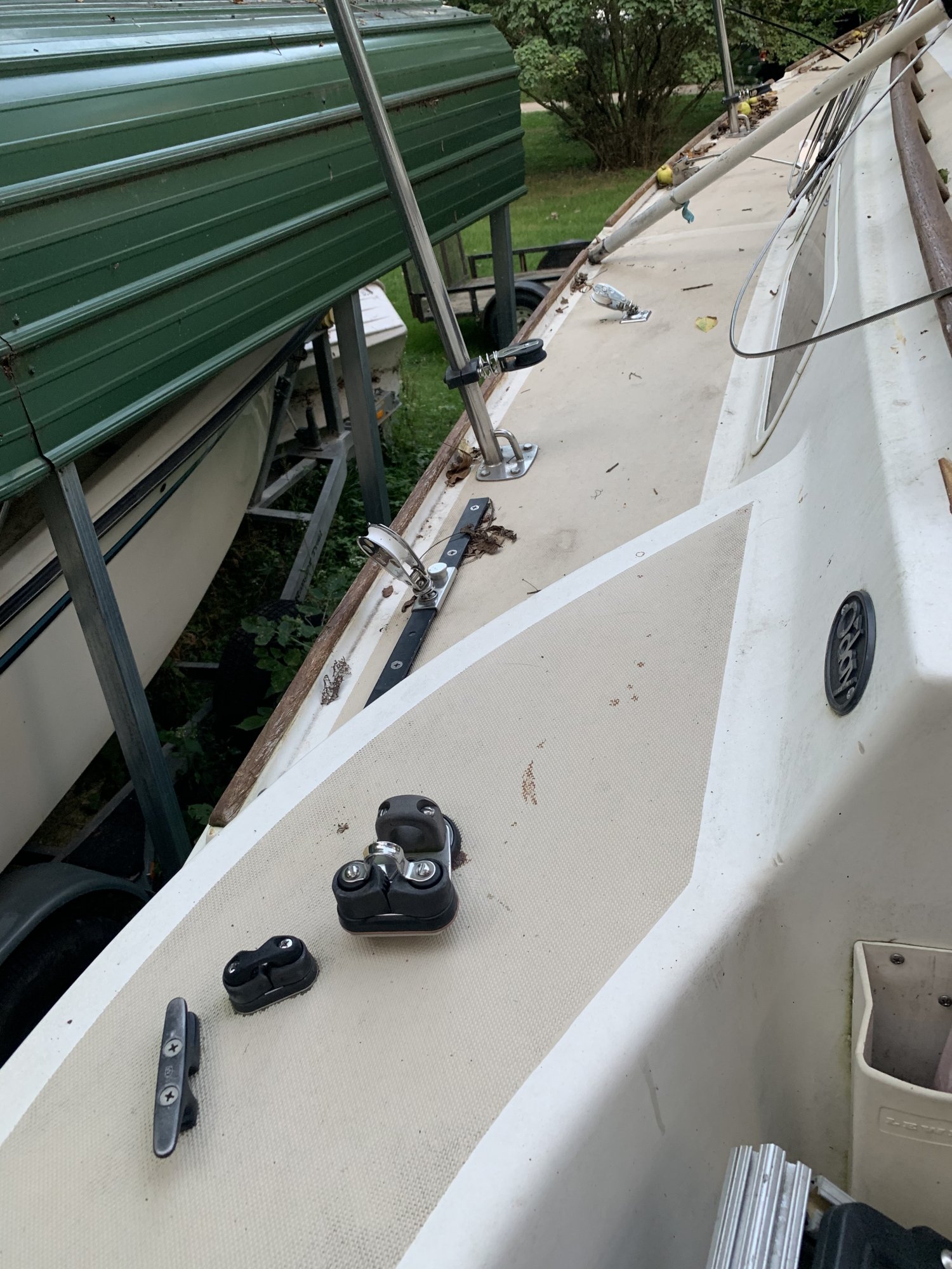

Hope this helps . The jib sheets go outside the lifelines . I also had to reconfigure the furling line from how it came. The angle out from the drum is critical. I use 30' of 1/4" line to furl. Any smaller and it is hard on the hands . Any larger and the drum gets full before I'm done ..
From the jib car the jib sheet runs through a pivoting cleat with a built in fairlead . This is mounted a few inches forward of the winch. I'll post a photo when I get home .
If I'm out sailing by myself ,I'll often take the working jib sheet around the working winch and then across the cockpit to the other side around the winch and then to the cleat. this makes tacking so much easier

This horn cleat is driving me nuts! I plan on installing a fairlead and camcleat. I'd love to see the placement of yours

For a jib sheet/standard winch configuration the line should go from the sail through the lead block to the winch and finally to a cleat. If you have the "horn" cleat behind the winch it is most likely a "jam" cleat... which means that one of the horns is configured so you can "pinch" the sheet to hold it secure....then a quick half hitch on the opposing horn to lock it. Standard winches are "non self-tailing" and you must put some pressure on the "tail" of the sheet to get the friction on the drum for the winch to work. Remember that the winches can be operated like a ratchet.... rather than turning full circle.... it is a lot easier to use the ratchet technique when operating the winch single handed. You need two hands.... so a lock on the tiller will help... one hand on the handle, the other tailing the sheet... ratchet and pull... with the cleat right behind the winch, NOT in front, you can easily slip the secure the sheet....
If I may, I will take exception to a previous comment from a poster who said his jib sheet ran through a swivel camcleat/fairlead before the winch..... I highly recommend you do not set up this way. Unlike the halyards, where a cleat before the winch is desired so you can use it for multiple lines ..... you do not want any thing to foul the headsail sheet when you release it for trimming, tacking or gybing..... If you are not going to use winches …. you can go ahead with the swivel cleat/captive fairlead set up... it's very common on small boats without winches. But when using sheet winches, which get way, way more activity than the halyard winch, you'll want the lines to run free when maneuvering.

My mistake ! The swiveling cam cleat is for the furling line not the jib sheet . After rereading what I posted ,it appears I slipped a gear. I apologize for the confusion . The jib sheet comes back from the jib car alongside the ports to the winch and then forward to the cleat .https://www.google.com/aclk?sa=l&ai=DChcSEwjz2IDUk6PkAhUBr8gKHWo5BnwYABAFGgJxdQ&sig=AOD64_3wq6kjmmotaCEGJ-3GjFkyV8j3kQ&ctype=5&rct=j&q=&ved=0ahUKEwjqofzTk6PkAhVohuAKHQngBmwQvhcISw&adurl=

where's the sheet winch? what is the cam cleat for? the jam cleat works by wrapping the line around the rear horn and jamming under the forward horn.

  • The cleat is most definitely a jam cleat. Using it as such has made things a whole lot easier! Thanks @Joe
  • I adjusted the angle of the furling line and it made a world of difference! Thanks @Timm R Oday25
