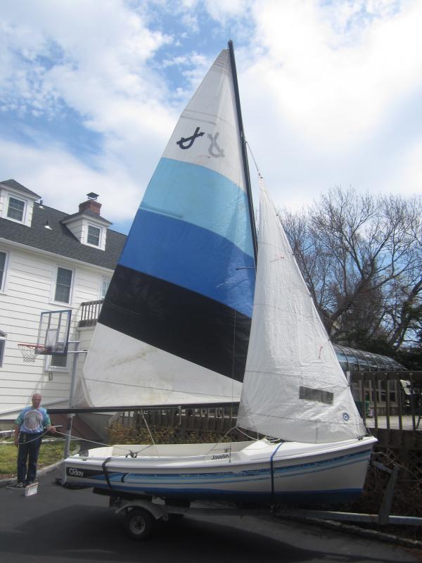

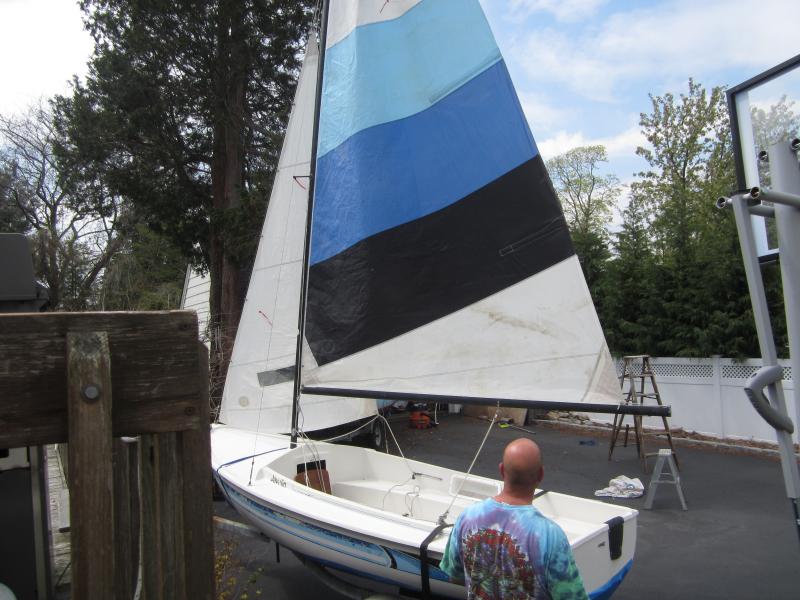

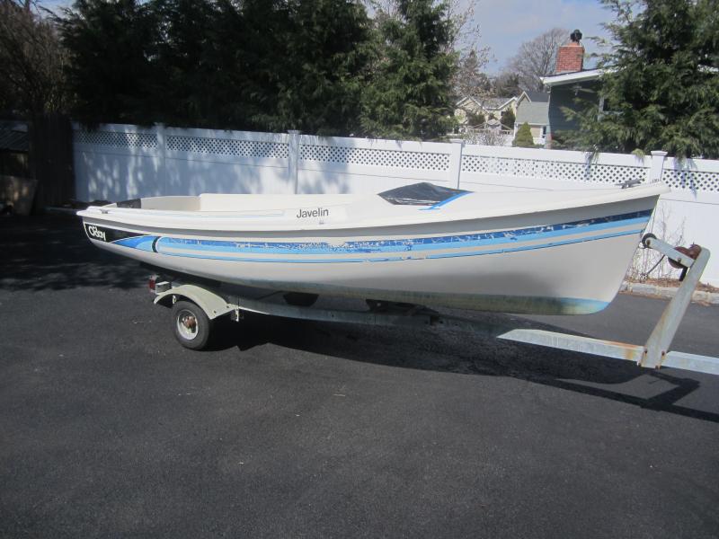

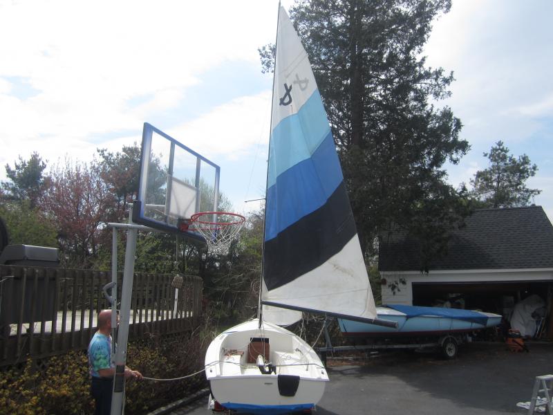

So I am prepping our newest member of the fleet for me and my junior sailors. Bought a Javelin with a trailer for $600 and want to put it in first. My Flying Scot is sad. Some stuff needed to be done.
2 big things that is needed - a cabin hatch and an ice box cover. The teak veneer over marine ply hatch door is $49 so I will pick it up, but the ice box cover is $179 so I will fashion one myself.
I washed the boat down and used MaryKate acid wash GEL on the hull and actually entire boat. The second application really got all the dirt and rust stains off the hull. Then I polished the whole boat with West Marine Pure Oceans Fiberglass Cleaner Wax. Next I dropped the centerboard ant is was all rusty. A friend and expert on all things necessary in life suggested a rustoleum spray that bonds or chemically reacts to rust and forms a primer base. I then painted on Brownish red anti fouling paint. Next I did a little epoxy work where the boat had hit things up front around the bottom paint line. You could see the light through these spots looking into the 'cabin' so i figured I better thicken up those areas. The black mast and boom were dirty and beat up, but I didn't want to paint them so I wiped them down with WD40. The boats side decal are beaten up so we are not going to to win any dog shows anyway!
The sails are the old black, blue, light blue, and white ones. They have surface dirt and a few rust spots. I figure I will soap them up on the lawn and they should be good to go. The boom has the jam cleat half way down but no hardware at the end of the boom so I will have to add a pulley there. I will also add a topping lift and fashion a boom crutch.

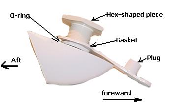

I am pretty excited about the self bailing ability but at 225 pounds I am wondering if it will back up into the boat when I step aft if I don't get the plug in first thing.
I love small boats. Besides 2 Flying scots i also have a Bolger Bobcat, a wooden 13 ft catboat, a sunfish and a 1959 Fiberglass Cape Cod Bullseye I hope to resurrect when I can get my hands on a mast and boom.
Let me know if you have any ideas or suggestions or there is something I have missed or should be thinking about. I do have 2 observation ports on each side of the centerbaord near its pin. I noticed I have loose stirofoam planks underneath the deck. I wonder if that is normal or if they fell down from further up underneath the seats?
Anyway happy sailing. Looking forward to another great season of sailing across the Great South bay on the South shore of Long Island and getting over to the flats for some clamming and swimming among the uninhabited islands. If anyone wanted to read a good book on sailing in the area in the early 1900's try reading Blue Sloop at Dawn (try ebay) about a boy and his Timberpoint sailboat. Some are still around out here today and they are just beautiful!
