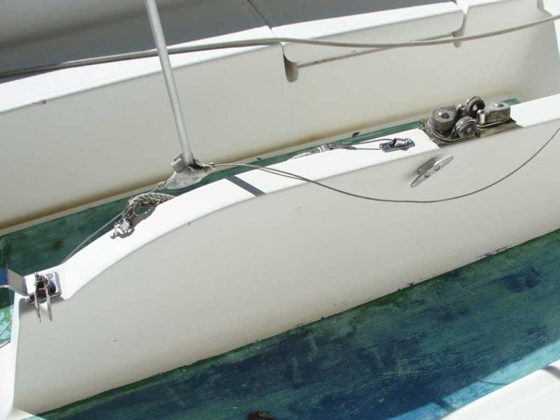

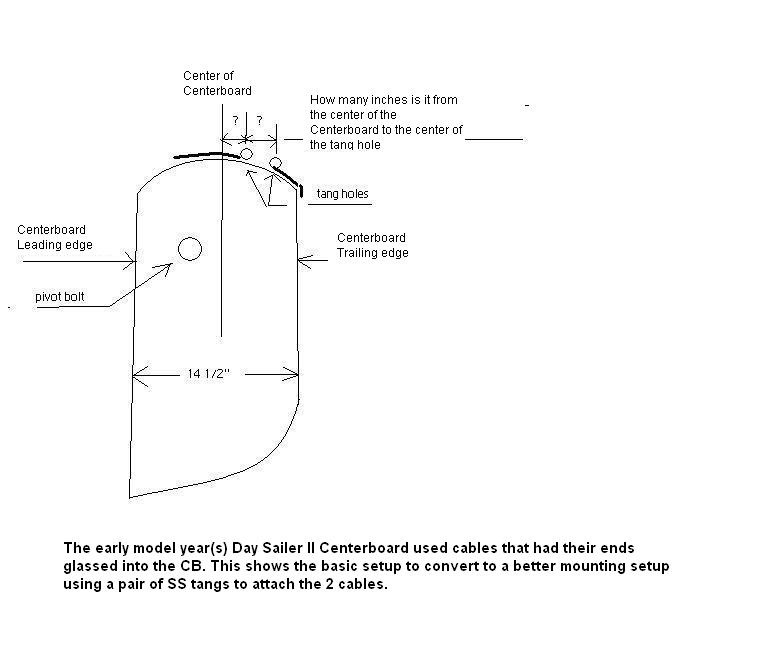

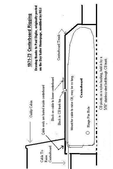

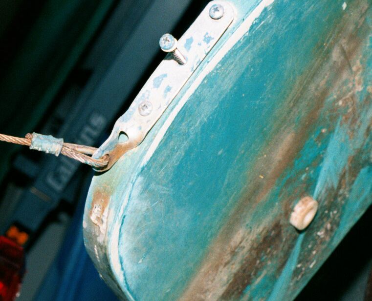

Is your DS II a 1971-73 model? Id this the up-cable or the down-cable? I have heard of problems on these boats where the cable that pulls the CB down slips down between hte CB and the inside of the trunk, one cure is to add a piece of Stainless-steel (or bronze) sail track to the forward edge (top edge when CB is down) of hte Cb for the cable to rest in. I wonder if the block that the cable keeps slipping off is a replacement, since hte original would seem to have no room for the cable to slip off of the sheave.

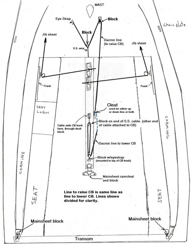

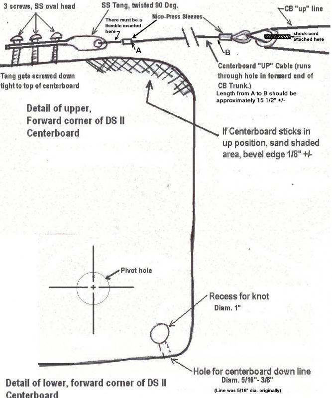

I'll include a few drawings from my Owners Manual of these 1971-73 CB setups and pictures of a few DS IIs of that vintage.
I don't have a drawing to show that sailtrack idea..... I'll need to make another drawing to show that, idea came from Robbie Pierce, a former VP at O'DAY.

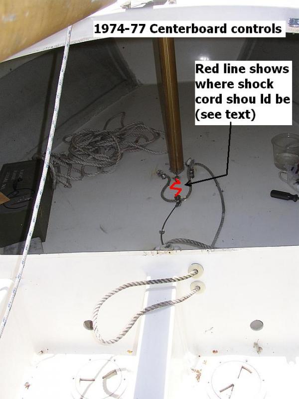

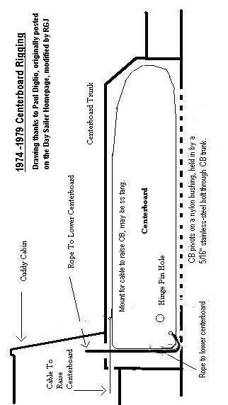

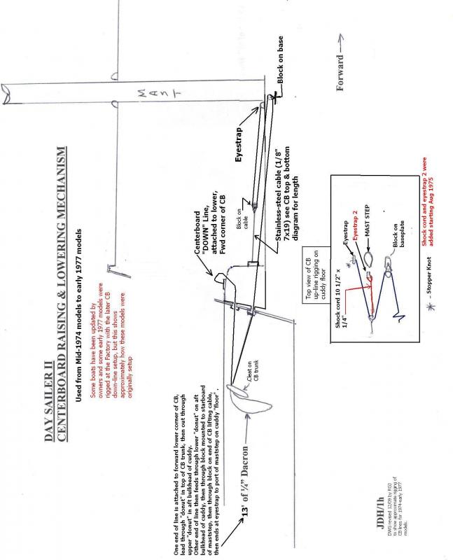

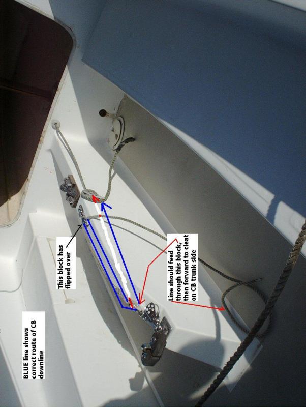

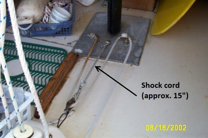

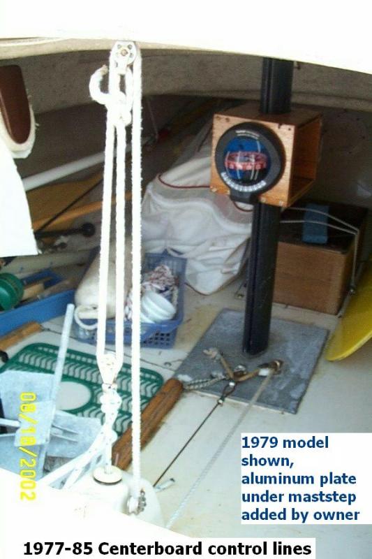

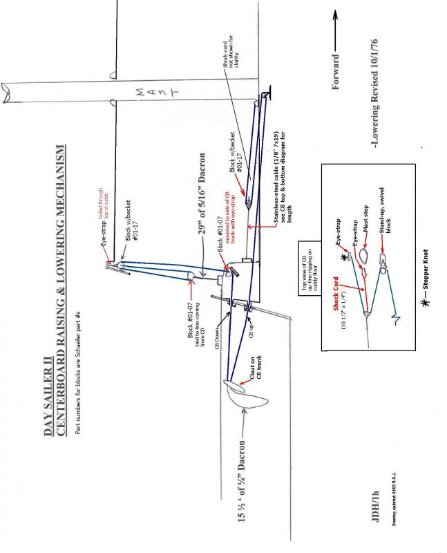

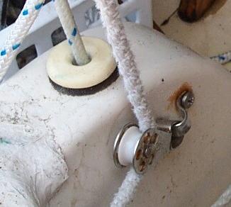

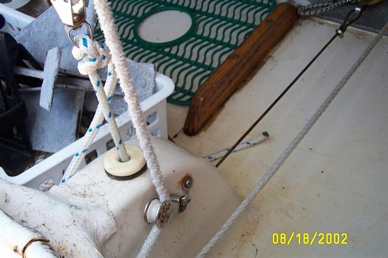

OK, well maybe your boat is a newer model? CB setup was changed in 1974 to move the down line to the top of the forward end of the CB trunk and the cable was replaced by line. The setup was again changed in the 1977 models (oct 1976) to add a block (pulley) at the top of the cuddy opening for the down line to run through. See below pics/diagrams. On these newer boats I don't think the sail track is needed since the rope is too large to slip between the CB and trunk side. OH and in around 1975 O'DAY added a short length of shock cord (bungee cord) to the setup to keep some tension on the up cable to prevent it from getting stuck.
One of these 2 setups should match your boat. However, there is no block (pulley) used inside the CB trunk on thse boats, or even where the line comes out of the CB trunk (factory setup). So the block may have been added by a previous owner.
HOWEVER, it is POSSIBLE that your boat IS factory stock, but was built after the CB down line was moved forward, but before the switch to rope instead of cable. I found out about the 1974-76 version from a fellow DS II owner who told me that his CB rigging did not match my drawings (Rudy at D&R didn't even know about that one!) O'DAY tended to "phase in" changes, so your boat may not match my drawings even if "Factory original".
If it doesn't match your boat, could you please send pictures? I want to add it to my Expanded Manual (and let Rudy at D&R know too!) THANKS!

The Day Sailer II needs to have constant tension on the CB cables to avoid them slipping between the CB and the side of the trunk. All later-model DS II's have a length of shock cord on the uphaul that keeps the slack out of that cable when the board is down. I agree with Sunbird that there is something amiss with your downhaul cable, as it rarely jams. The original through-deck fitting would hold the cable on the pulley, and the cable is always being lifted away from the board.
I'll make another guess--I suspect that the tang (the metal strap that fastens the cable to the board) has become twisted, so the cable is no longer centered in the trunk. On the older DS II's the two cables (uphaul/downhaul) cross inside the trunk, with minimal clearance. One tang is mounted slightly to starboard, the other slightly to port. Any bending of the straps might cause a foul. The definitive cure is to drop the board, find out what's going on, and fix it.
