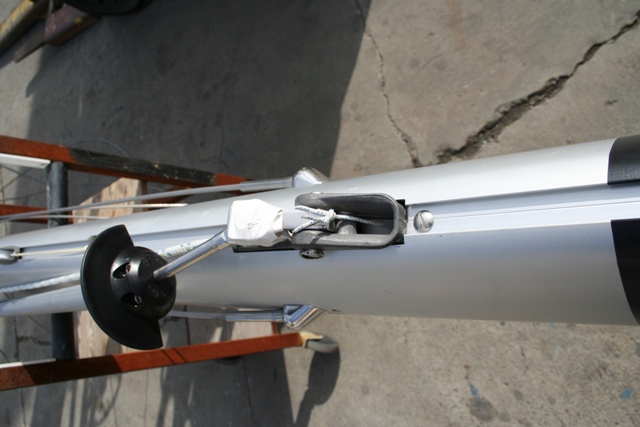

One big issue on the way down was the plate at the top of the mast from which the spinnaker halyard exits. You'll see from the attached picture that after a 10 hour session with the kite up, the halyard chafed the plate and eventually parted altogether. We did manage to run a new line up there but the halyard parted again quickly because of the jagged edge now present.
The design doesn't seem to be optimal because of the exit angle of the halyard. It's naturally going to chafe pretty hard on a long run with the sail pumping.
Has anybody seen / experienced seen this before? Does Beneteau recommend any solution?
