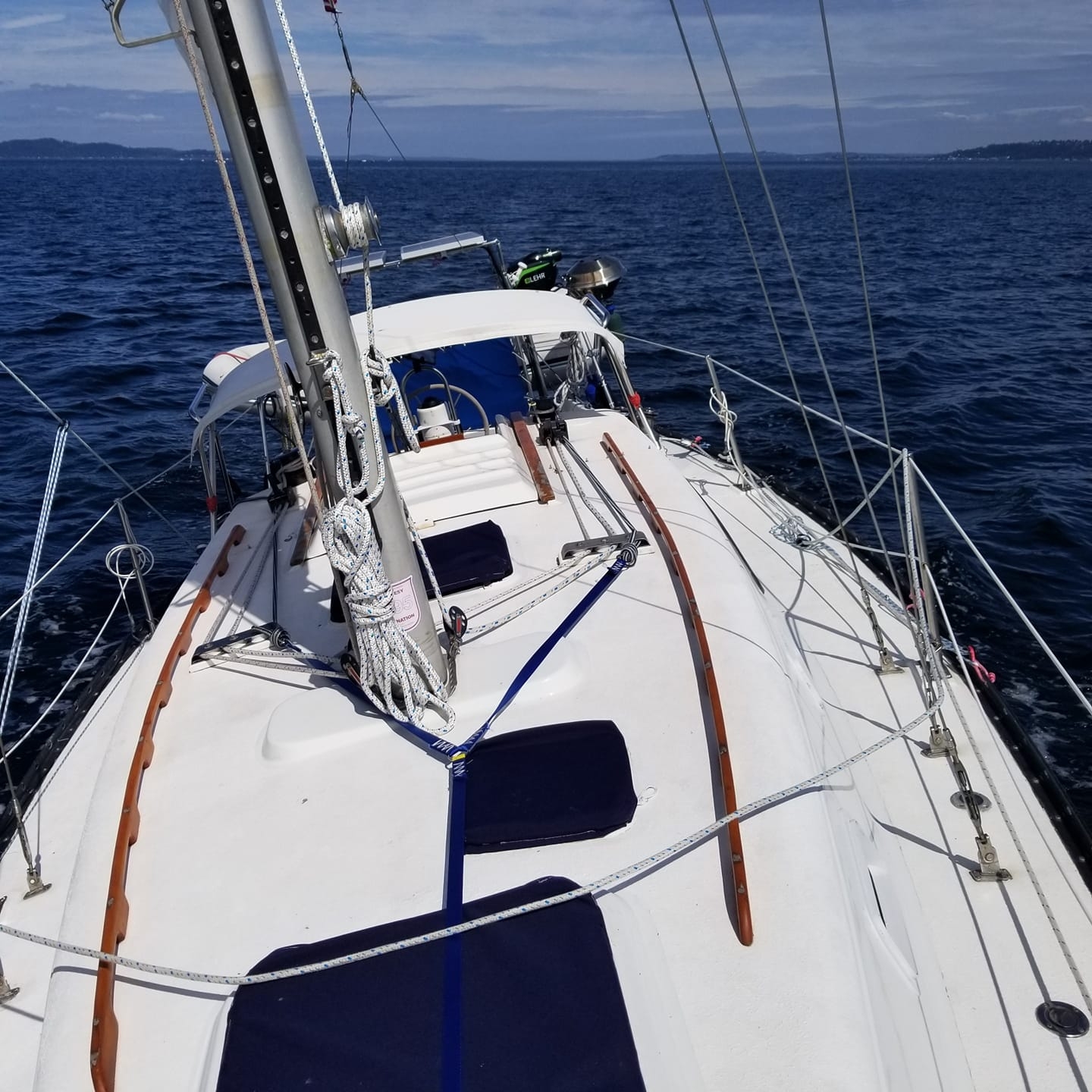

I single hand sail a lot and built my own with the desire to keep me on the boat. I built a "Y" assembly with bottom of the Y going to the bow and the split taking place at the front of the mast and the two legs running on the top of the cabin, through open deck organizer rollers and into two extra clutches on the cabin, under the dodger. After a bit I did install in in-deck anchor point just forward of were the cabin rises and run the jackline through a soft shackle to keep it centered and lower. It wasn't too difficult because to just set up my Sailrite machine in the salon and built it right there. I also built retracting lines for my Spinlock harness/lifejacket (same one in my picture) using hollow webbing and shockline with stainless snap hooks.
Doesn't take too long to set up, probable 10 minutes.
Found a picture of them. I think this before I installed the in-deck anchor point and definitely not centered like I have them now with the bifurcation right at the base of the mast.
Hi Mike! seems to be a nice installation. I'll see what can I learn and adopt from this one.
